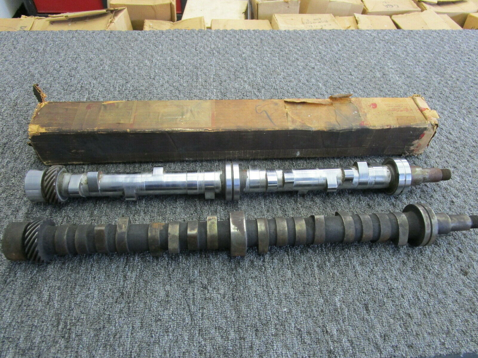

    Anybody out there who has experience with grinded cam for the 346 engine?
    Any years back I find a NOS and the box look like original from the 50th.
    She came from Clay Smith California.
    The Cam has 260 Grind.
    Instead of original cam, what makes 260 grind with the engine?
    I have a 2 carb setup, open headers and Cyclone Heads on engine.

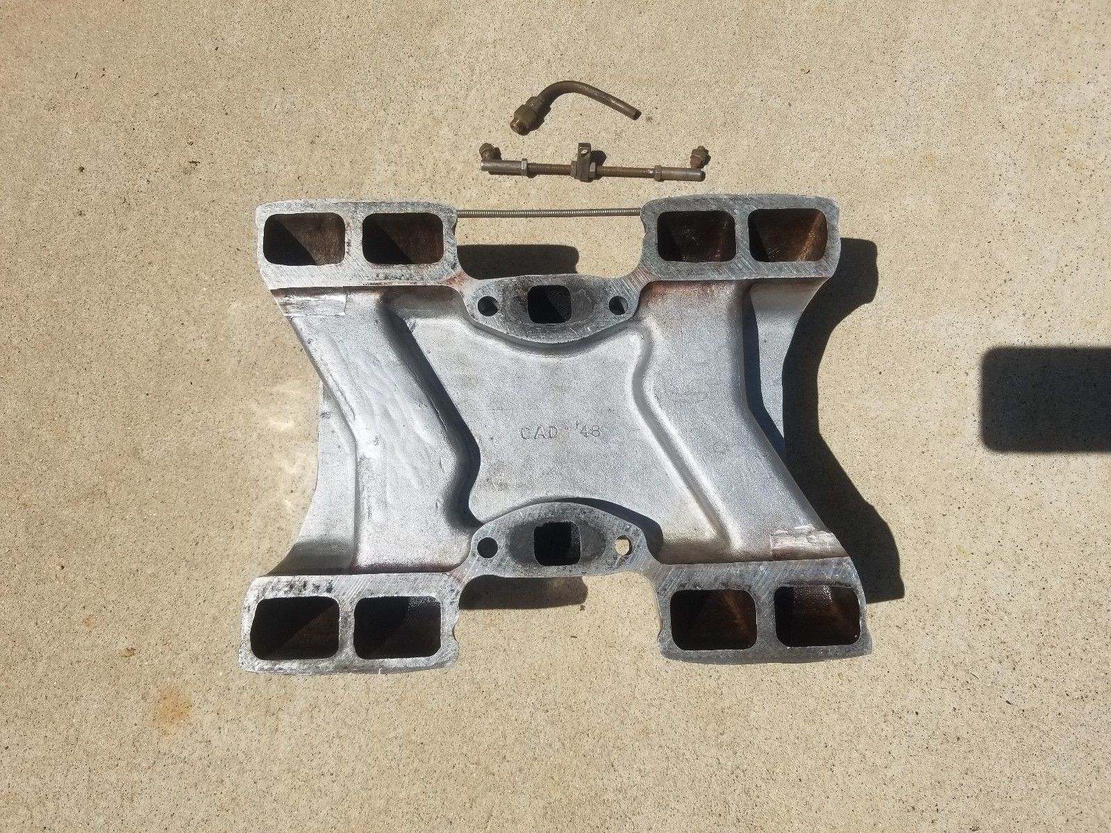

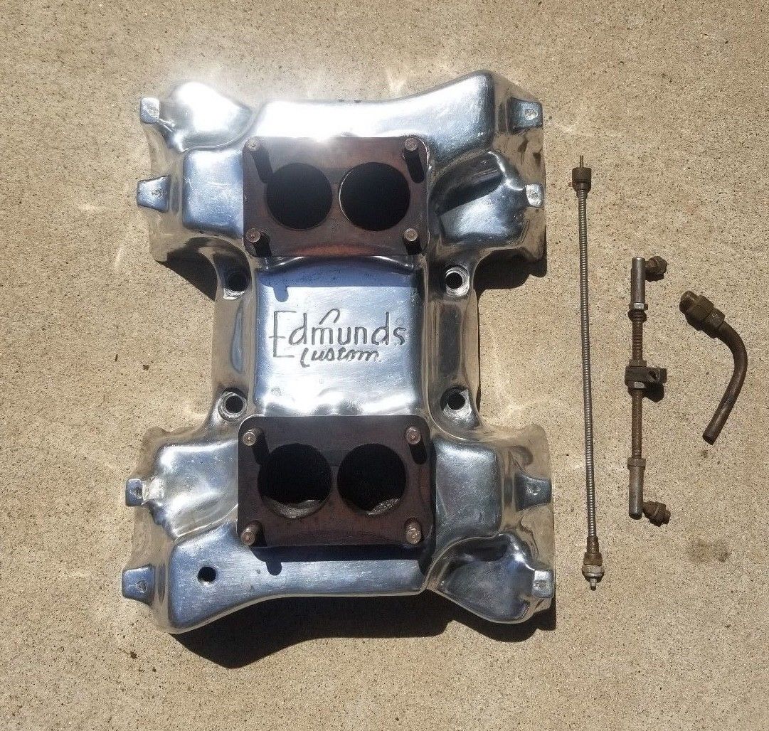

    The carbs are 2 x Carter WCD 581s. Both are NOS from the military cadillac engine.
    The 581s are with bigger main jets and without lot of lever and arms.
    I have the Edmunds intake and also the Burell intake.
    What do you think brings the better performence in horespower and torque?

    North, I'm only guessing but I'd say both manifolds would be pretty close to each other.
    I'd the Burrell maybe a touch better but that is just a gut feeling and because I own one.
    From what I know Burrell made these intake manifolds for the US tanks and I'm guessing maybe a little more science went into them.
    With the Edmunds, I dont know how they came about.
    Both are stylish and look the business.
    Others out there may have something to contribute regadring intake manifolds...

    Thank you Russ for your ***essment. Deep in my mind my hope was similar and you confirm.
    My ***umption is also that the Burrell has any more science in development, because it is made from Cadillac engineer Frank Burrell. I will test this intake in the race season what begins on May here.
    Best time in 2022 with actually setup on 1/8 mile was 9.4s
    Dirk.

    One more camshaft question.
    Is there any difference on cam between a civil car 346 FlatCad and the 346 military version used in Stuart Tanks?

    UPDATE!
    The 260 grind NOS Clay Smith cam is installed and also the Burrell intake instead the Edmunds intake.
    Last week I was on Dynapack testing station.
    Setup brings +34 horsepower and +85 torque.
    The engine runs perfect with the both carter WCD581s carbs.
    I am very happy with this result!

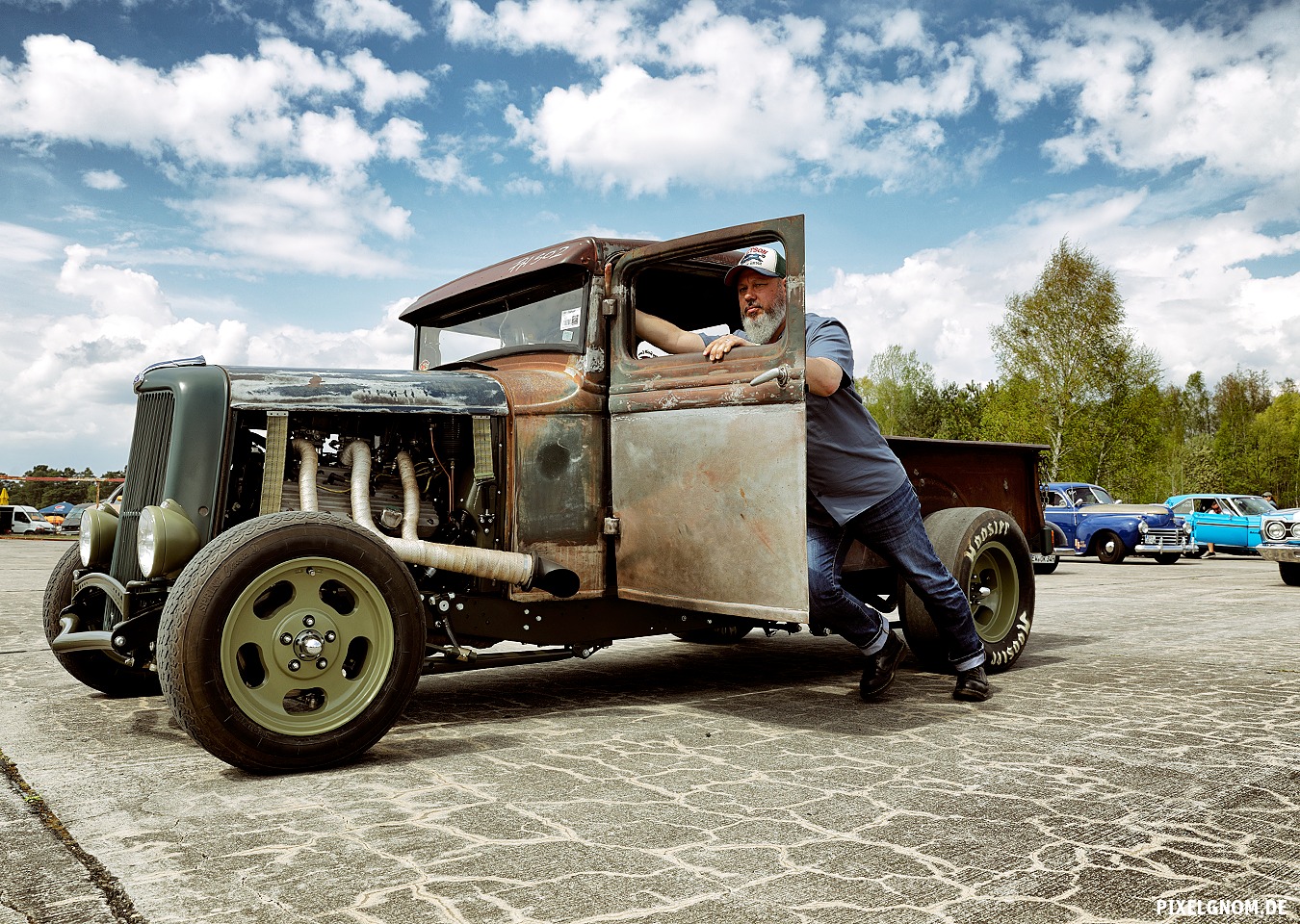

    Right, the engine is a stock 42` with complete overhaul. Bore is third version, sorry do not know how to say it right.
    No porting or so is done, but cyclone heads fom Kevin. Electrical fuel pump installed, Pertronix ignition, self made open headers, 55` Chevy rear axle and 3 speed caddy stick shift.
    The car is a 34` Ford Pickup Truck.

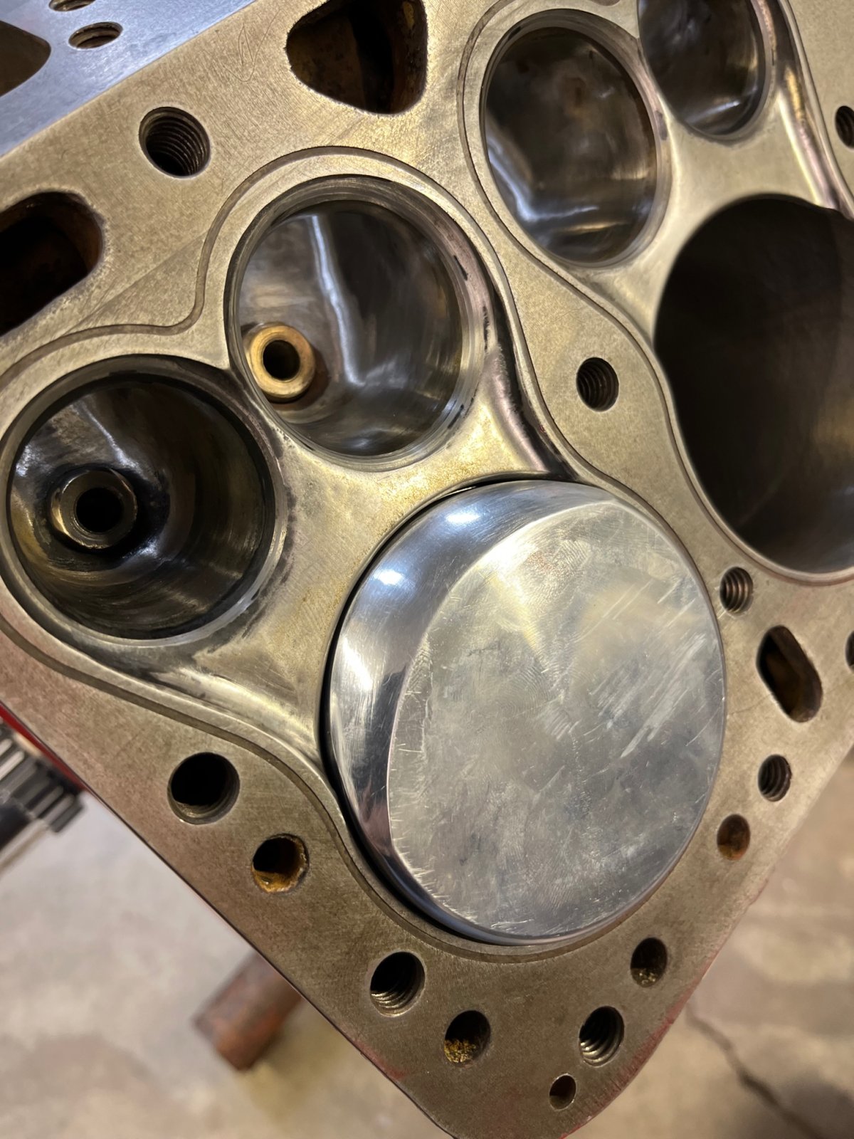

  20. I've been back at it with the FlatCAD Racing engine rebuild. It has been in a slumber for about 6 years - about time to get it ready to rock again. It took ages to get the custom pistons - they fubared them the first time, had to wait for the second set. Here is the block (after redoing the porting):
  21. Here is some port work . . . . I figure between the original porting and the "redo" here, probably have over 300 hours in it:
  22. Here are a couple more block pics:

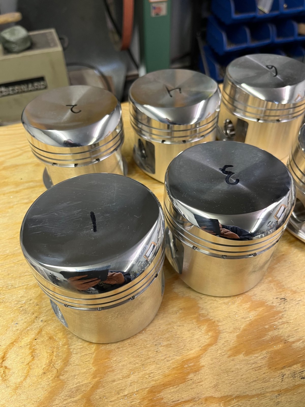

  23. Here are the new pistons - custom made by Diamond - from my SolidWorks designs:

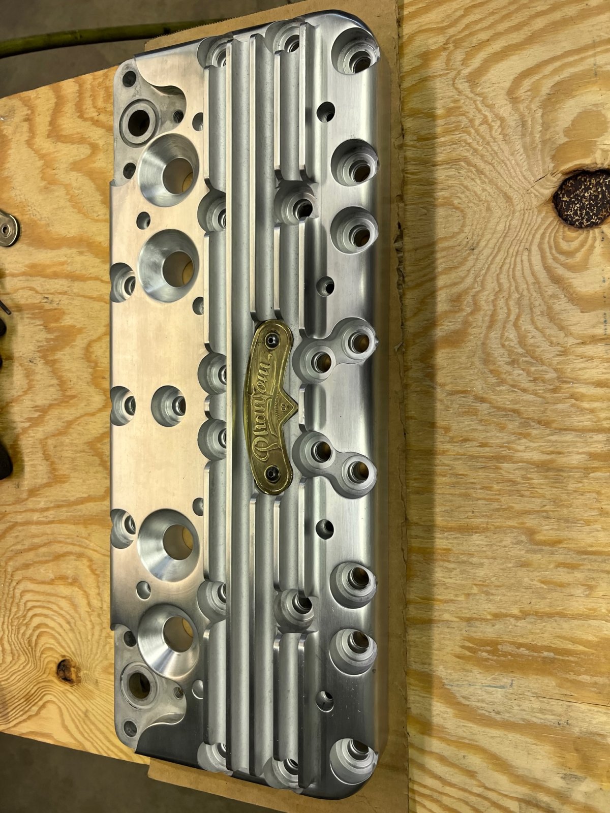

  25. Cleaned up the cylinder heads and resealed the clamshell areas:
  26. Hemi Joel likes this.
