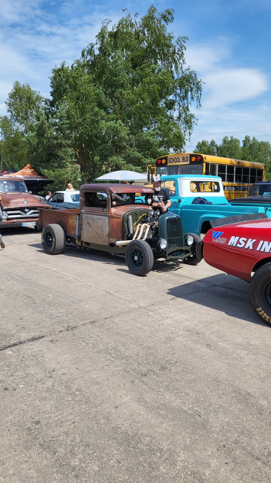

    Hey wrenchbender, happy to see one more FlatCad in a dragster race!
    Congratulations for the 8.501 and first place!!
    2 weeks ago I race 9.732 at 1/8 mile, but engine runs not optimal. Lot of issues with carb or ignition.
    At last I find out that sparkplugs misfire. I make all sparkplugs new in spring and they work fine on dyna testing.
    On any time one or two begin to misfire, but I do not realize that sparkplugs can make bad engine run, because they where new. After I take my old sparkplugs -> the engine runs most better.
    I think the Champion J12YC are no longer good for my performance engine with 260 grind cam, 2 carb Burrell intake and Pertronix ignition.
    Which sparkplugs are you using? Is the Champion H10 better?
