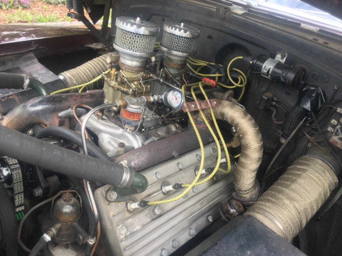

  4. NorthManCad
    Joined: Sep 9, 2018
    Posts: 70
    NorthManCad
    Thanks for this tip!
    I have pertronix ignition in distributor and the FlameThrower HV coil you see in picture.
    What should I do more or better with the ignition system?
    Any experience with pertronix in distributor?? They fail often?
    I will check all wire lines for ignition, batterie and alternator too...

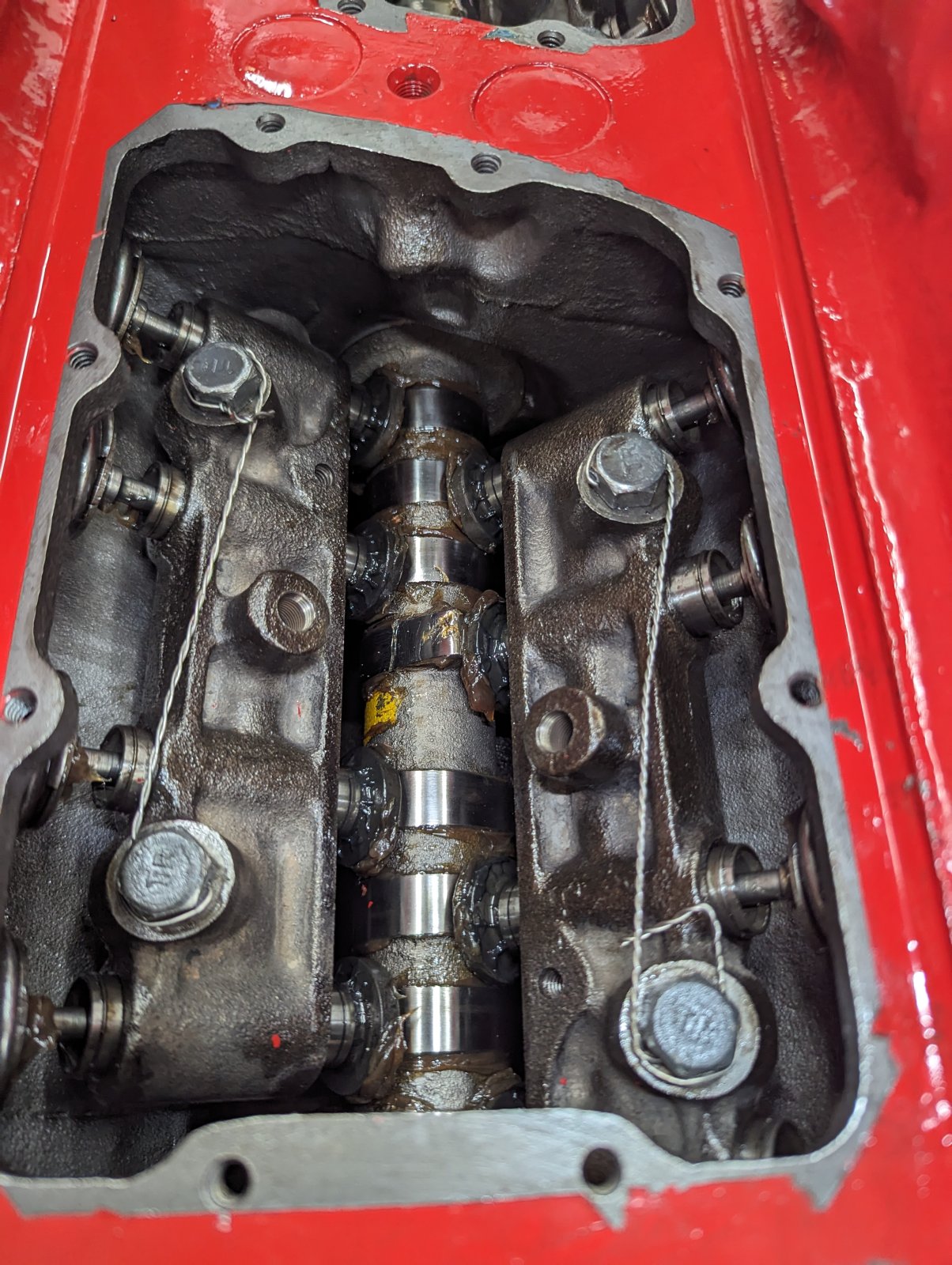

  5. orbitup
    Joined: Nov 3, 2021
    Posts: 33
    orbitup
    from TEXAS!
    Painted and mocked up.
    I replaced the metal plates with safety wire.

  12. Hey NorthManCad:
    For some reason I went back and reviewed some of your posts related to the 3/4" reach plugs and copper washers. I noticed the plug you showed is a 'R' plug - which means resistor plug. You do not want to run resistor plugs or resistor wires on these old ignitions - they really reduce the spark energy to the plugs. With lower spark energy, you'll find that it might be harder to start and might not have enough amps to run at higher RPMs. Also, you might overheat your coil.
    I would highly recommend running non-resistor plugs - I previously gave you a part number that should work. Also, a heat range of '6' should work for a naturally aspirated motor.
    Update me when you have a chance!

  14. NorthManCad
    Joined: Sep 9, 2018
    Posts: 70
    NorthManCad
    Hello B&S, Hello 346th Guys!!
    I am very glad that you are all back in our forum. Since my last post in November, I had been checking every 3-4 weeks to see if there was any movement. Yesterday I was very happy to see you all back.
    B&S I will definitely follow your advice with the spark plug. I may have made a big mistake by going for the highest quality spark plugs. The issue with the high resistance is certainly an important point.
    In the meantime, I have also checked my ignition system again. My ignition coil from Pertronix works with a resistance of 1.5 Ohm, which should be perfect for a V8 engine with Ignitor I in the ignition distributor.
    I also spoke to someone from Pertronix Germany, who may have given me a crucial tip.
    Until now I hadn't taken into account that the vacuum is lower with a racing camshaft. That's why my ignition advance will no longer work properly and the misfiring will occur because the spark plugs don't have an optimum spark and therefore turn black and wet.
    Can you please tell me how I can optimally adjust the ignition on the Caddy Flathead? How much advance ignition?
    Should I remove the vacuum hose and the vacuum can from the ignition distributor and set the ignition timing?
    I appreciate any advice!
    Many thanks NMC

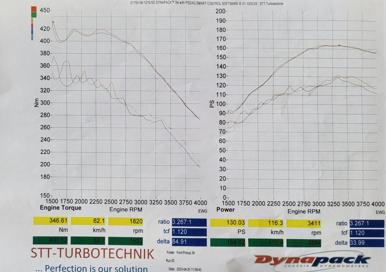

  15. NorthManCad
    Joined: Sep 9, 2018
    Posts: 70
    NorthManCad
    Hello 346Cad, the engine test was on DYNAPACK without wheels on a Role.
    That means you see the HP on engine in my post.
    This is what the man from DYNA tell me...
  16. Question: I've not used the original distributor, but what type of advance mechanisms does it have? Does it have both vacuum and mechanical advance? The vacuum advance would only come into play at idle or off-idle and or when you're under cruise and not under load. If your ignition problem is related to having heavy load on it (misfires), then this probably has nothing to do with vacuum advance. If you want to run a distributor, I'd see if you can retrofit something modern - like a SBC or Ford unit (depending on rotation!). This way you could much more easily tune the advance curve, parts would be readily available, etc..
