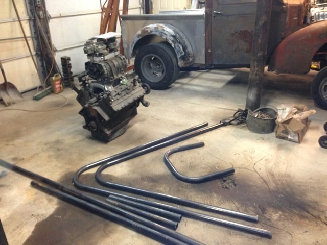

    Thought I would update this thread just a bit I have actually made some progress this weekend and should make some more progress this week many things are in the works it's amazing how many parts a person has to make when your on a budget as tight as I am but when you get all the parts together show able progress happens fast. A couple weeks ago I was able to purchase the tubing to start on the ch***is but wasn't able to get started till now anyhow I have the tubing bent so I can start the ***embly, the 4-71 blower case is being pruned off for the engine after I finally come up with a good one, I have a corvair steering box that was sponsored by none other than the world famous Kerry here on the hamb the front axle and spring is ready the front spindles are almost machined for the 19" wire spoke wheels I was so graciously given by mike at s&s restoration and should be done by the end of the week I have the 8 3/4 Chrysler rear narrowed and ready for install rear end brackets are made and after I get a new chop saw wheel tomorrow I will have most of the tubing cut then the fun begins so stay tuned as progress is starting to happen here is sneak peek of some of the parts

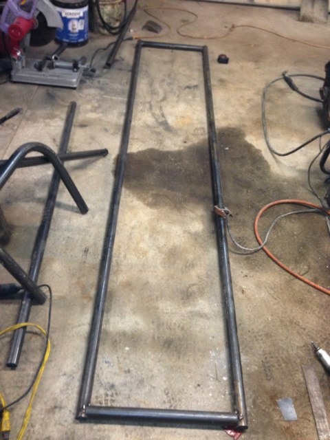

    It has begun ch***is work is happening been busy the last few days bending tubing and tacking the ch***is together here are a few pics of progress so far still have a long ways to go but so far everything is measuring out good and square more to come so stay tuned

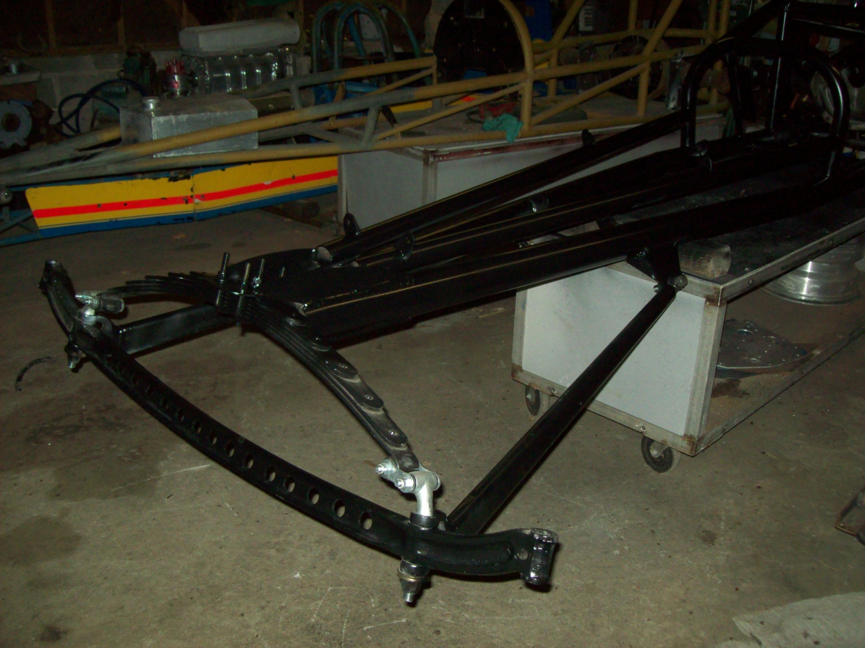

    Well I have a 40 ford front axle and transverse spring and a real nice set of split wishbones and have a set of 19" wire wheels that I have adapted to the early ford spindles I wish I could afford a new chrome front end but that's not really in the budget right now any thoughts? What kind of caster angle do you think it needs? I'm always up for ideas

    I'm running 23 deg on mine and with a 130 wb I really like it. It had over 40 origionally and I didn't like the "flopper" front end, now it turns great and is real stable......
