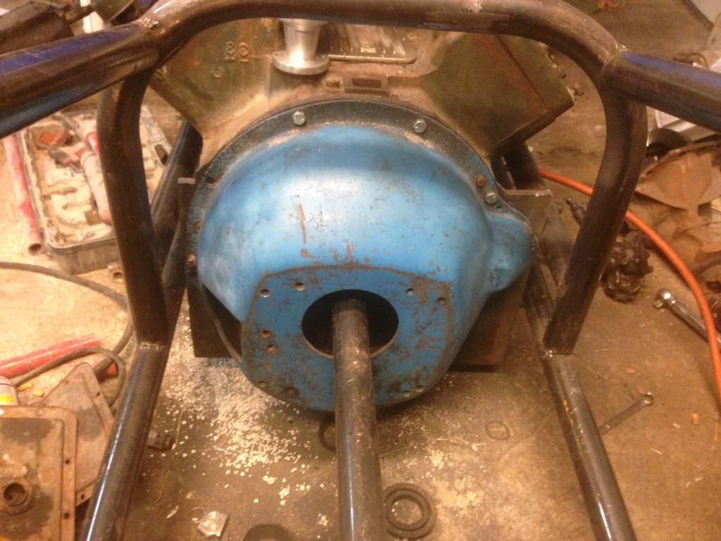

    Well folks I finally was able to make some showable progress today after making lots of brackets and an engine adapter plate and blower drive parts it was time for some assembly stay tuned as progress will be happening a little more quickly since the weather finally decided to be nice here is some pics

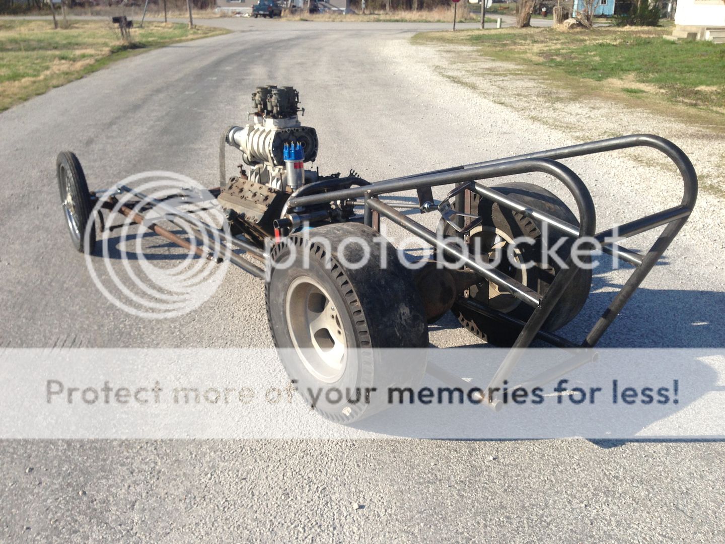

    Made some progress this week on the digger it now has some fresh front tires steering is hooked up and working also installed Trans and clutch also got motor mounts made I'm still having a hard time mounting it down with hose clamps but guess that's the way it's done anyways here is some pics as I was able to get it outside for the first time this year

    Looks good Randy, BTW what's that green stuff on the ground:confused:, Were still wakeing up to this white stuff once a week:(,, Tim Jones

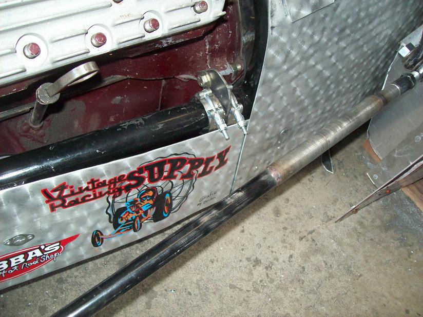

    Explain hose clamp engine mounts in depth, please. (Ivo used them on his Hemi rail)

    Mike here's a closeup of my rear mount the front is a welded tab on the top rail The hose clamp Randy is talking about is called a T- clamp, I don't have mine on yet ,,,I'll shoot some better pics after work tonight,, Tim Jones

    Here's a couple better pics, the front motor mounts tab is welded to the frame, the rear is a saddle type that sits on the frame ,the underside has a saddle welded solid to keep it in place , There will be T-Clamps wrapping around the saddle mount and frame rail on both sides , Tim Jones

    Basically, that type of mount will work fine.
    That one in particular has several bad engineering faults.
