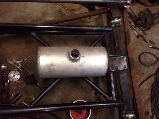

    Made a skosh more progress throttle pedal, clutch pedal, brake handle, master cyl mounted and the front X in the frame for support and fuel tank mount unfortunately a sweet moon or eelco tank and brackets are not in the budget so I'm gonna have to use the hand me down homemade tank in the pic however if anyone has a tank that they would let go at a real deal I would be intrested because that would sure make the digger that much better

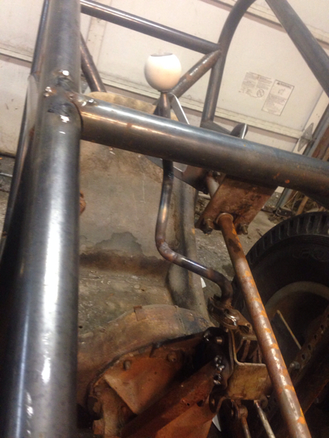

    Been awhile since I have posted an update basically cause I haven't had much time to work on the digger however I have made some progress and things are starting to slow down so I can spend more time on this thing and get it ready to race anyhow I now have a shifter that functions and started on body panels I have 5 panels made but only have two dzues fastened on hopefully lll have the others attached in the next few days things are shaping up and not much setup left to do then the finish work begins you know the progress that shows nothing for awhile then blam it's done anyways here are a few pics

    Coooooolllllll Randy think ya might wanna take a few kinks out of the linkage?

    Go easy shifting with that linkage :eek:

    Actually the pic doesn't show how solid it is it's made out of 1/2" solid barstock and it has to be bent like that for it to work and clear everything I've beat on it real good trying to bend it and it just works also I won't have to shift it much probly won't even have to use first at all probly just a 2-3 shift once I do appreciate the thoughts though I always am open to better ideas

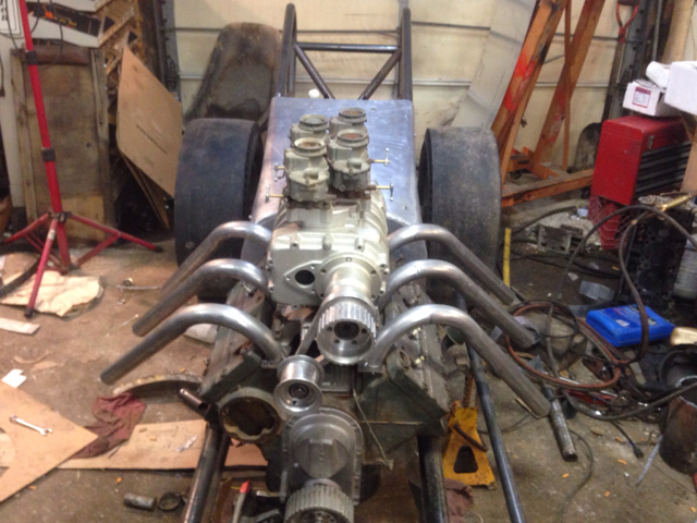

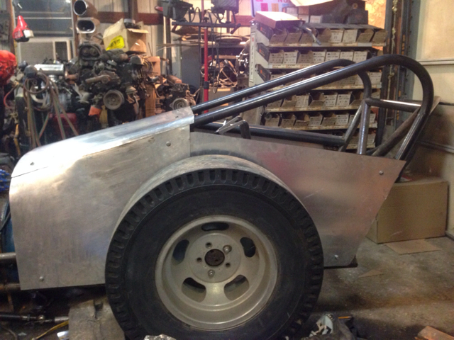

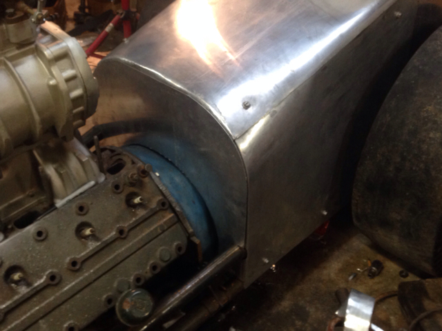

    Anyways more progress has happened I finally got the other body panels fitted I gotta say that top panel was a real sum ***** to make with my primitive tools lol but after countless hours I have got it pretty good first time I have worked with aluminum sheet metal and it is way different than steel definately a learning experience with a little more t******* and m***aging it will be just fine also tacked up the headers I wasn't sure about how the weed burner style would look but I kinda like it not to mention I think it will be safer to tune the engine than a straight up zoomie style
