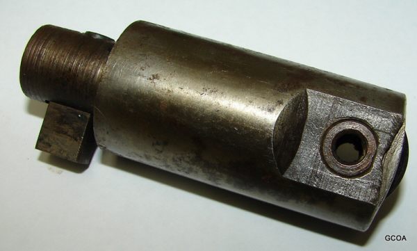

    These are pretty c:cool::cool:l- roller tappets from a 1931 Cadillac v-12. I had no idea that they had roller setups back then!

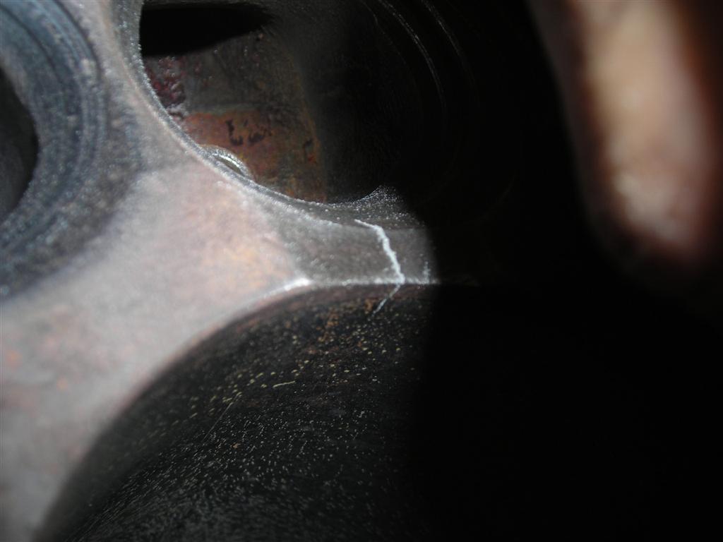

    I have a little setback, as I need to find a new block! The block was boiled and magnafluxed, and shows some small cracks.

    How many cracks are there? 7? Not good. A few could be fixed.
  30. 38FLATTIE
    Joined: Oct 26, 2008
    Posts: 4,349
    38FLATTIE
    from Colorado
    Rich,
    There are 4 cracks between the cylinders. We could sleeve it,and that would fix the cylinders, and still might. I'm going to try and find a good block before I go that route. Not sure how the fix would go on the valve areas.
