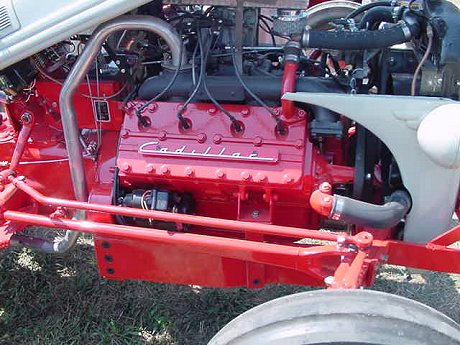

    BTW-I'm looking for a set of flathead 346 tank heads. I'm looking for the ones that say 'Cadillac', if anyone knows of a set.

    I just called a guy about some heads, said he had a bunch. But none with Cadillac on them. I plan on going with Cyclone's but if you happen to find 4 let me know, might be a while till I have enough cash for Kevin's.

    Will do! Wanna borrow the dual plug heads until then? I think for the high HP mill, I'll be better off with steel, as they won't lose as much heat. Heat= hp, and I need every edge I can get!
