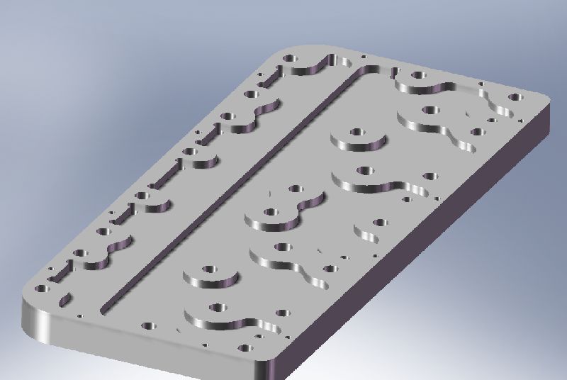

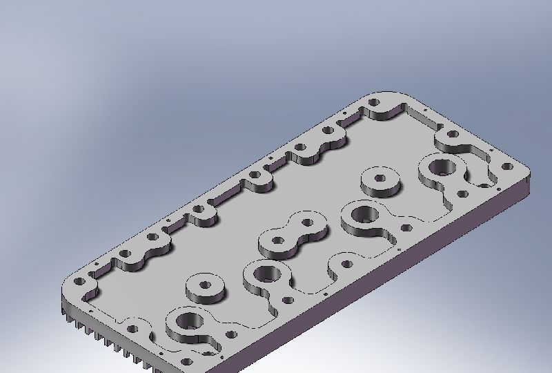

    I posted this on my build thread, but I'll post it here for you Flatcad guys!

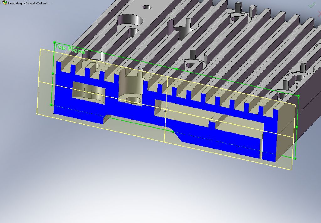

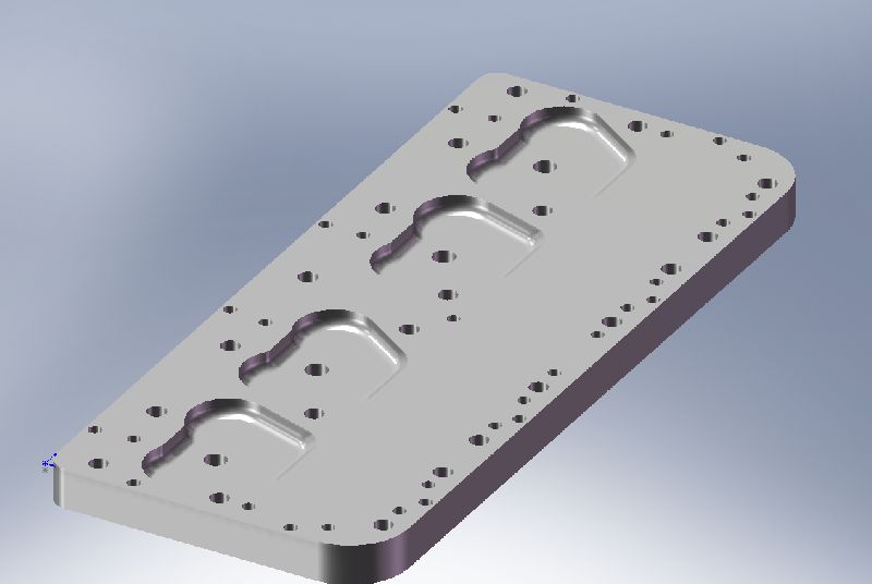

    I spent the day at a CAD modeler/digitizer, and now have improved, high compression, two piece heads in a CAD prigram. I thought it was pretty cool.
    The purpose is so that I can try different chamber designs, to see what flows the best.

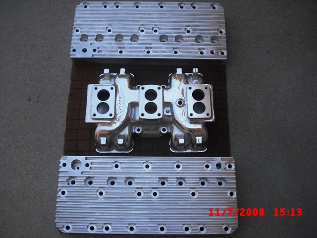

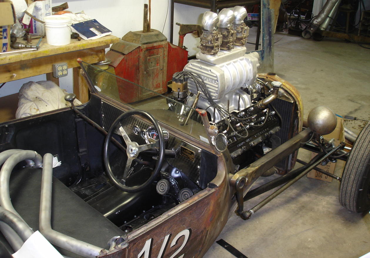

    Here are the script heads that I have.
  18. Bullington
    Joined: Feb 27, 2007
    Posts: 332
    Bullington
    The exhaust manifolds were modified as the engine was in a Cord.

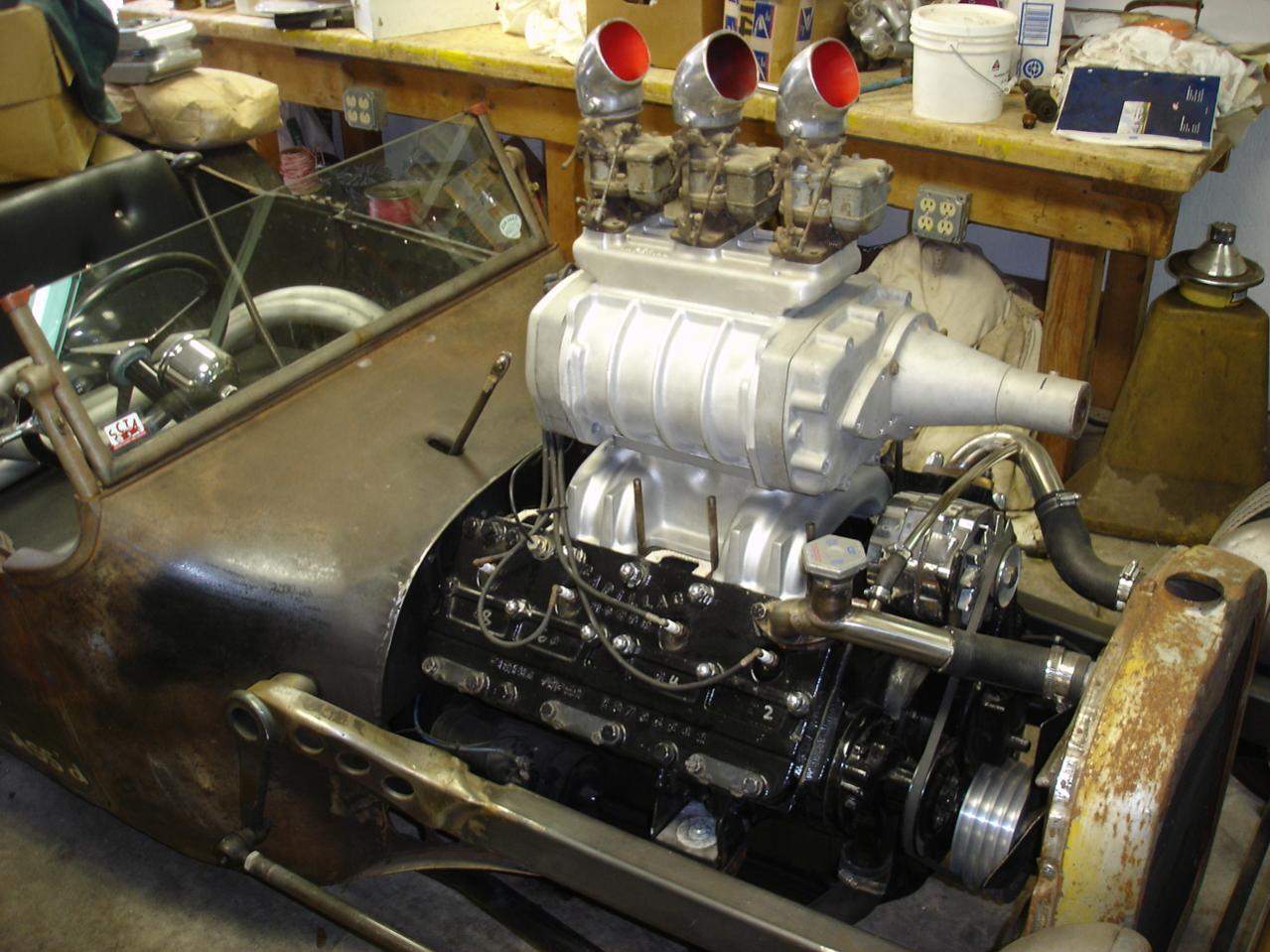

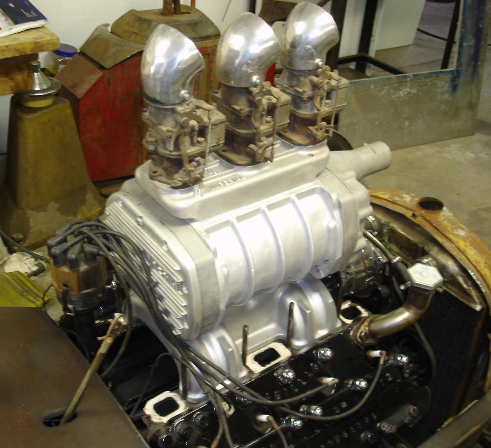

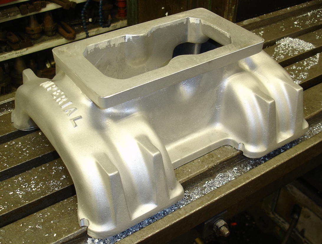

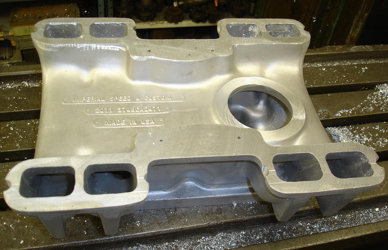

    I know this thread is old, but I had to show these off!

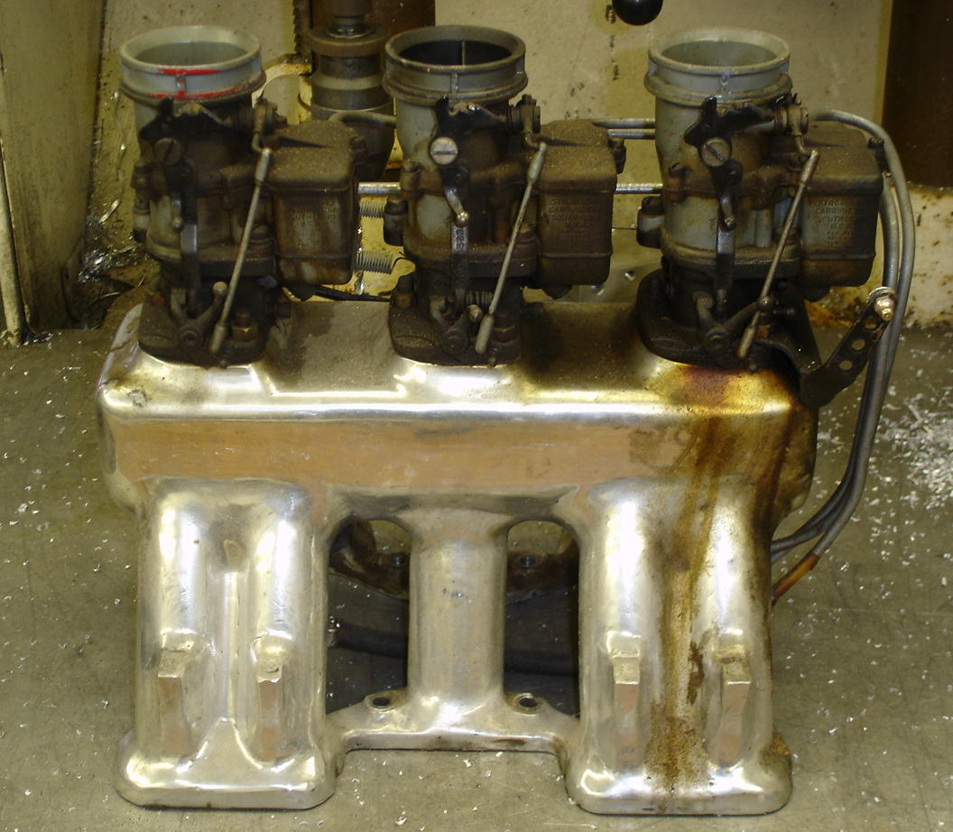

    How about cast 4-71 blower intakes, for the Flatcads? These are soooo cool, and this is the prototype!
    You know you're gonna want one!:D
    I'm not the one making them, but I can get you set up with the guy that is!:cool:

    Sounds like a limited few of these will be available in a couple of months!

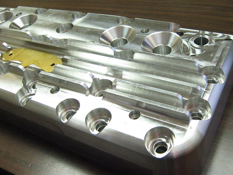

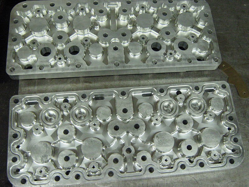

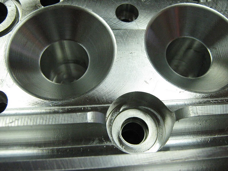

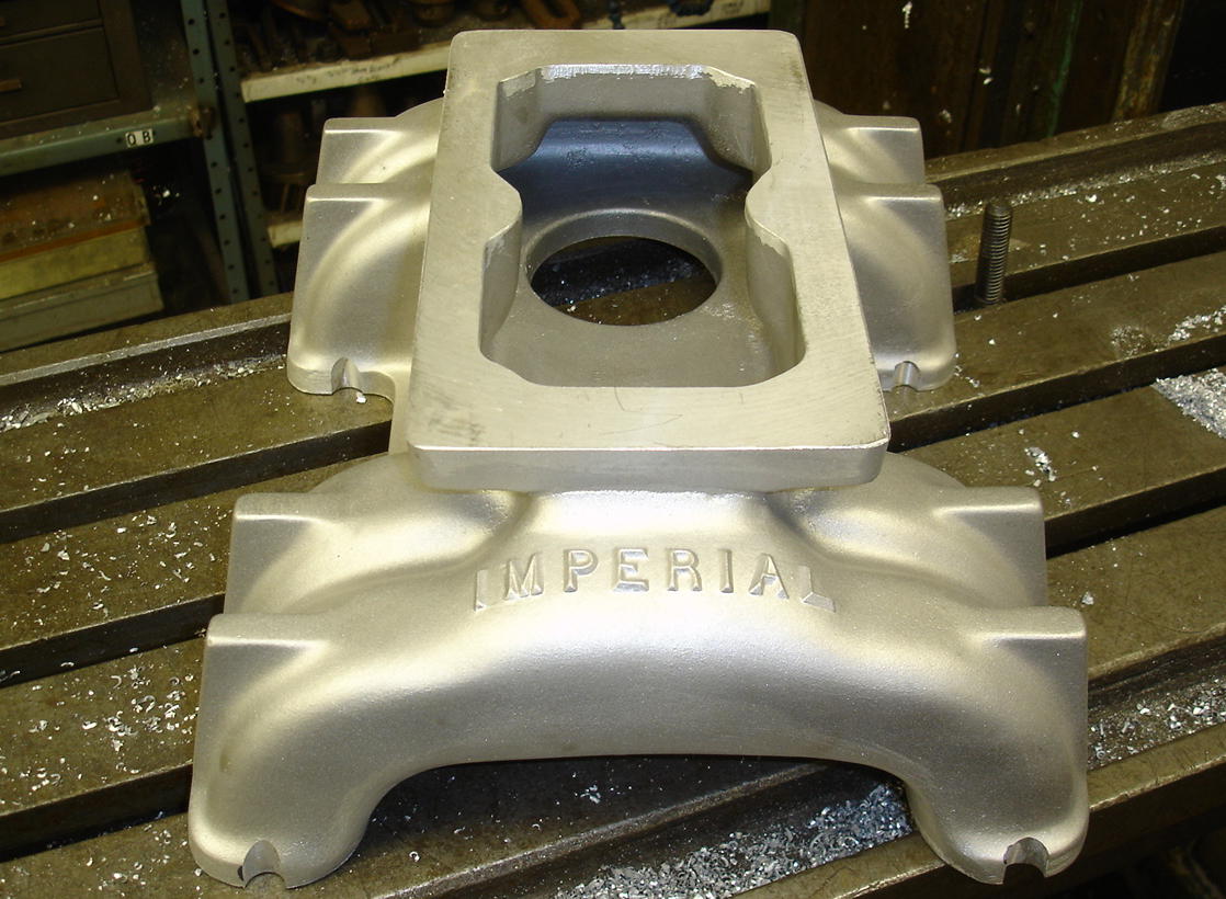

    I thought I'd show you guys the heads that Keeper just finished for the FlatCad. He does amazing work!
    These heads have 7 extra stud bolts, to help handle the blower compression.
    Hank37 likes this.

    Those heads look like Norm Fricks, two part for a Ford Flathead V8..
    Those are a work of art. Nest is how will they perform..
    Looking good Buddy..

    Well, with John's help, I had a set of Norm Frick Caddy Heads!:D
