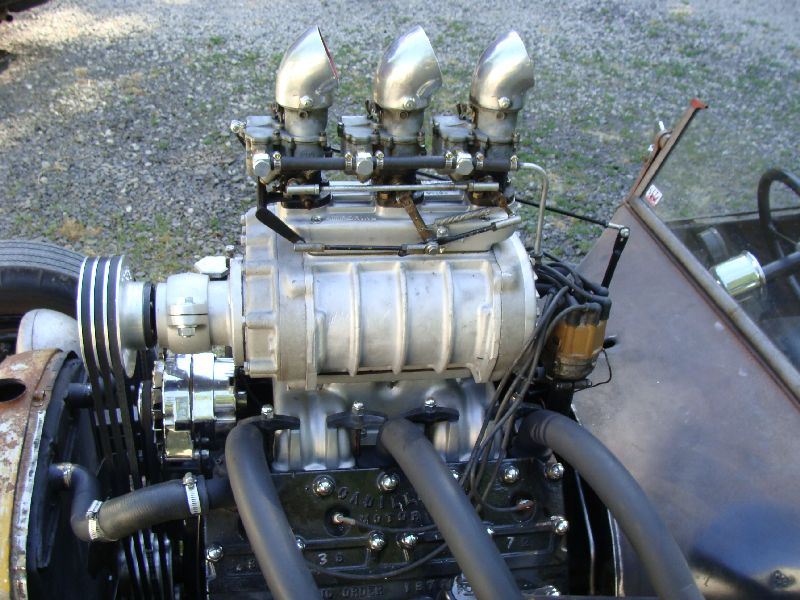

  16. bct
    Joined: Apr 4, 2005
    Posts: 3,177
    bct

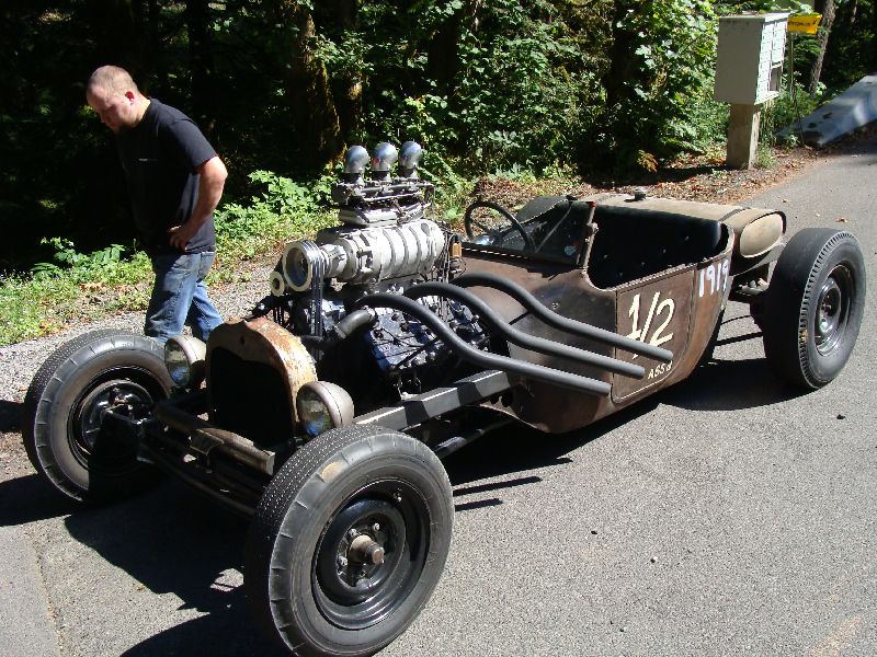

    here is one
  17. 38FLATTIE
    Joined: Oct 26, 2008
    Posts: 4,349
    38FLATTIE
    from Colorado
    bct, is that yours? Any details?
  18. RADustin
    Joined: Aug 16, 2011
    Posts: 192
    RADustin
    from Louisiana
    thats beautiful. what manifold and blower is that?

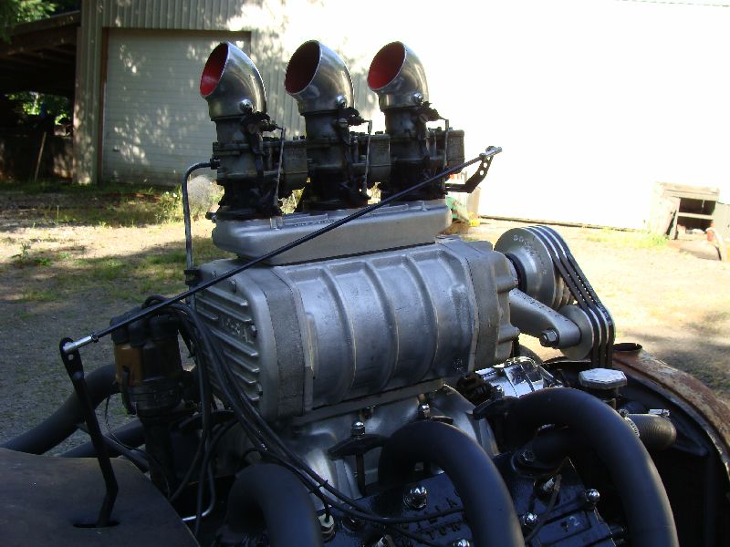

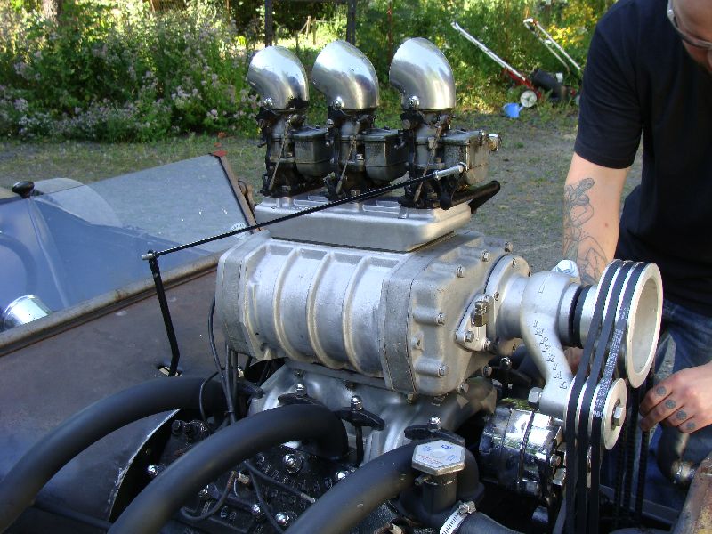

    Colin finished his 4-71 intake and blower drive system, and it's installed on Dennis's car. Now that is the perfect Flatcad engine!

    yeah it's cool as hell. I been talking with Dennis quite a bit. Those guys are awesome.

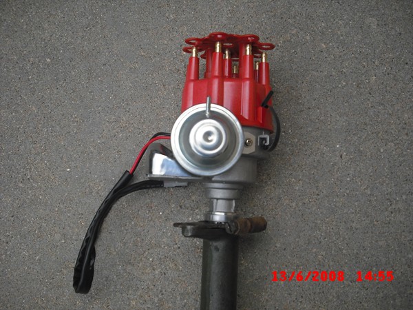

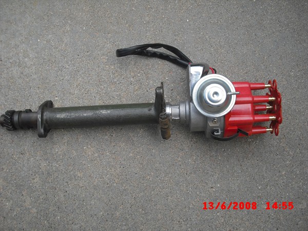

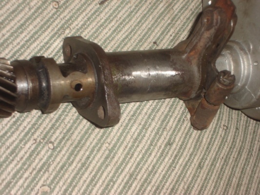

    I got to looking at the dizzy tower while measuring everything to convert my late model computer controlled HEI to the caddy, and I'm going to shorten everything up 4". Seems easy enough. I chucked the whole stock dizzy tower whatcha-call-it in the lathe and started cutting. I'll get my water jet guy to cut a new flange for the top that I'll weld on once everything is cut down.
    Only thing is, the new HEI I'm using has a small shaft dia by about .020" and the main body is too small by about .040 IIRC. So some sleeves will need to be cut to make up the difference. Easy enough. Should have pics by wednesday or so when I have time to work on this again.
  22. 38FLATTIE
    Posts: 4,349
    38FLATTIE
    from Colorado
    RADustin, the stock Chevy HEI's I did, didn't require bushings, or welding.
    Small cap with remore coil, and large cap with coil.

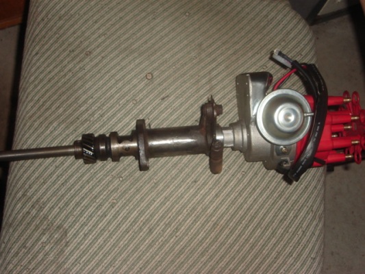

  23. fiftyv8
    Joined: Mar 11, 2007
    Posts: 5,401
    fiftyv8
    from CO & WA
    I shortened my dizzy housing and used the HEI setup by 38flattie.
    I dont recall all the deal with shortening as it goes back a couple of years now,
    All I really recall was that is was not that difficult but did need machine shop accuracy and a bit of fooling around with a bushing.
    Not all that much to be seen in the pic's but here they anyway.

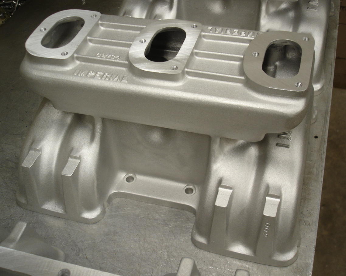

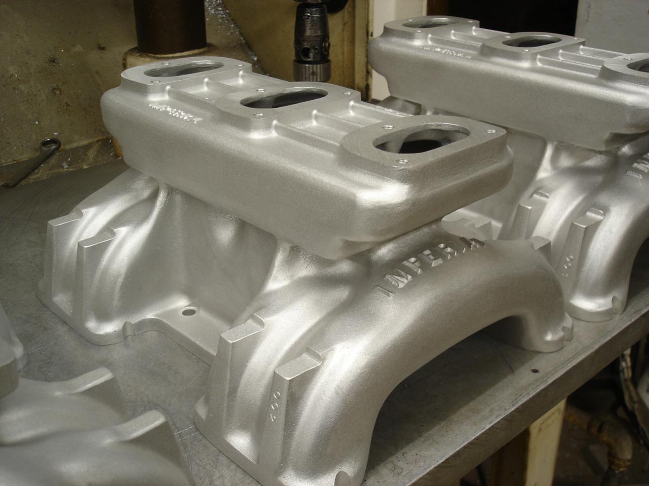

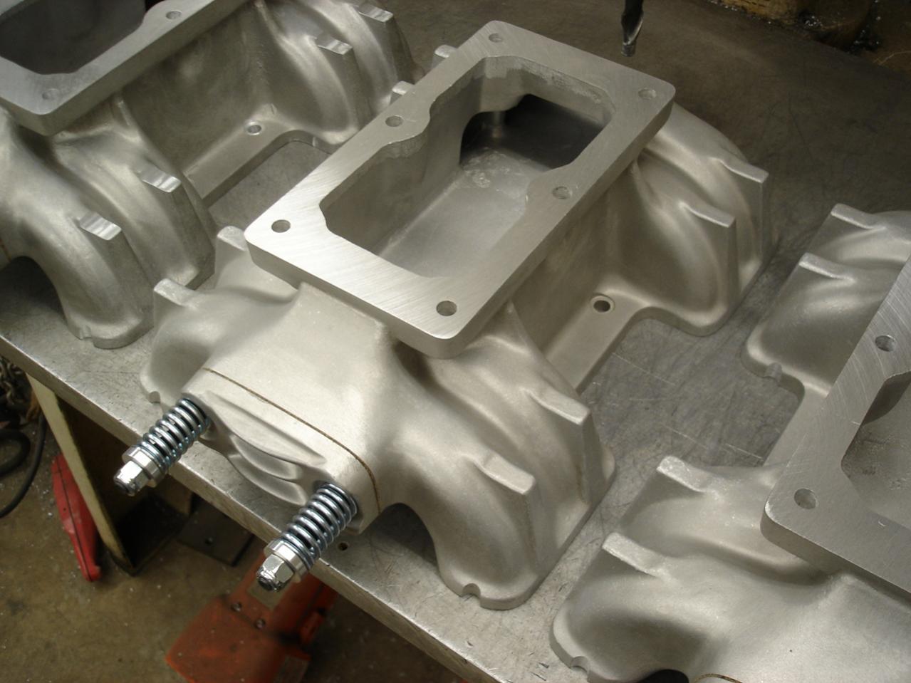

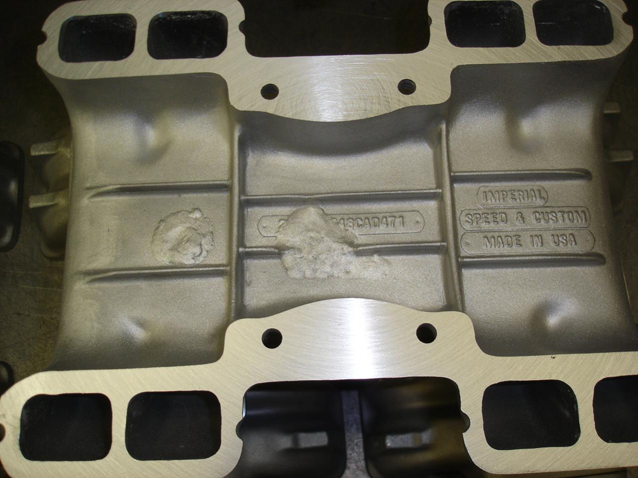

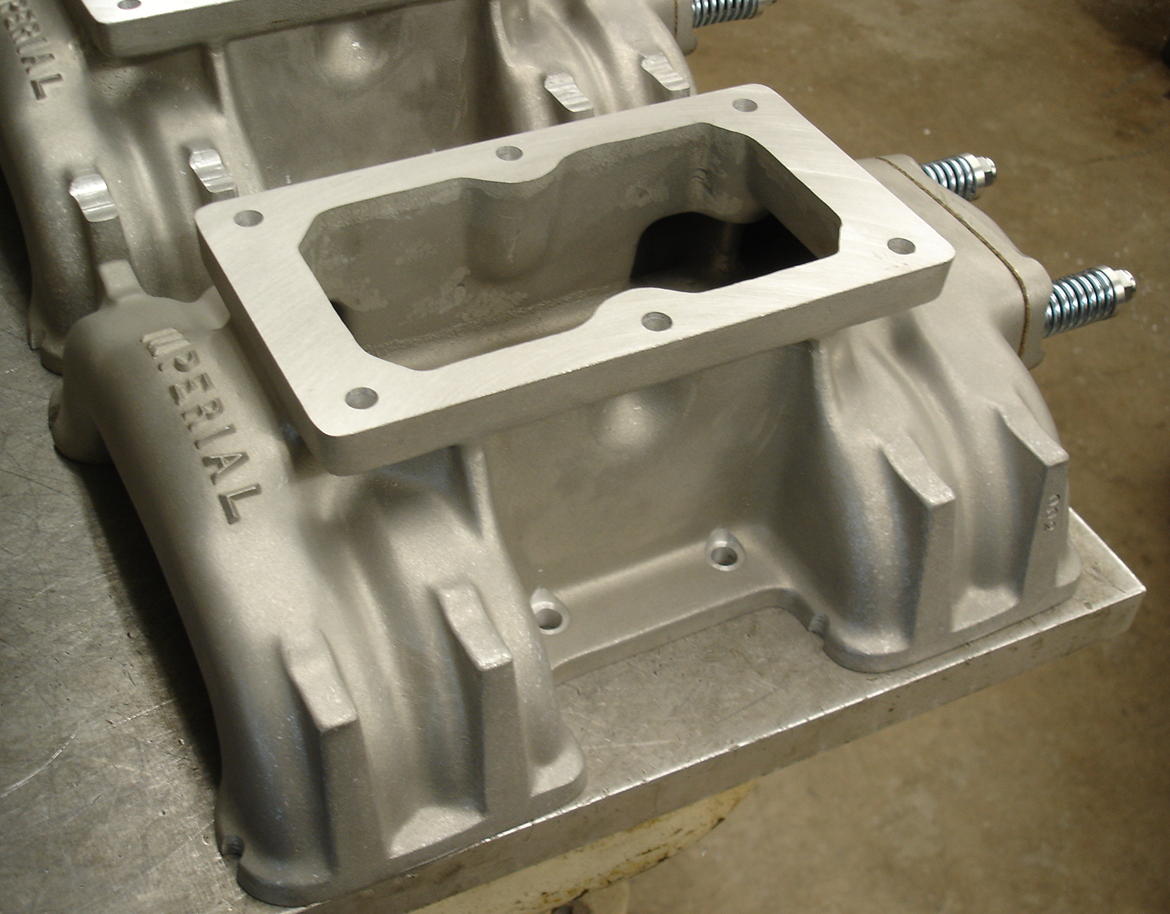

    Colin finished the first run of 4-71 blower manifolds, and they are nice!:cool:
    He also made a few tri-power setups, although he wasn't thrilled with some of the casting, and welded them up.
    I'm hoping Santa Claus sees this, and brings me a 4-71 intake!:D:D:D

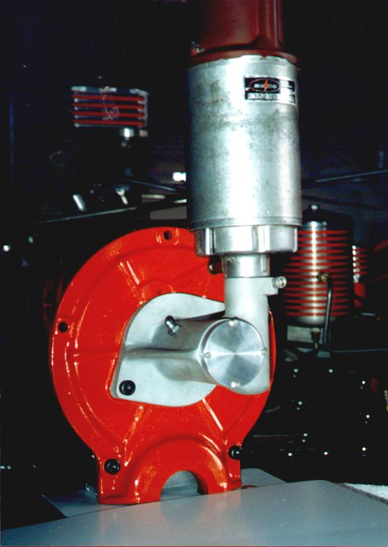

    So, what do you guys think of a front mount dizzy?
    Collin and I are working on a cast, front mount, dizzy timing cover, based on Fiftyv8's cast cover (pictured below).I've talked to Fiftyv8, and he has no issue with us doing it.
    The mount will allow for the use of the Ford front mount dizzy, or Flatheads Forever (Norm Frick) angle drive, also pictured below.

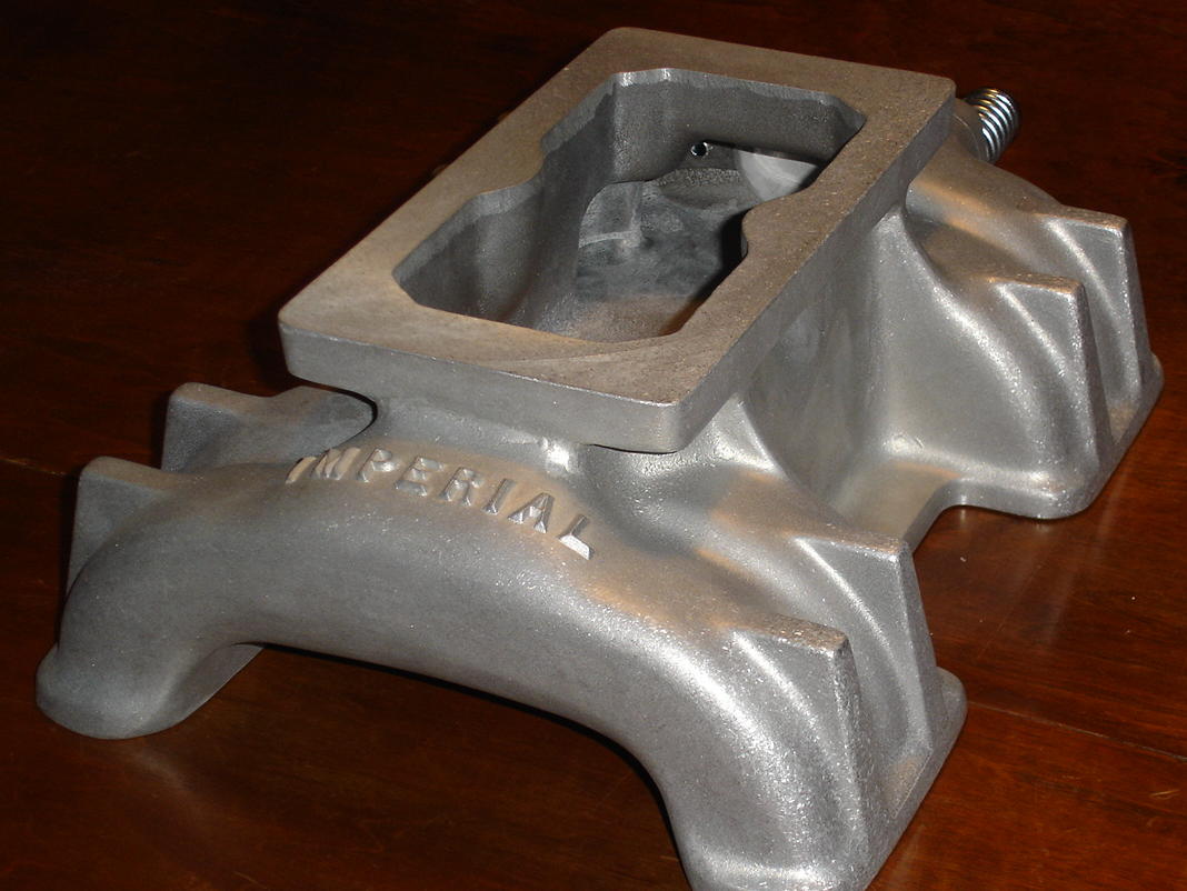

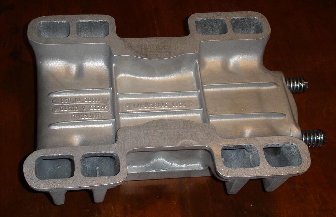

    Collin only has a couple of the 4-71 blower intakes, and a couple of the 3x2 tops left.
    If you are ever going to want one, you better get it now!
  30. Bullington
    Joined: Feb 27, 2007
    Posts: 329
    Bullington
    1. Northwest HAMBers
    How do you contact Collin? Interested in a 3x2
