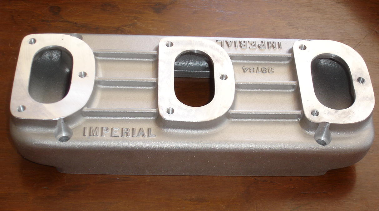

    Peddro, last I knew, the tri-power was $150, and the intake was $650, but you may be able to negotiate.
    I know he sold 1 tripower today, and is negiotating on an intake, but he should have at least 1 each left.
    The tripower is made to sit on a 4-71 blower.

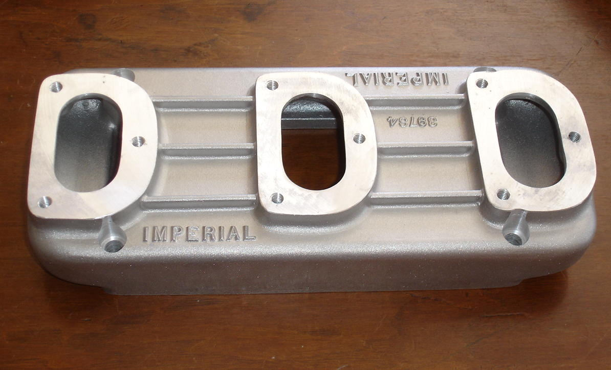

    The FlatCad is an all out race engine, and we'll soon have numbers on it. I've been wondering what kind of performance a guy could get using speed parts that are now becoming available for Caddy flatheads.
    I'm going to build the engine, running parts from www.flatcaddy.com, and Collins blower intake and tri-power, and see what it will do at Bonneville!

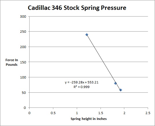

    got my stock springs measured out. I charted all the data and fit a line so I can figure out the stock rate. I get about 260#/in on these worn out springs. At the installed height of 1.921" we were getting ~58 pounds...supposed to be 66. Not terrible I suppose. We brought the pressure up to 80# and measured height, and then coil bound it and measured height.
    now the debate is whether to buy stock replacements and shim them to 80# on the seat, or get something with a higher rate.
    summit has these...
    http://www.summitracing.com/parts/CCA-903-1/
    which would work but require spacers as well. Increase rate to 293#/in. Not real sure if its worth it though. It would increase open pressure by ~12-15#.
  17. 38FLATTIE
    Joined: Oct 26, 2008
    Posts: 4,349
    38FLATTIE
    from Colorado
    I think you'll want to go to stiffer springs. When Garry ran his roadster with a blown stock Caddy last year, he had a hard time building over 4-5 lbs boost, as he didn't have enough spring!
