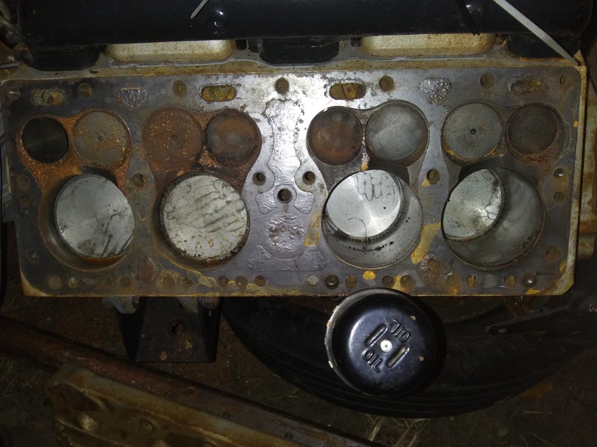

    Hay guys I just picked up a 41 Flat head off Facebook market place the previous owner unbolted the head to look at the pistons I want to cinch the head back down and see if it will run the previous owner said it ran but he was a young kid and didn't know what he was doing . LOL He handed me the voltage regulator when I bought the motor and said this is the brains of the motor ( the computer ) it will not run with out it . I just laughed and said ok . But anyway can you tell me the torque specs for the head.

    The book say 65-70ft-lbs, but not all in one go, ease upto that.
    You will probably need a sequence drawing which somebody may have otherwise let me know and I'll work out how to post a copy for you.
    If you plan to run coolant you will need to thread seal the end of all your head bolts.
    Make sure the crank turns by hand first, these engines have a habit of not turning easily for several reasons, the main one is valves seize and prevent the cam from turning which then stops the timing chain which stops the crank.
    Another test if it wont turn is to remove the timing chain to see if the crank will turn.
    If not your bores could be the problem.
    A lot of rust scale and **** seems to drop down into the combustion chamber due to the configuration of the exhaust manifolds which does not help things much...
    Lets us know if it lives...

    The engine turns over I turned it when I picked it up. the kids said it was clean under the head. They obviously didn't know what they were doing cause they said it ran when it was in the car . Im ***uming they thought it was a valve cover not a head when they took it off. The bolts are still loose so im going to take that one side off and look, like they did. I got a funny feeling this motor is freshly rebuilt. Otherwise I doubt they would have said it was clean. I will post some pics tonight.

    So it looks like it's freshly rebuilt. .30 over

    What bore dia is your engine that will tell you for sure if it was a 322 or a 346 the engine i started with was a fresh rebuild too but it was a .40 over 322 I needed forged pistons so I bored it to standard 346 bore size of anyone needs them I have a set of .40 322 pistons with rings that are new I would part with a lot of those engines out there are army surplus engines like the one I have Flatcad engines are awesome
