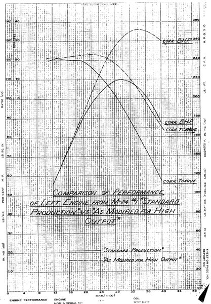

    Here is sum info you might like

    Nice info Rille, thanks alot for that.
    It is all interesting.

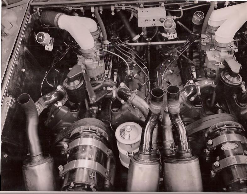

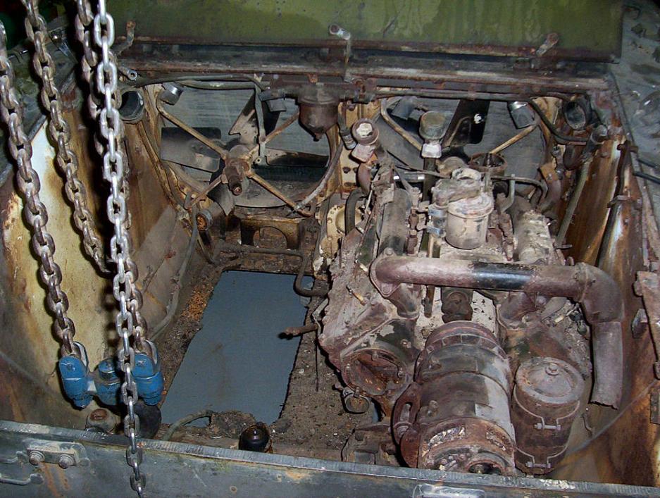

    Finally ,I found it !!! ....... Here is a pic of twin flathead Cadillac engines in a tank ...... but look real close ! ....... they have dual carbs intakes and those hard to find tank dual exhaust manifolds that everyone is looking for ..... So just to let people know there are 3 type's .. tank style , industrial style ... and the standard car type with the cross over..... but I have heard there is one more ?????? ....or I even hear that someone might make some new ones so we can run duals on are flattys without breaking the bank or looking for those parts which you just can find anymore .............we shall see .......injoy

    hi steve!
    cool picture for sure..without doubt this is the later called frank burrell dual intake. he was head dynotester for cadillac during the wwII. he later bought the pattern, wich his son barry now use to make these beautifull intake in.
    i know i have shown these before, but here's the brochure from burrell...

    Well Rille, I guess my manifolds are the industrial version, but should do the trick for me for now. I note the fact that the generators have been spun around to make room for the Burrell intake manifold.

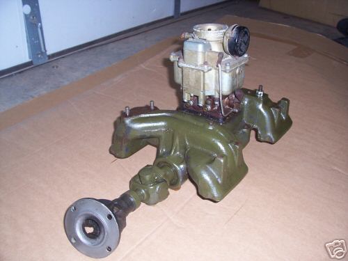

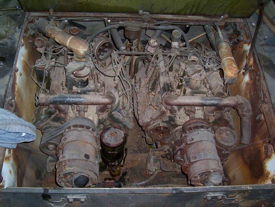

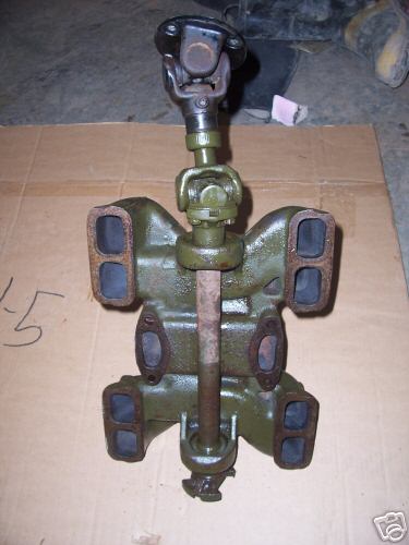

    No , its not because of the burrell intake that they had to turn the generators around .. it was because the generators are so huge and also on the bottom of the tank manifolds there is a small driveshaft coming from the nose of the generators going underneth the manifold to drive even more equipment ..... look close on the new pic , Steve

    That is the 1st time I have noticed the drive shafts under the intake.
    What do they drive, I am ***uming hydraulics, I guess that also explains the heavy duty belts up front then.

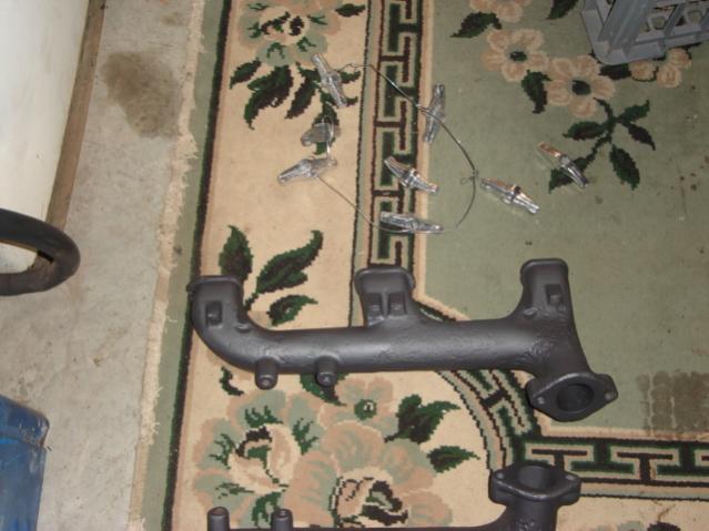

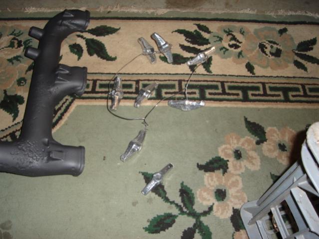

    Here are the manifold pic's as promised as you can see they have seen better times but I just think of them as being light weight.
    I wanted to coat them the same as the T bars, but I was told all the imperfections would make them look like ****.
    So this is what I ended up with.
    Sorry about the quality of the background, you can see the smooth areas where the crack repairs were done.
    I had a 10 & 6 inch long crack on one side and a Vee shaped crack on the center port outlet on the other, I was wondering if I should have bothered at all with repairing them. I guess no as long as they hold together it will have been worth it, but I definitely not need to find any more crack in them for a very long time or they may end up taking their 1st flying lesson.

    The drive shafts that run under the intake manifolds drives a huge fan infront of a rad behind the engines ....

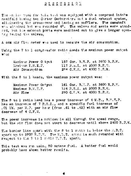

    Here's a couple of interesting do***ents, courtesy of Thomas Kidd.
    This is some great info, guy's, let's keep this thread going!
