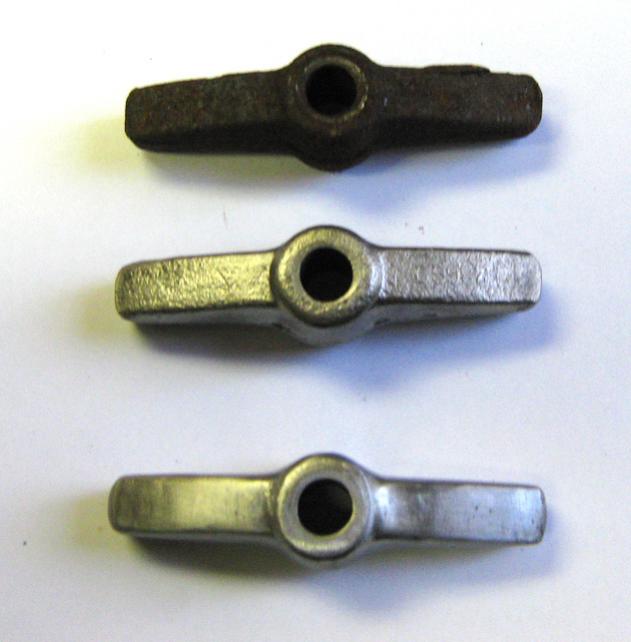

    Again this is a bit off topic, but what are you guys doing about the intake / exhaust clamps. Are you making your own, can't imagine you would have the intake and heads posted above with some pitted out clamps.
    Here is what I have, as you can see by the top example the set I have is pretty rough. The middle example is using a wire brush, while the bottom example is wire brush then sanding the pits away, still a ways to go but I was hoping for a better direction. I might just try to machine something up myself.

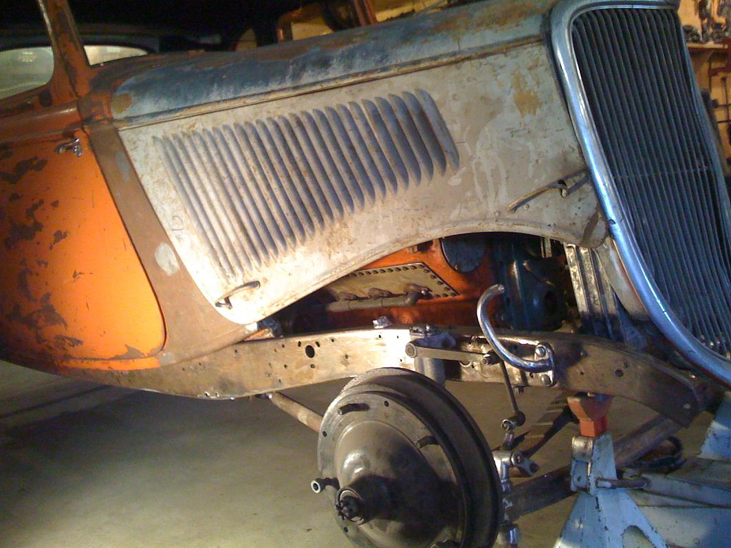

    The water jacket on your engine is crazy, what does it hook up to. I would love to see it with one of those panels off. WOW 38 bolts holding those on!!
    And I see
    -you cut down the weights on the crank shaft.
    -Domed pistons
    There is some really crazy stuff going on there. You are doing a lot similar to what I want to do with my build even down to the friction shocks. Cool, tell us more.

    It has extra studs in the heads tooo.. they trimmed off the side motor mounts too.
    also my distributor sits in the middle. which is different from alot I have saw
    aaron

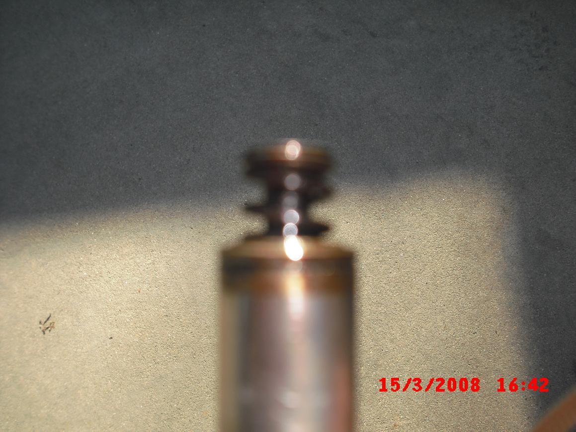

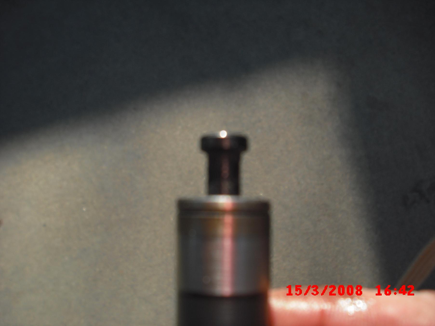

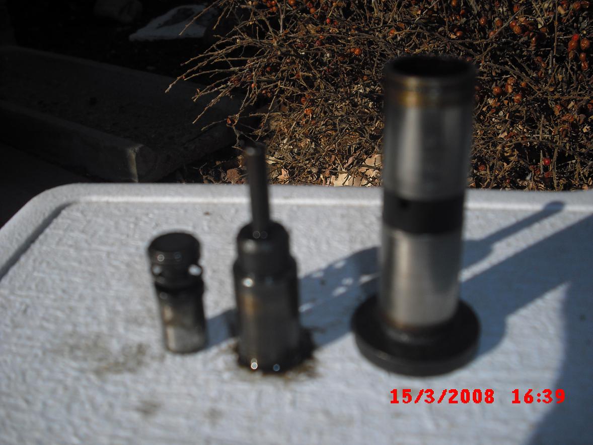

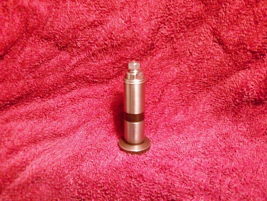

    I've found two different types of hydraulic lifter in these motors. Are the more designs, or just the two? The first two pics are of the earlier design(I think). The last two pics are of lifters out of a 1948 motor.
    Can anyone speak as to which one may be better, pros and cons, etc.? Are these both stock setups, or was one changed at some point?

    I only know of two types, one is shorter than the other and from what I remember they sell a spacer in a kit from Egge to rebuild them or something like that.

    They are both the same length, when ***embled.The housings on both are the same length, but the lifter bodies themselves are different,as evidenced in the pics.
    I can't find any answers in print. A gentleman here, who is in his 80's, thinks he remembers it was a 1948 only design, but he's not positive.
    I'd like to know if they are stock, and what benifits can be derived from using them, if any.

    Hi guys , as for hydro lifters ..... there is 3 diffrent ones , there is a earlystyle ....(mid) late style and at the end of 48 they came out with one more design which seemed to fix the leak down problem they where having with these types of lifters.......... but now are really hard to find and big bucks .....And as for a diffrence in height , Yes there is !... the early style is slightly shorter that the late style and the oiling band around the lifter is in a diffrent placement and the oiling hole is smaller on the early style + the plungers are diffrent and dont interchange because it will really screw up the height of the lifter . When I get a new camra I will find some and post clear pics ........... and yes I am working as fast as I can , just got the tooling to make those solid lifter convertion kits , to those who need them .........Steve

    The ones in the last pics are the ones that they came out in the end of 48 (new design)..... with the little clip and no spring in the top. The ones in the other pic would be late style hydro's , the ones with the spring in the top (secound generation)........the only problem with these lifters is that they were prone to leak down if not working right or pump up and float at high rpm's ..... so thats why thompson came up with that kit to make them solid and fix those plaging problems.......Steve

    So the late '48's are the best of the hydraulics, and the most desirable. That's good to know.
    With just a spring clip holding them together, it would be a very easy conversion to solids......

    Prity much all the lifter bodys are all the same ! ... its the guts of the lifter that are diffrent ...... but like I said before..... they were prone to leakdown problems and pumping up at high rpm's , even the new style at the end of 48 (all the hydo lifters) they work but you are limited and prone to probs later ........thats why solid covertion............
