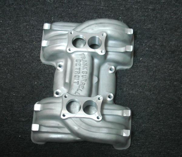

    Look what a little birdy just dropped off at my buddy's doorstep. If you are wondering what the bright light is ...it is the gleam on my smile because I am ear to ear.

    from Colorado
    Now that's just awesome! Is it yours or your buddy's?

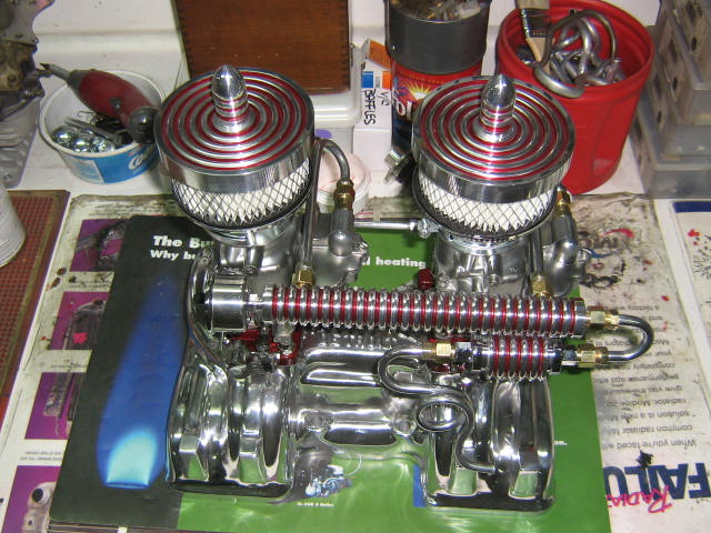

    A polished Burrell! It just doesn't get any better.****York is doing my carbs, then i'll send you a pic.

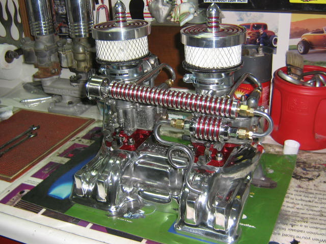

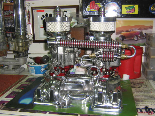

    Here are the pics I've been promising of the Burrell 2x2. **** York did the carbs, and I think he did a helluva job!!! Many thanks, ****!
    As soon as the tri-power is finished, I'll post pics.
    This Burrell setup is for sale. Contact ,me if interested

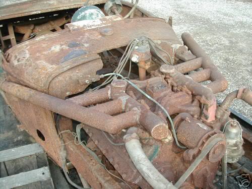

    Here is some more exhaust pics , bet you havent seen these before.. marine man's ......... Steve

    Russ posted a pic of one of those intakes, but I've never seen the exhaust before. This is out of a boat?

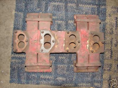

    Here's a pretty cool 4x2 intake from Dabirdguy's website.

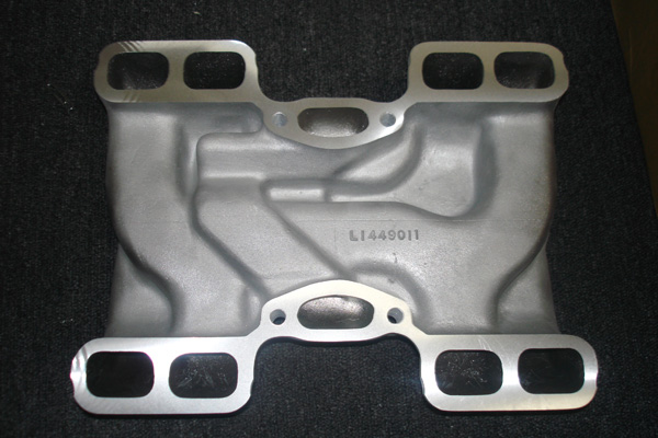

    I've posted here that I'm working on a tri-power, I'm actually working on two. One is simply modifying a 1936 manifold, and that's for my use, because I've got specific plans for that, like um.. a blower adapter, similar to what Aaron did with the Burrell.
    The other one is an aluminum log style manifold. I figure that I might as well cut enough extra to make 3 additional manifolds. It's not much more work when the pattern is made, to cut enough for four, instead of one.
    Any interest out there?
    Therefore, the Burrell setup I posted pics of earlier is for sale. Contact me if interested.
