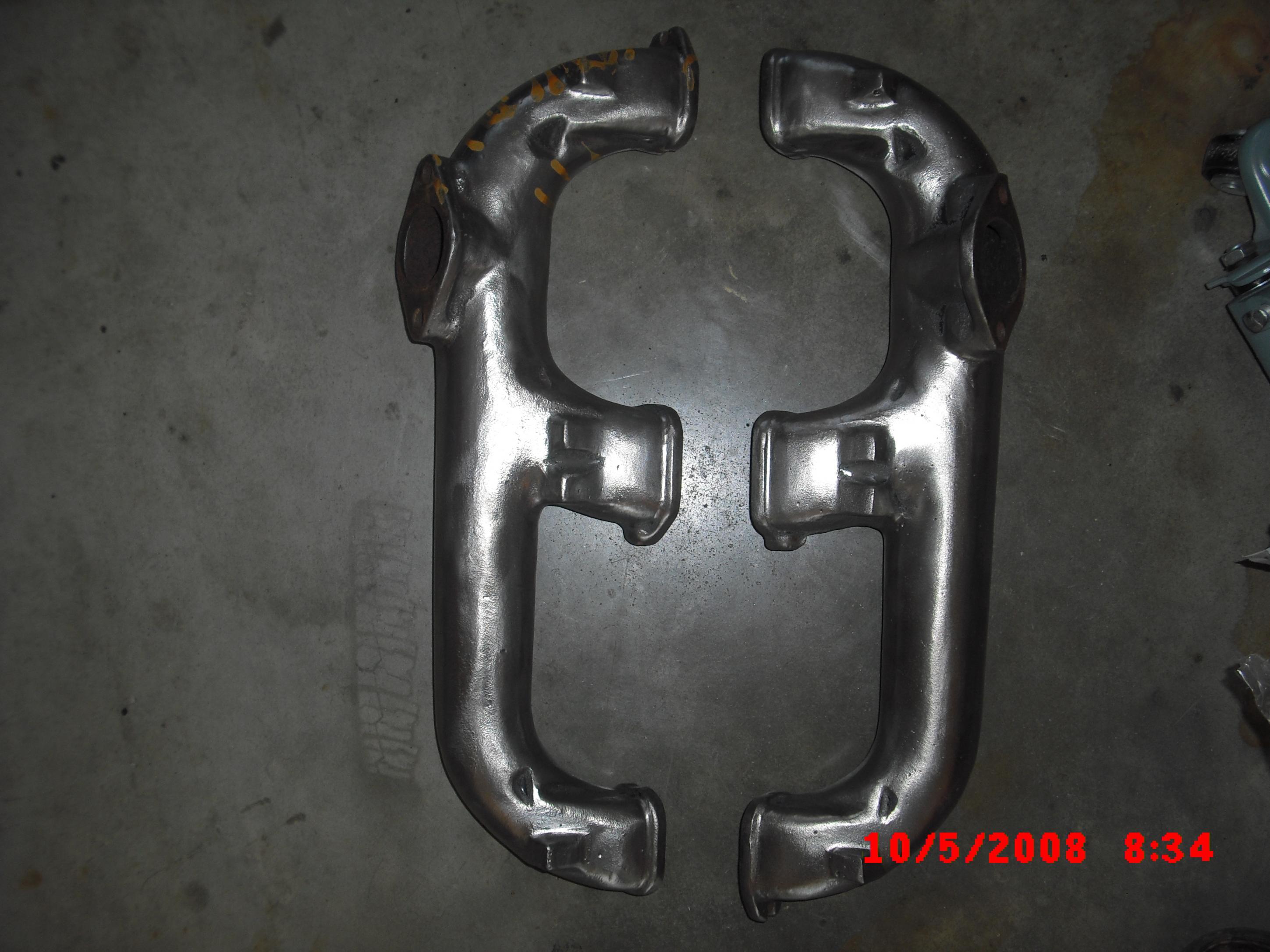

    The first pic is my dual exhaust, prepped and ready to ship today to get cermakromed. Stock drivers side, and stock series 80-90 passenger side. I will use the crossover ports for exit.
    Last pic is for my second set, with more of a factory look. It is the passenger side off of a 1936 caddy. I will use it with a 1937 passenger side. I will turn the 1937 around, and use it on the driver side- very little work, simply relocate the alignment dowell in the block. I'll be removing the crossover ports from both pieces, for a cleaner look. I'll send pics when they are prepped and ready for shipping.

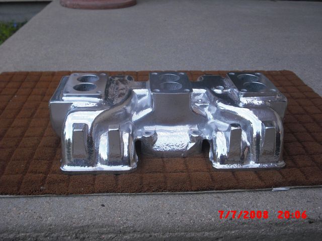

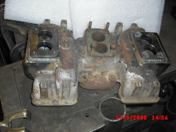

    Here is pics of my tri-power. nothing fancy, but it is functional. I just need to grind/smooth out the welds and rough edges, bead blast, and send it off for coating. The pics are not very good, as the carb bases do not appear to be aligned. They are exactly the same height, and are in fact in alignment.
    I should have a hei conversion done in about two weeks, and I'll post it

    wow i like that intake..i was thinking of using the flat head from my old hearse in some kind of a hot rod, but wasnt sure about being able to afford the parts..if i didnt use this engine, how much would a low mileage good running 46 caddy flathead be worth? i might just sell it and use the money to build my 8ba instead..the car is still in the planning stage so dont know which way to go..i am open to sugestions :)

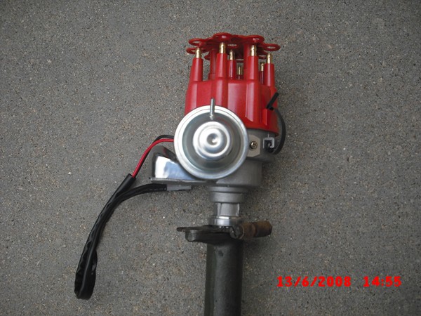

    Here are a couple of hei's I just finished for the caddy flatheads.
    The black one is a true hei, with enough spark to bbq. It isn't the prettiest thing, but it is powerful!
    The red one was a special request. It is a small cap, remote coil hei.

    This is the dizzy I'm going to run, converted to remote hei.
    Heads are done, and I'll post pics within the week. I've got some pretty trick, custom one-off parts I'll be posting, so let me know what you think.

    Here is the finished tri-power, with coating. Not perfect, but now I know what kind of finish the metal needs for the coating.
    My heads are done, and I'll post pics this weekend.

    That intake looks cool with the coating on it, What does it weigh?
    Can't wait to see the heads, Did the others ship to the buyer already?
    No more sets left from that last run of 10, The next run will be on an pre-order basis. may not be making some anytime soon unless poeple step up :).

    The heads are on their way to Brisbane! The intake isn't as light as I would like wheighing in at 28lbs. The Burrell was far lighter, and better looking. With the availabilty of solid lifters, I was after cfm's for power. This accomplishes that.
