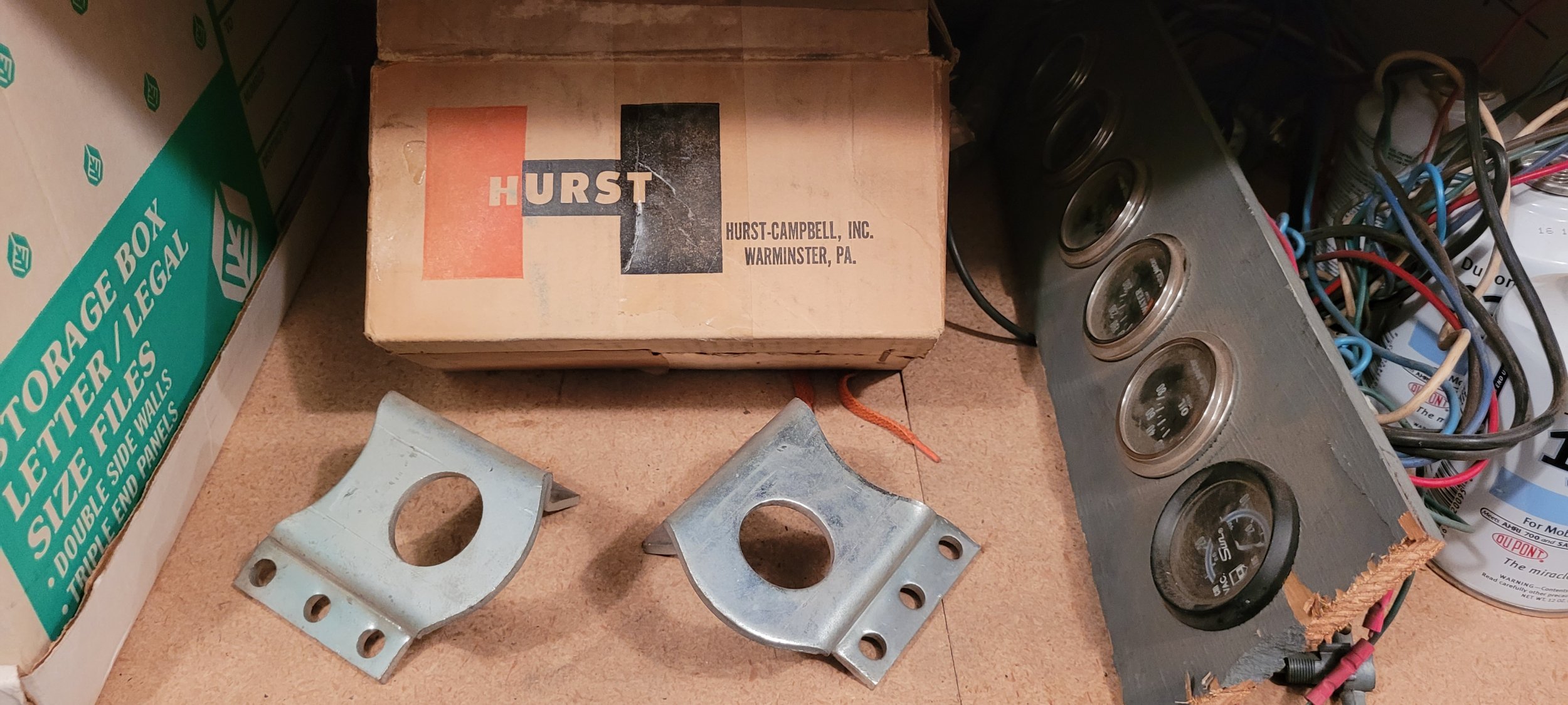

  23. Should be a hurst copy
    then there’s a steering link that needs dropped.
    Trans? Caddy or ford. Adapters out there for bolting the ford trans to the caddy.
    Was a fairly common swap in the day.
    I’d stab the engine and trans in and build.
    Sometimes these mounts sit the engine kinda high

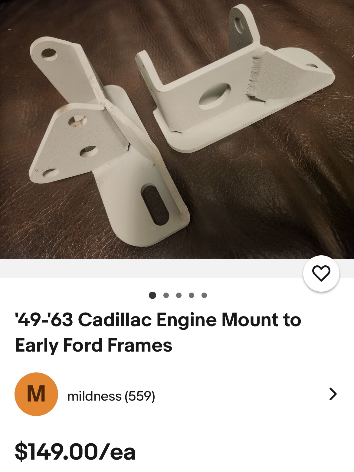

  24. Spot on Anthony and when you're using those in a 49-54 Ford Car you need these for the Ch***is side. Using the early Ford biscuits makes a nutz-n-boltz deal for the motor part.

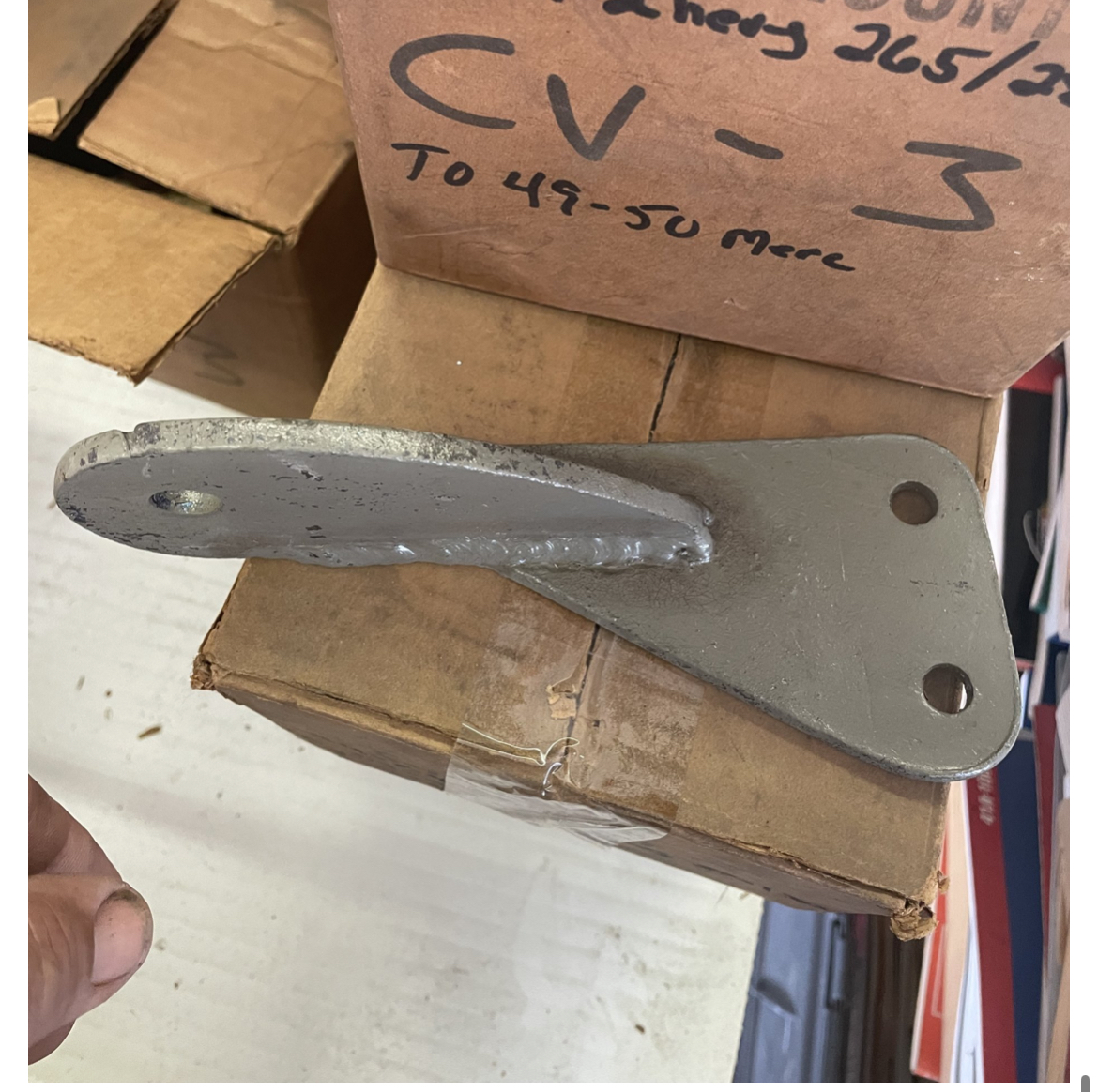

    I bought a set of swap mounts for a Merc, not hurst, another manufacturer. IMG_6537.jpeg

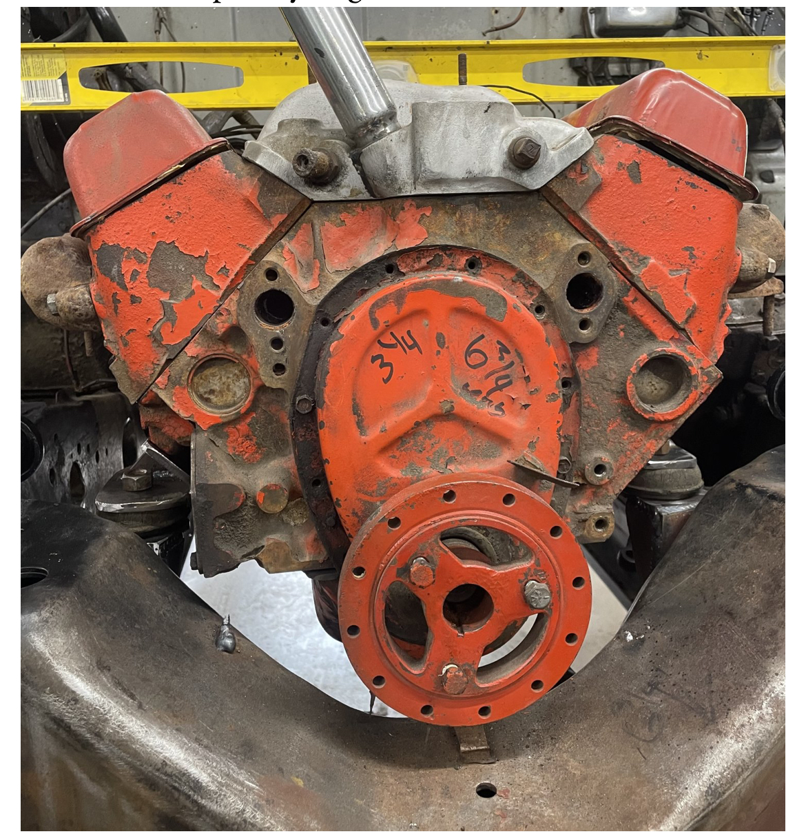

    Here is a sbc hooked to an original trans with the carb mount level

    Something seems off.
    The reason I wondered if some swap mounts set an engine higher in the ch***is was I also got a y block. With the y hooked to the merc trans, the block would needed raised to clear the pan under the timing cover a good bit without cutting the front x-member.
    Just wondering.

  27. I’ve got that set of mounts.
    Never opened em. The opened pic is from an opened box set I found. I guess the instruction are in there somewhere:)
    C-T automotive made em
    Not familiar with them and not much info out there
