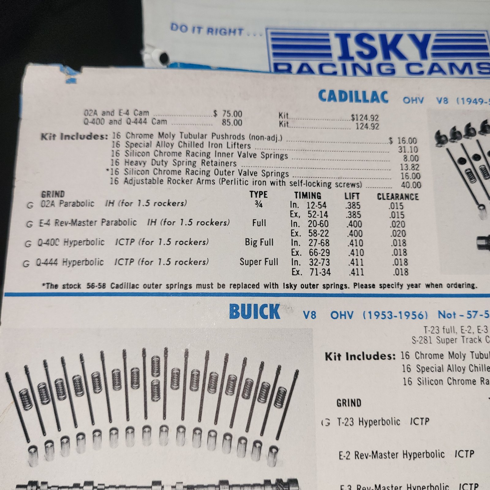

    Hi all, I purchased an old cadillac 331 that's got an isky Q-400 cam in it. Does anyone have any info or specs? I want to measure it and make sure it's not toast. Thanks!

    Perfect! Thanks man, I really appreciate it!

    Dang that was a lot of money in 58! Caddy stuff has been expensive since the beginning!

    Hell yeah it was expensive. $125 in 1958 is equivalent to $1356 today!

    Someone explain Hyperbolic vs Parabolic. I get it is a geometry term, but I slept through most of that cl***…

    I was trying to figure out the same thing.

    Keep in mind that it's Iskenderian; he also used terms like "5 cycle" and "super le gerra". Probably more of an advertising ploy than anything else.

    I think hyperbolic has a couple extra bolics than parabolic. Maybe that’s where the extra cycle came from.
