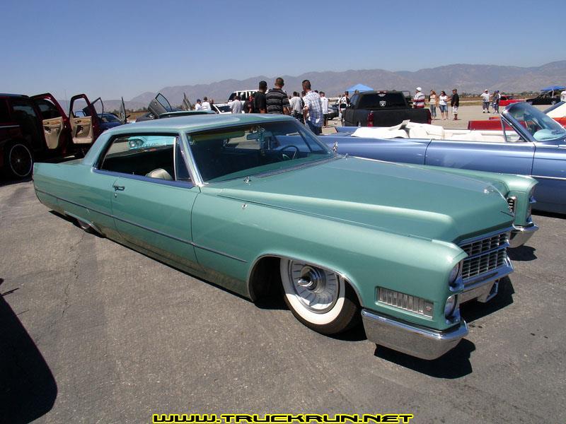

    Here are some pics of a 1967 Cadillac that was bagged at Gambino Kustoms.[​IMG]

    Here are some pics of the one off rear frame build up and C notch that was needed due to the limited space in the rear because of the convertible top compartment. Alex and Dave worked overtime on these. Smaller tires were needed as well in order to lay frame and permit ability to drive low.

    3'' c notch out back,this convert we had to figure out how to do the notch between the top of the frame and under the floor(it was a bitch).we didnt want to cut into the floor cuz thats where the top rests when down and also it has a glass back window so right where you would normaly do a notch where suport rods suportihg the back window.we also extended the upper trailing arms 1/2''cuz it had to much axel roll and pinion change so what we did was made mock up arms out of wood at 1/2'' incraments untill we found the optamon length.we also used stock caddy electric window switches (for the bag switches)and installed them where the window lock was in the door arm rest bezzel.
    this caddy will come back for the full mild custom treatment.
    we also had to notch the tranny x member so we chould run dual exhaust on these caddys when you lay em out like this theres not a whole lot of room to run exhaust.
    the front bags where the H6 slambag equivelant,out back where 4 ply conti tec bags.we also ran shorter shocks out back
