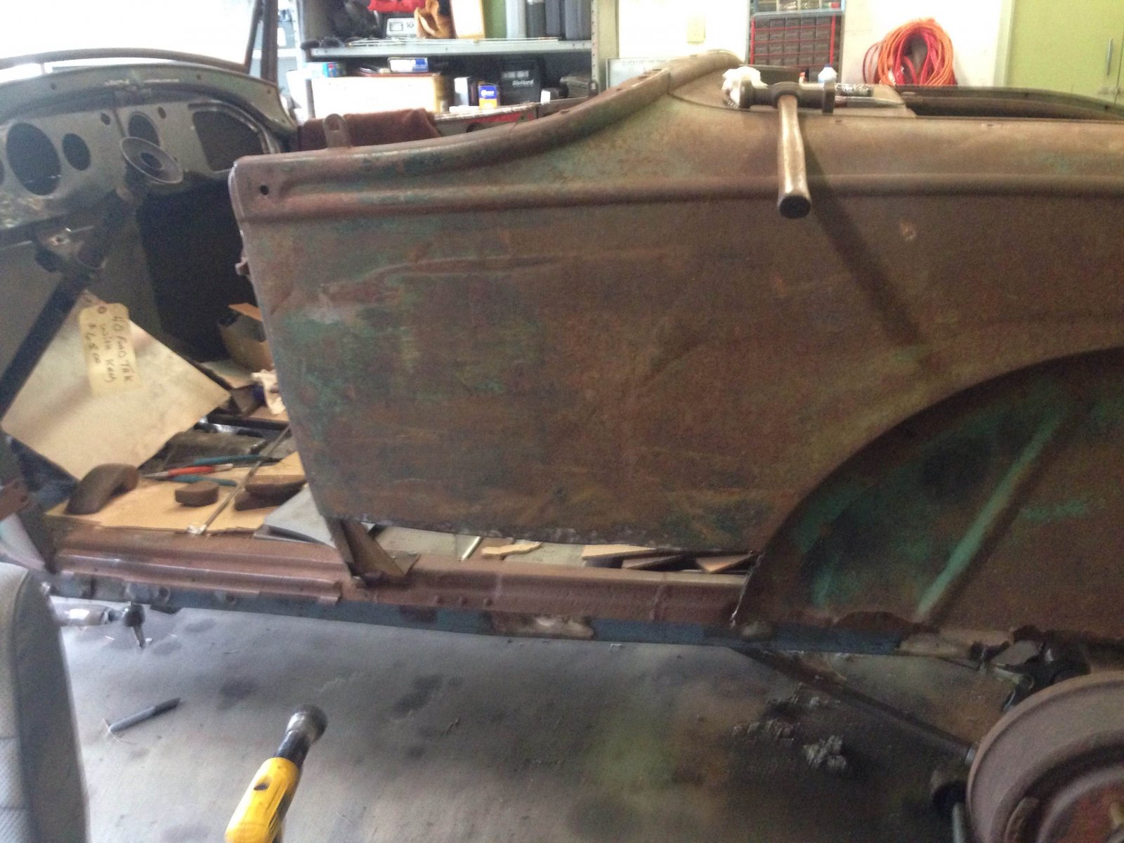

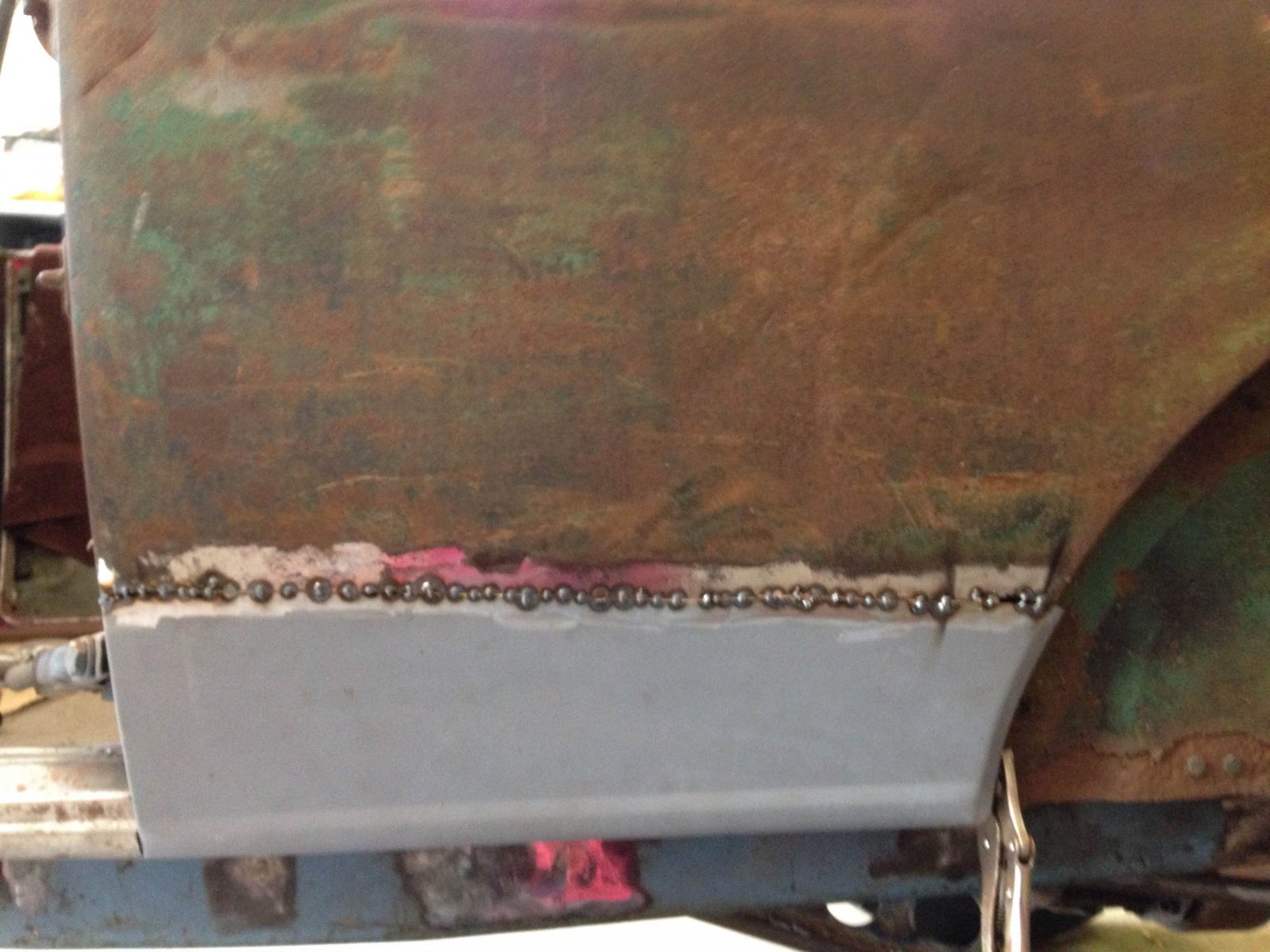

    Since our daughter made her appearance I have been able to make it out to the garage occasionally. I decided to shift gears a little bit to the body. Last summer I replaced the original back half I got with the body initially with a much more solid unit. It still needs a little help as there is still rust to contend with and a bunch of dents. The first area I tried my hand at was probably the worst of the rot on the body; the area between the driver door and rear wheel well.
    I started by taking the hammer and dolly and trying to get the quarter closer to where it originally lived. The quarter was dented in and it is sometimes difficult to see where you need to hit from the back side of the dent. I used chalk to mark the high spots on the back side of the body that needed bashing. I forgot to grab a picture.
    After that it was time to take the cutoff wheel and cut out the rot.
    From there it was fit the panel to the body.
    Tack tack tack.
    And grind smooth.
    I am decently happy with the results. I haven't done a ton of sheetmetal welding. The hardest part is stopping myself from welding the panel at once. When I get in the groove, I want to keep at it, but I also want to prevent the panel from warping as much as possible.

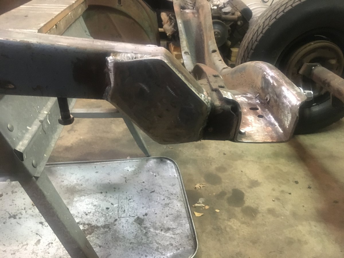

    I have made some progress on the Roadster. I was able to finish up the welding on the frame. It was a really wierd feeling. I have been working on that thing for 5 years and all of the sudden there wasn't anything left to weld.
    I loaded it up in the wagon to get it sandblasted.
    Then off to a friend's shop for powdercoat.
    56426694532--B0C3D57F-D412-401E-9792-1D180C92940C.JPG IMG-4799.JPG IMG-4800.JPG IMG-4801.JPG IMG-4802.JPG 56427125797--4F35629E-15AC-42E6-AA04-8166BAA5B6C4.JPG 56427126877--E0E2CEC4-E630-48CC-992D-ECF7146C91F8.JPG 56427228386--FBC3891D-9C58-4EC0-8D81-FD22700E22F5.JPG
    I am happy with the outcome. It looks far better than the old blue paint that was on it. It feels good to have it one color.
    The hope is to get it back to a roller at least by Spring. Maybe further.

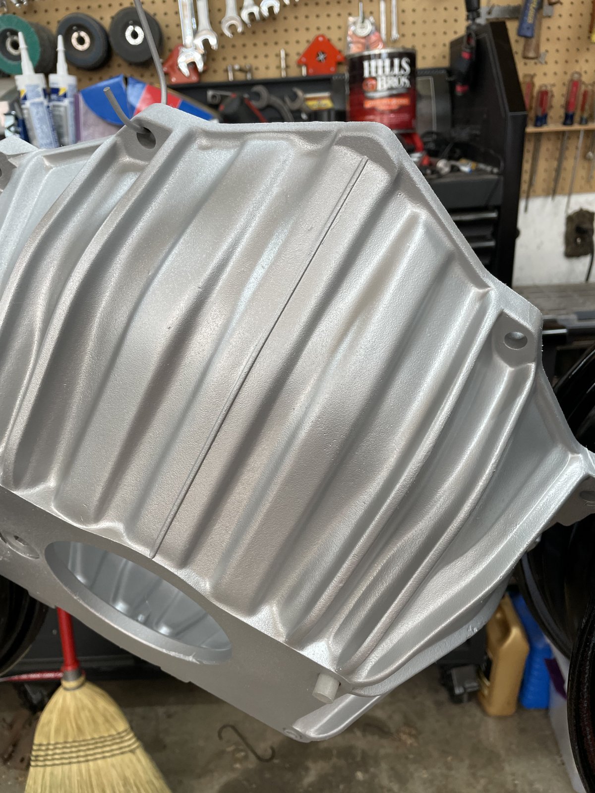

    Over the last year or so I have slowly plugged away at the project. I got my personal powder coating setup up and running.
    I know that spray paint would be easier, but this has been fun and yielded some good results.
    Satin black on small parts.
    Anodized aluminum on the bellhousing. It plays the part really well of fresh aluminum in person.
