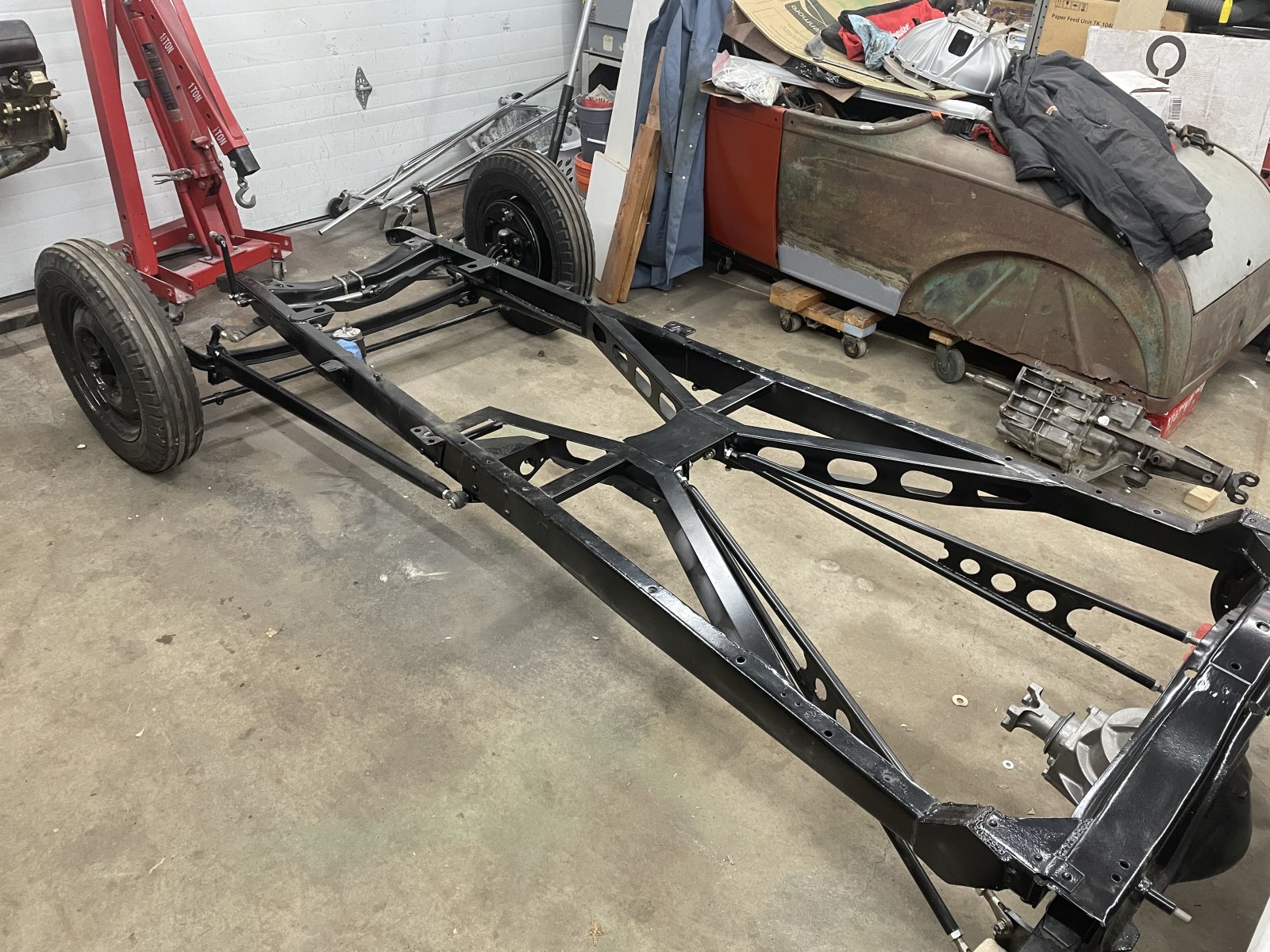

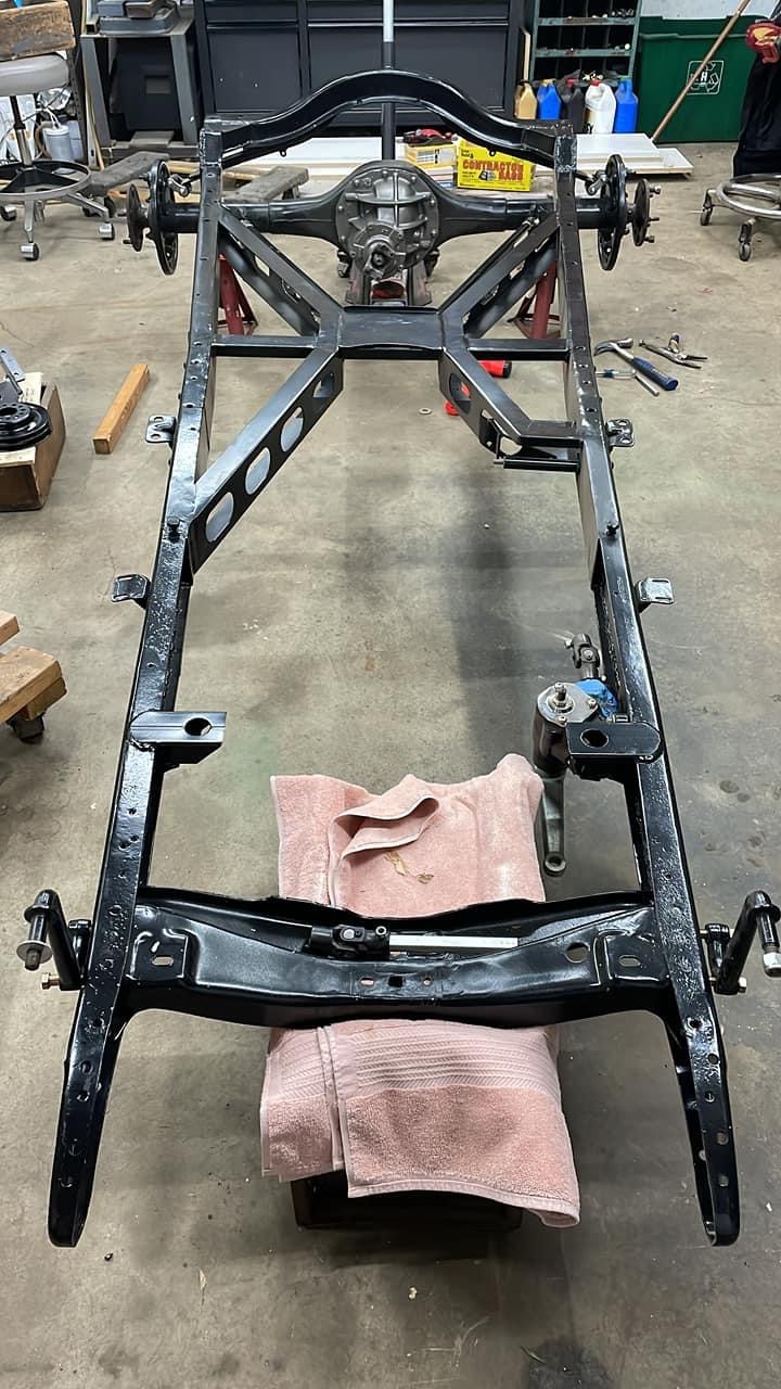

    A few weeks ago I went out to the garage to tinker a bit and maybe straighten up a little.
    While cleaning I looked at the frame and ladder bars sitting on a cart I had made a few years back. I hit my breaking point.
    I was able to muscle the frame off the cart and onto some jack stands by myself.
    It felt good. While I was on a roll I decided to bolt the ladder bars to the rear and get that underneath the frame.
    Then I decided what the heck let’s get the front end under it.
    SO MUCH BETTER!!

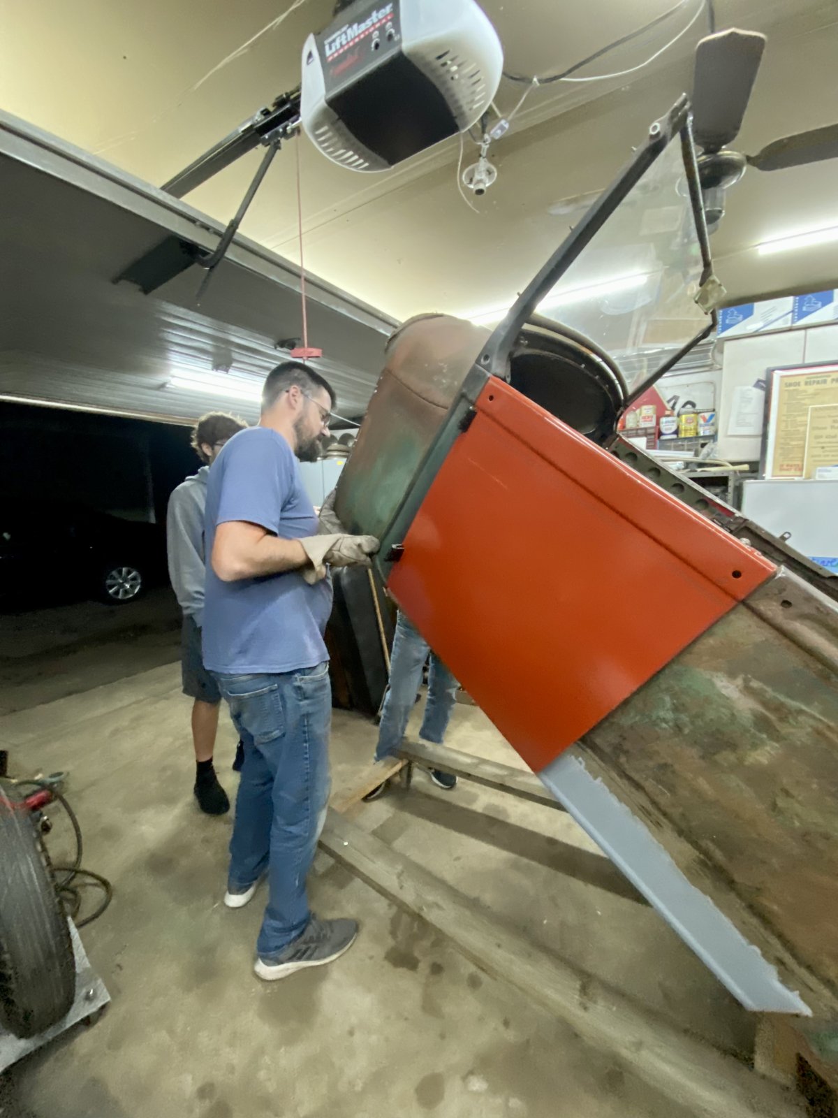

    Now it is time to turn attention to the body to get that mounted to the frame. With the help of some friends I was able to tip the body up and spray some undercoating on the bottom of the body. It was only slightly sketchy.
    Next up is to paint the firewall and then we can mount the body to the frame. I’m getting pretty excited!
