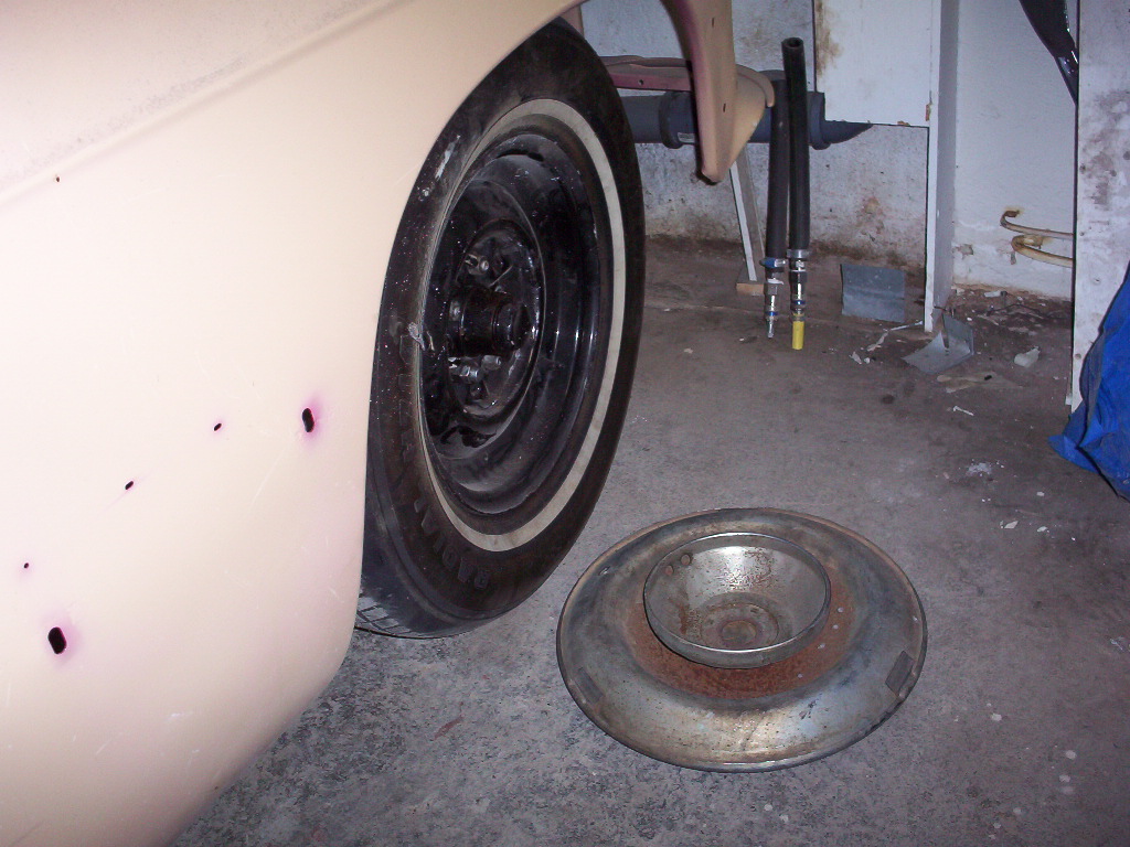

    Does anybody have a pic of the steel rim for the Cadillac Sombrero hubcap? How does the cap fit onto the wheel? Any pics of the wheel will be appreciated.

    here ya go.

    I don't know about the aftermarket ones. The original sombrero wheel covers have a separate but attached smaller baby moon-type cover mounted under the main wheel cover. The smaller/inner piece mounts to the wheel using clips/retainers attached to the wheel. I am not aware of any other car other than Cadillac that has sombrero compatible mounting clips. Various methods have been used to adapt sombreros to "regular' wheels.

    The 55 and up Cadillac wheels have the center welded in backwards compared to a normal wheel to clear the hubcaps.Those wheels and caps are pretty much a direct bolt on for anything with a 5x5 bolt pattern.

    See, I never knew if the caps mounted to clips or nubs, according to a picture above they mount to clips which makes sense considering the small diameter of the mounting base on the back of the cap. I've got 6 of the 15" caps, I've never seen the 16" but I believe they're out there, some of the ones I have are chrome some are stainless. I've experimented with some of the more beat up ones by drilling out the rivets that hold the mounting base to the cap and using a wire hubcap mounting base off mid 80's GM cars with a stud running through it, that stud then threads onto a hubcap bullet holding the cap onto the wheel. I would like to know the process of brazing a trim ring onto the cap, I believe that with the hubcap bullet retention would be far superior to just the bullet holding the cap onto the wheel.
