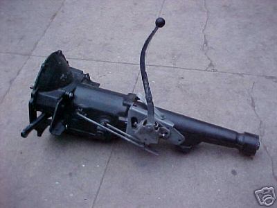

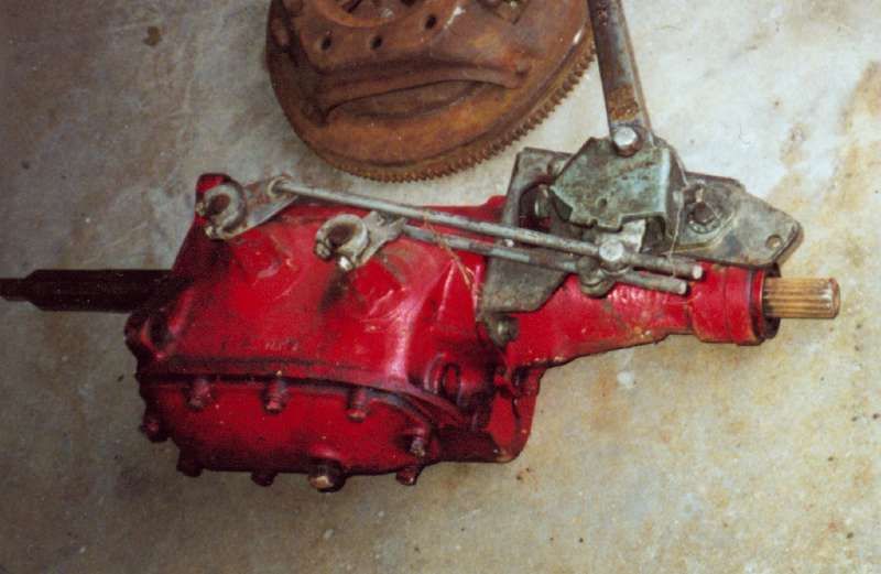

    nope, because you turn the shift levelers upside down on your tranny so it will be right
    check the pics, black one is my caddy tranny and red the olds one..

    I have a 50 olds lasalle short shaft thats replaceing the long cad lasalle in my roadster because it has a slip yolk in back- and its cool as hell, and rare!
    heres the pic
