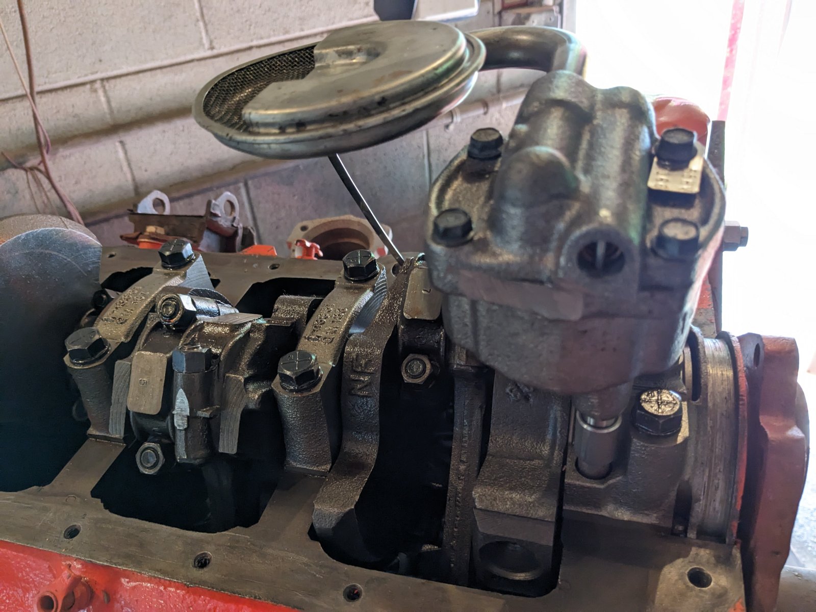

    I know the correct answer is don't, but how does anybody make these finned aluminum pans work? Seems the front gasket is most people's problem, but the rear seems to not seal on this one. But that may be due to the bigger problem: the pan hits the oil pump and holds it from being able to line up the bolt holes. The second pic shows how far off it is. Am I missing something? PXL_20230831_010442529.jpg PXL_20230831_010416664.jpg

    Do the bolt holes line up?...I see the pump may be the culprit...were they interchangeable?...maybe yes but it creates another problem?...
    Can the sump/pickup be moved...
    Is there a baffle interfering?

    If the pump pickup is preventing it from seating then you need to adjust the depth of the pickup.

    @Stogy I know about the different gaskets. Got the early / thin 1 piece this time. Did you mean the pickup is on the correct, left side when you said, "right side"?
    It had just the stock pan on it. Pretty sure I reused the original pickup on a new oil pump, but I put this thing together more years ago than I care to admit. Recent retirement has given me time & motivation to move forward on a couple projects. Hoping to mate this to the trans and get it in the frame asap. Just frustrated when it didn't bolt on.
    I'll check clearances.

    Why not remove the pickup and see if it fits, or if it's the oil pump it's self?

    As I suspected, it hits the PUMP not the pickup. There are strengthening ribs in the pan, and I'm trying to grind one down to stop the interference. But, I may have to grind some off the side of the pump itself. It has a machined "knob" sticking out on that side. This is a lot of work for something that nobody will see but me, and whomever I run over. PXL_20230831_144700261.jpg PXL_20230831_144412010.jpg

    It's probably the high volume pump. A standard pump probably fits without interference.

    I would look at different pumps, different manufactures, and see if other ones don't have that bump on them. Before you grind away on the pan.

    More than likely this. I put a high volume Melling pump on my flathead and I had to modify the pan to make it fit. Harder to mod that pretty little aluminum pan of yours. I would rather have the pump than the pan.

    A little grinding on the pan and... no go. A little grinding on the pump...voila! After all that work, it's got maybe 1/8" between the pan & pump. I know all the reasons not to use this thing, but I'm doing it anyway. Not planning to take it to the dragstrip, it's not 1" off the ground, it doesn't have a crack in it, yes, it's an HV pump, yes I cleaned the aluminum out of the pan, no I didn't grind on the pump while it was on the motor, yes I cleaned that well before putting it back on, I know nobody's gonna see it except me during an oil change, if my engine blows because I used this pan - at least it will look good when it grenades! PXL_20230831_171002123.jpg PXL_20230831_171042040.jpg
