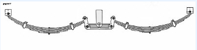

    There is zero difference in brake torque between front and rear mounted callipers [brake torque is the co-efficient of friction applied at the disc radius from axle centreline]
    No matter how it is mounted the resistance /forces applied through the mounting brackets will try to apply negative caster to the spindle/axle.
    These forces can be harnessed with suspension design.
    Trailer manufacturers know this very well with Tandem rocker equalizer suspension and 2 wheel brakes.
    A backyard "cowshed engineer" will mount the brakes on the front axle. [weight transfer is the reasoning]
    This ^^^ will cause lift /loss of traction because the front springs pivot from the front [like a trailing arm]
    If the brakes are mounted on the rear axle it will increase traction because the rear springs pivot from the rear, forcing the wheel downward.
    In both cases the brakes try to rotate the axle the same direction. It is only suspension geometry that changes the outcome.
    And also brake torque is far greater than weight transfer
