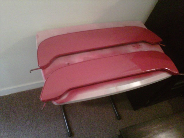

  1. Fender skirts are dry, just letting them cure for a bit before I touch them...I really love the way they came out. One coat was enough for a thick glossy finish. If only the rest of the car came out like this. I think I may do a few more coats of the almond color so it comes out thick like the red....and i should do one more coat of red all across the roof. Just very difficult to paint up there. But yea, so once these are dry I'm putting them to the side until I get mounts fabricated. Getting a battery tomorrow or saturday and then I can start diagnosing to find out my problem.

  7. Damn that custom paint
    obviously professional 10/10 would hire me to screw up their paint job.
    Oh and somehow that fender skirt is now stuck, and I don't even have mounting brackets. Lol what.
