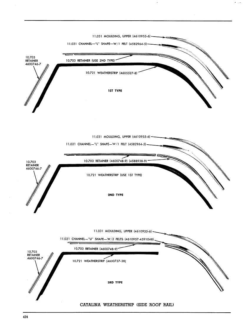

  9. I'm trying to figure out the weather stripping for the catalina, and I came across this diagram. however, my retainer seems to be chipped in some places...is that okay/normal? Or will it be necessary to replace that in the future?
