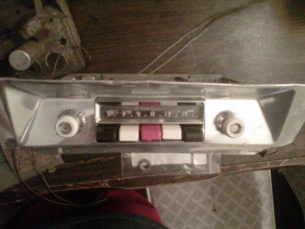

  5. Calling in to get a truck over here to transport her to her temporary home for the next day or two, she'll be in good hands. In the mean time, I'm going to work on the radio. Going to clean up the outside case of it, finish recapping today, and then just polish up the front plate. It's in better condition than the one originally in there, but there are some dents and scuffs I gotta take care of. It'll look a lot better when I'm finished. Just gotta order a ******** and one tube, get a new speaker to mount up and then I can test it once recapping is done

    I know I`m old, but what does recapping mean as it relates to a radio???
    We used to get tires recapped, but I never got my radio recapped.
  7. Recapping is replacing all the electrical components inside a radio, or anything for that matter (telelvisions, record players, fans, etc). Example, replacing old paper and electrolytic capacitors(also called condensors, condesers, caps, etc) as well as replacing the resistors that are necessary. It also involves checking all the insulation on the old wires. I did on recap job, on my big 1929 A****er Kent radio. Also refinished it as well, possibly the best wood refinish I've ever done, I think it was only the second or third thing I've refinished.
    Recapping is essential on anything pre 1980 I would say. Maybe pre 1970s, depending upon the condition. If it still works, okay it works. But if something fails, you're prone to damaging something important, such as a transformer. That's why they say ALWAYS recap any old electronics before using it. You risk damage, fire, explosions, etc.
