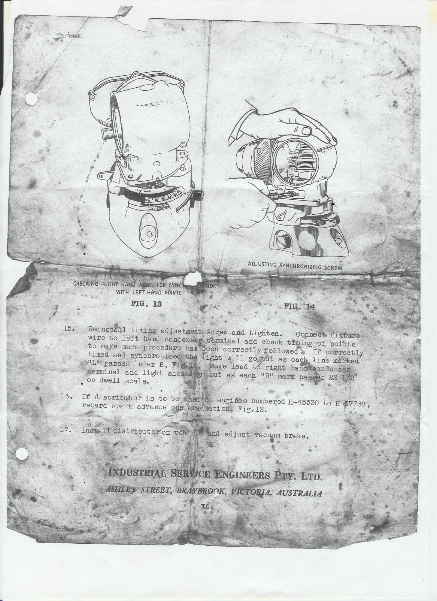

    Hi thanks for the replys, nothing on google, have a copy of last page of instructions. yes Bruce have almost worked it out.
      488.7 KB
      107

    P.S. - Maybe it would be best that I take your picture of the instruction page to him. Let me know. - Rick
