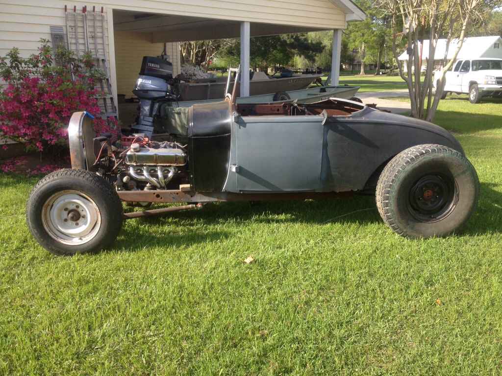

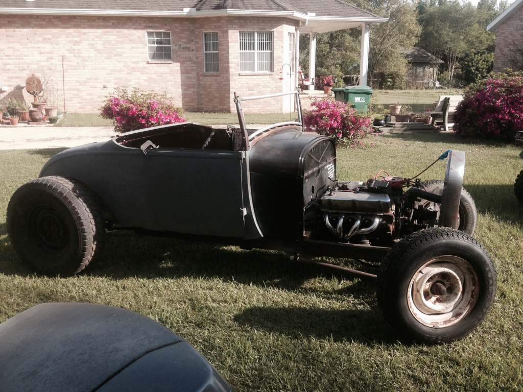

    Here's mine coming together ImageUploadedByH.A.M.B.1428422304.631993.jpg ImageUploadedByH.A.M.B.1428422322.466121.jpg
    In search of 28-29 front subrail extensions

    You'll either love me or hate me for this: Putting a SBF in a Model A cannot be done without one of the following - cutting the firewall and setting the engine back, using a short water pump, or moving the radiator shell forward.
    Coupesters have enough proportion problems without intentionally adding more, which rules out the option it appears you have chosen - moving the radiator shell forward.
    Now is the time to cut the motor loose and move it back so that the radiator shell can mount in the stock location so that the finished car will be proportionally correct. Otherwise it is doomed to a lifetime of awkwardness...IMHO.

    No worries my friend. That problem has already been tended too also. There is a cadillac 390 at the machine shop currently being built to take the fords place

    The grille will be staying exactly where it is and I fit it all without recessing the firewall. Note. 3 inches have been sectioned out of the doors making the body shorter. Stumped me for a couple minutes. But nothing a little thinking outside the box couldn't fix. Those are actually 32 roadster doorskins that have been modified as well

    Looks good to me. Yes, I'd maybe have a different motor to suit myself, but the old builds, especially 50s , were not 100% proportioned masterpieces. That's what gives them iden***y. :)

    I like the way it sits, wheelbase looks good, and I don't mind the radiator sitting forward if the Cad also needs it.

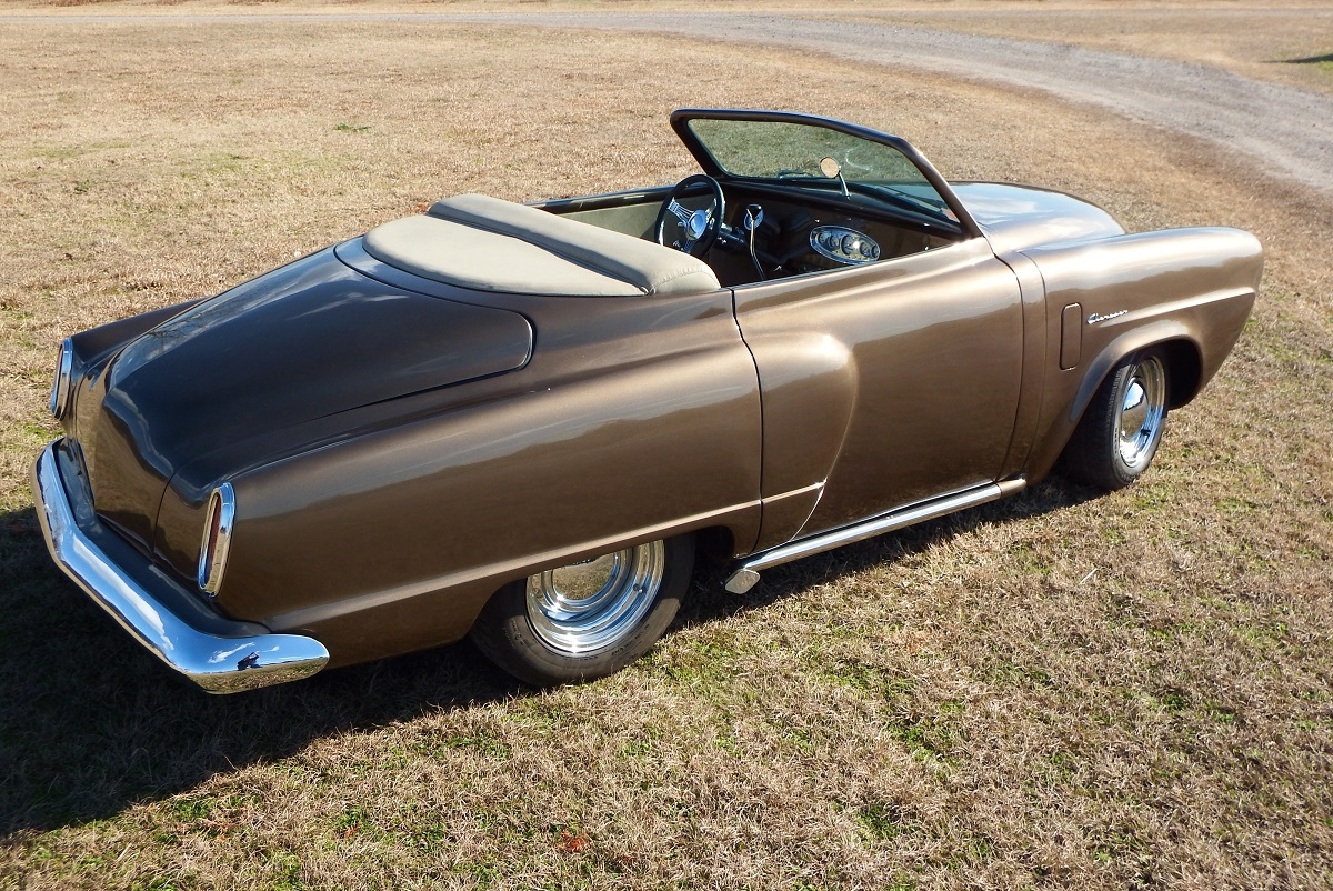

    does mine count ? it was a four door sedan Studebaker now its a roadster :)

    I don't mind the doors and quarters being different, I can live with the post area looking different, but this is the only place where I look a it and go , that's a coupster.
    But all in all, they are nice cars, and if you need the extra room, perfect. But if you don't need it, I would work on that sail panel.

    Yup, shortening the body was an option that didn't even cross my mind! And, I wasn't bad-mouthing the Ford motor, it was what I thought was a lengthened engine compartment that bothered me. Still does, but that's only my very narrow opinion.
    As has been mentioned already on this thread, many of the early gow jobs were not even close, proportion-wise, and yet had a charm all their own. You'll get no argument from me there. In fact, the late '40s and early '50s hot rods as pictured in the Don Montgomery history of hot rodding books are my favorites of all.

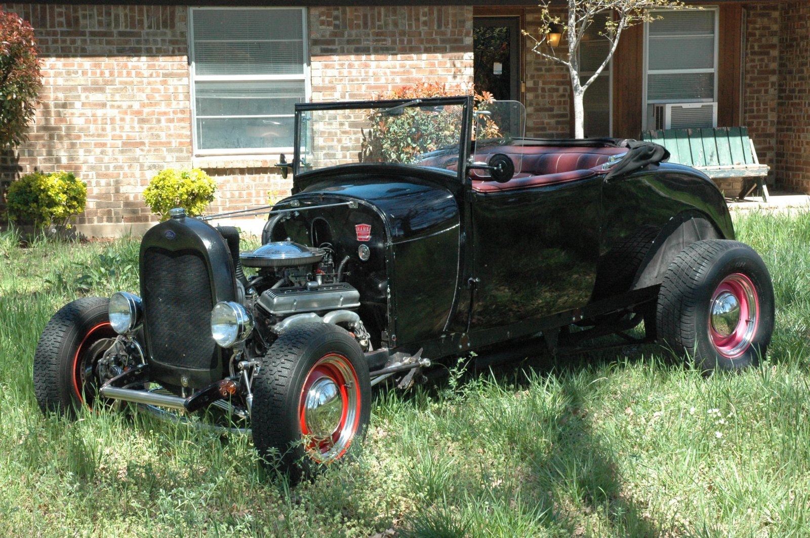

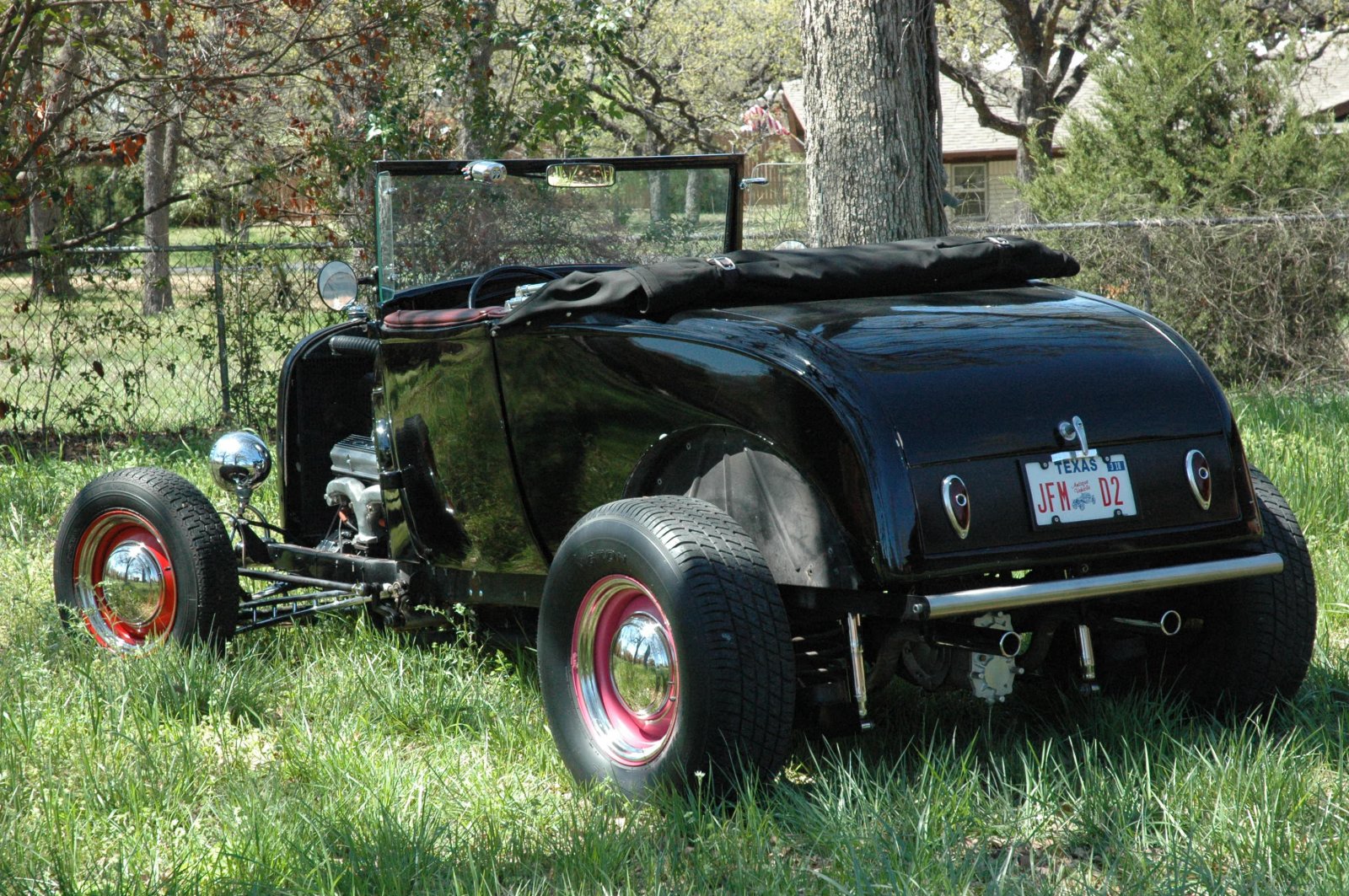

    4 7 2015 (5)2.jpg Iwas liking not having to cover the seat but it might happen.

    Finished it and drove it all weekend.

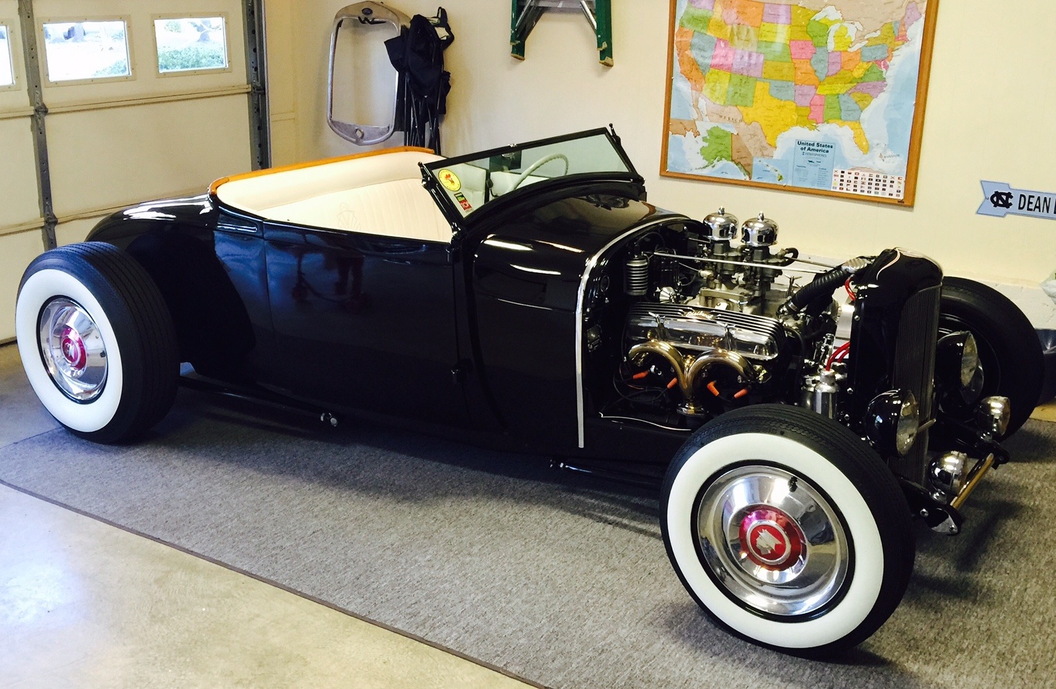

    El Hueso
    Seret Speed Shop
    Before:

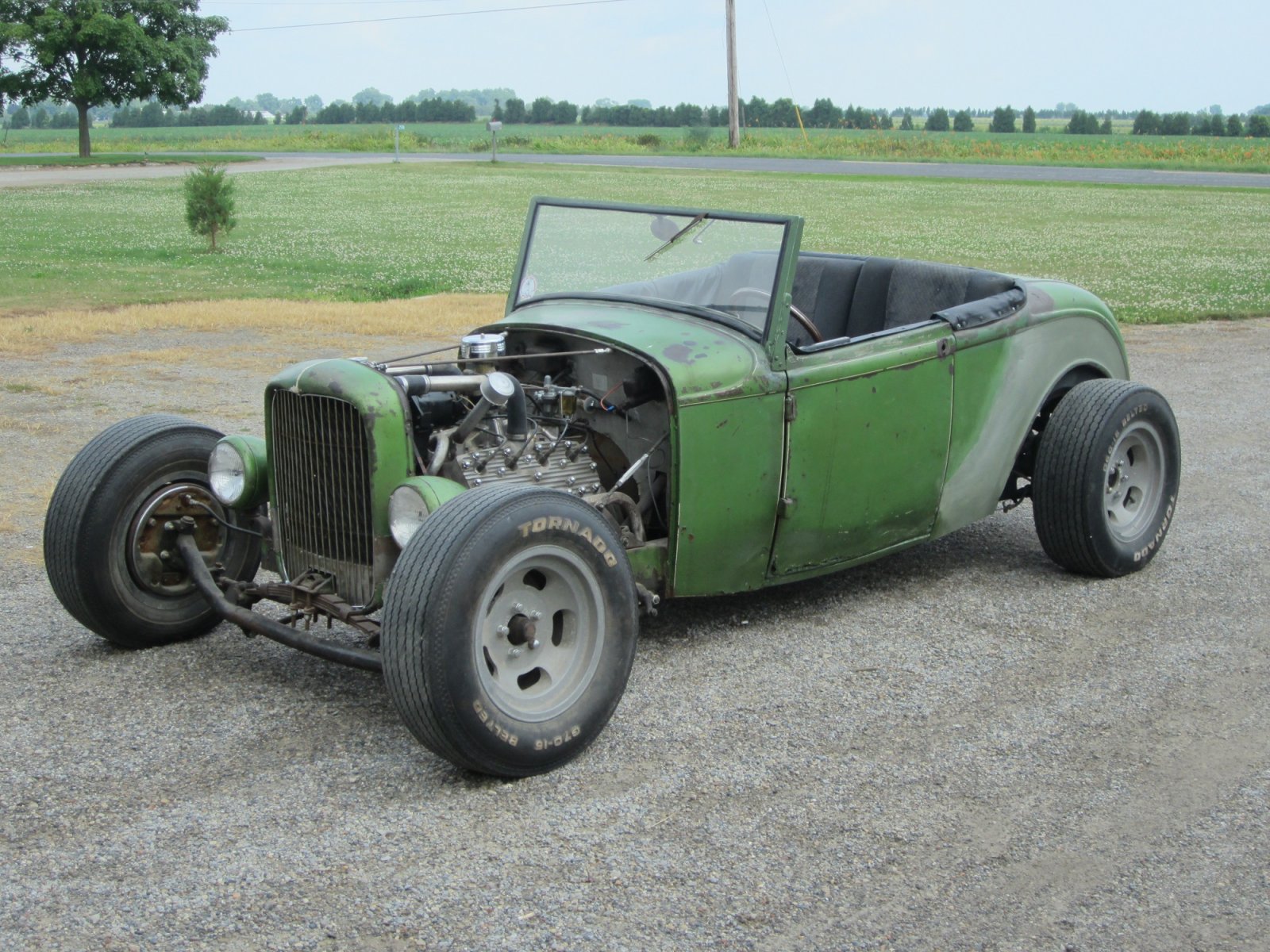

  19. Dago 88
    Joined: Mar 4, 2006
    Posts: 2,496
    Dago 88

    Your car looks much more like a roadster than a converted coupe. Hope to see you at LSRU in April.
