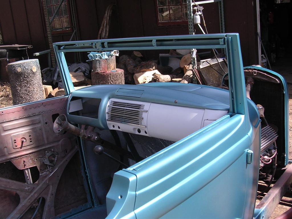

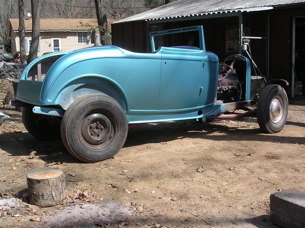

    if roll up windows are OK... mine was a 5w that came to me with a long gone roof. I don't like wind, so I did windows. I quit working on it 2 years ago for some reason(during a lacquer paintjob)

    How did you convert the 5w coupe doors into cabriolet doors?

    Wow! That's a lot of work! Do you have some construction photos?

    Look at the last pic to study the driver door inner structure...look at the front lower corner; you will see a curve. That is a rear inner door (from the opposite side), of a 1931 Dodge 8 four door sedan. The rear sedan doors have a curve cut out for the back fender.
    Then I cut up outer door skin pieces from above the Dodge sedan door window, and pieces below the Dodge window, turned some upside down, to make all the door tops work out.
    It even has Dodge door hinges and latches. I did not have Ford stuff, because someone had ruined my doors by trying to make suicide doors. It was a mess

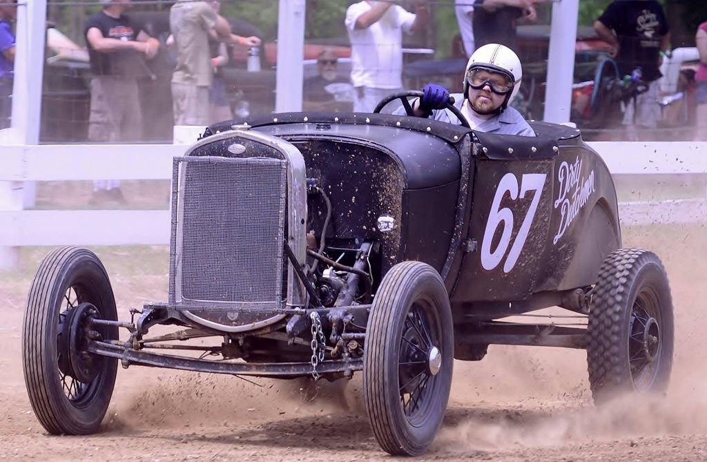

    My 29 race only

    I love it! When I was a lad the roundy-round "bombers" used the same chain anti-sway bar as you've got on your car! How cool is that!

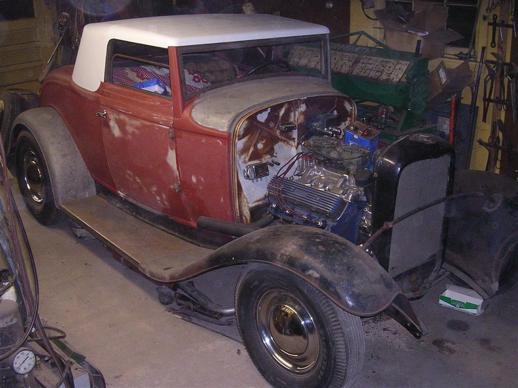

    been awhile since i have been on here.getting ready to start some more work done on mine coupster glad i found this page.i think mine started out as cabriolet .it has a one piece cowl briggs or murray an the doors have been narrowed to . it was an old hot rod from the late 60s then pulled out of a barn inthe 90s someone tried to make a rat rod out of it .now i have it an kind of stuck which way to go with it

    That car looks great. Glad the right guy found it to rescue it.

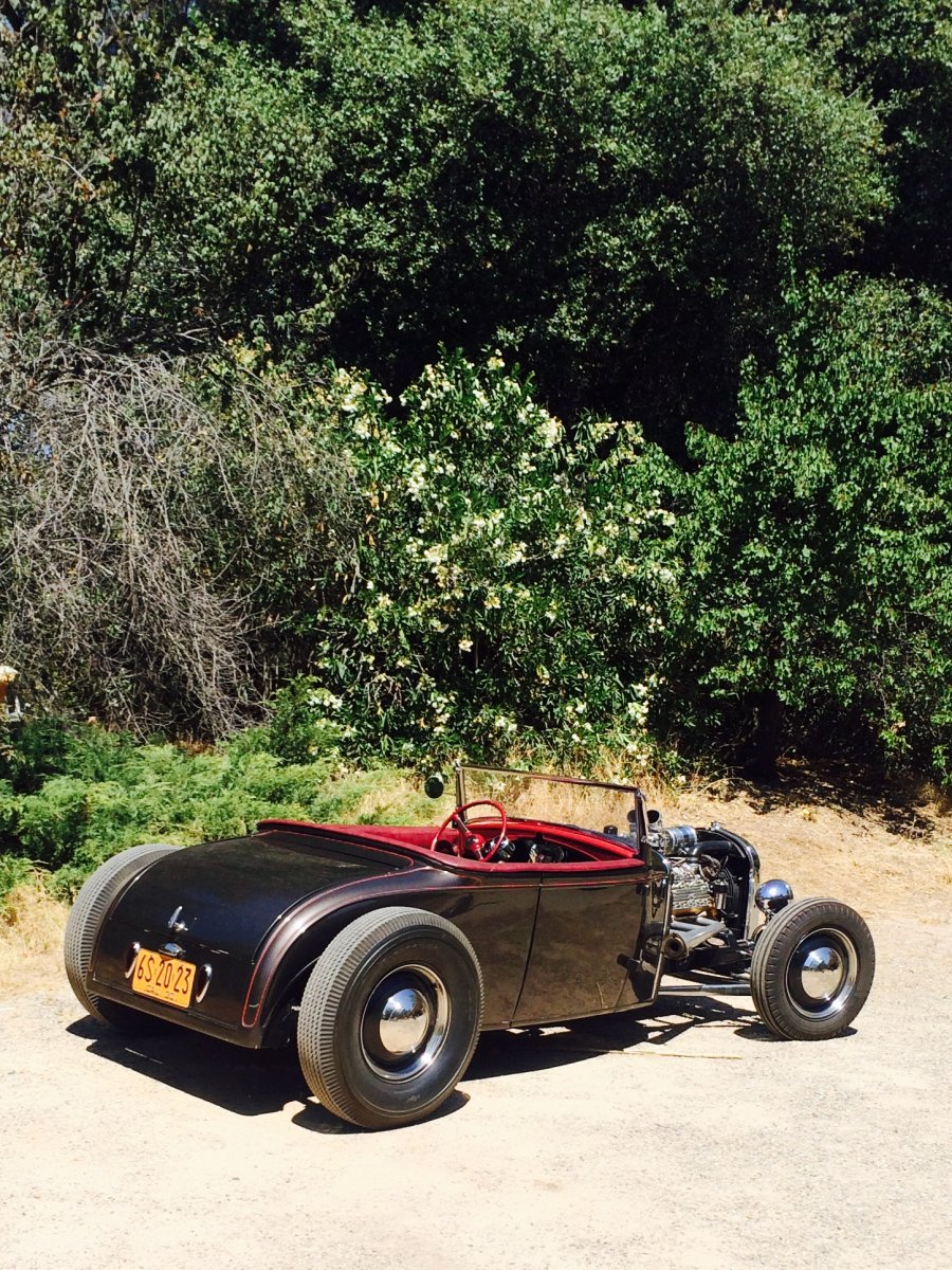

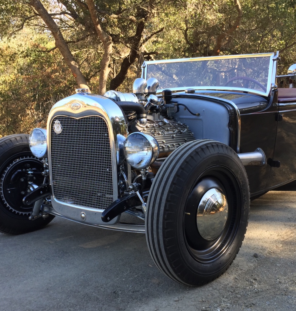

  18. 30 Coupester with shortened posts using 32 stanchions and a chopped roadster windshield. I've rebuilt it twice in the last 3 years and drive the **** out of it on any day its not pouring down rain which in California lately is every damn day :)
