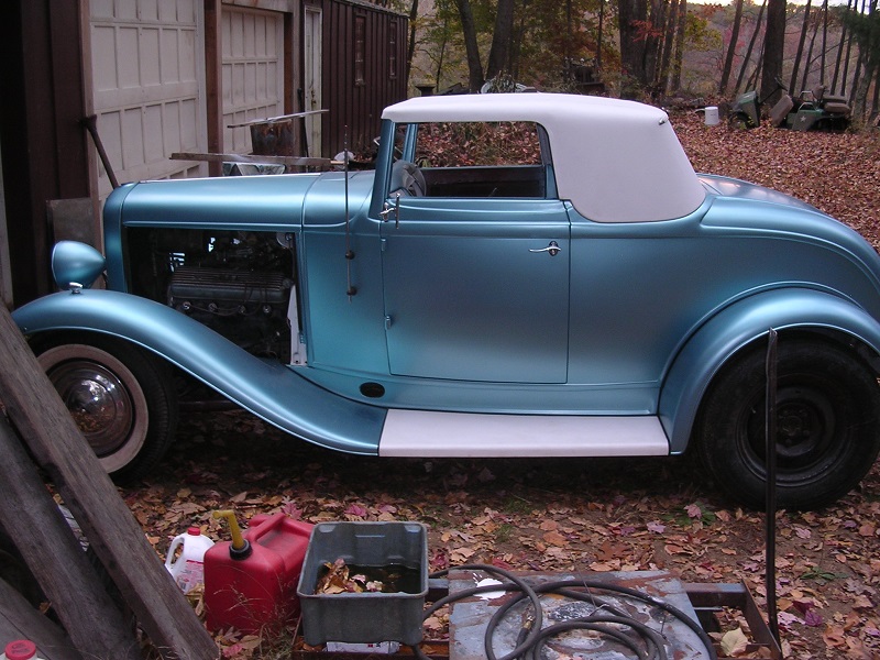

    Yes, today is different than the 40s-50s or even 60s. Back when, hot rodding a car was not so **** and purist. I've even seen a handful of 32 Ford 3 windows that were cut down, only because the builder wanted an open car. These cars had so little comparative values back then, so cutting a good body was not a big deal......heck, they already torched the whole floor and subrails out to channel.. :)
    Today, yes, a "new built" coupster is made from necessity, on a car that can't be saved otherwise, and has so little value to part it out.
    When I got done cutting away all the destroyed pieces of my 5w coupster, I should have quit, but there were almost no panels or pieces that could be sold. In hindsight, mine was far too much work, and hours, but that is partly due to me wanting a 32 cabriolet with side windows, and I could not find one in my budget at that time. Should have waited..
    here is a recent progress pic. Working on it today, but needed a break.....breaks are becoming quite pleasant :(

    You should be proud of that car , man... It looks good... How did you do the top, is it one piece?,

    My top is made from s****yard 1/2" square tubing framework, then skinned with 6 sections of sheetmetal welded together.

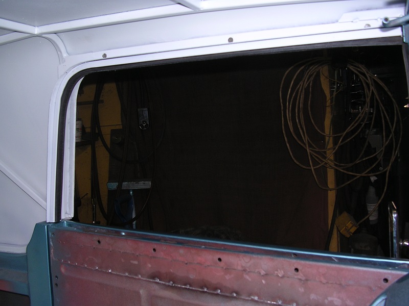

    My 32 body was a coupe shell that had the roof cut off a long time ago. I built the top of each door from the beltline up.
    I made door gl*** frames from salvage 1/2" square tubing. I made twin vertical window tracks from cutting one side off of 3/4" salvage square tubing, lined with black felt. Both of those tracks need to go as far down in the door as possible, and must be 100% parallel. The gl*** framing must fit snugly in the felt lined tracks, but still be able to slide.
    There has to be front and rear lower parts of the gl*** frames to be straight & 100% parallel, and to go down inside the door as much as possible, so that when you slam the door with window raised, it still is solidly held.
    Window regulators need to be a twin arm gear type like used on vintage convertibles, or go with a modern Jeep "center lift" enclosed cable drive to get the gl*** to come up dead straight.
    All of this is not something you can do in a week with lots of beer. "Close Enough" won't cut it when designing this stuff. It takes serious work & thoughts to make it roll up/down like a new car. You also need stops in the door so the window stops at the top without being able to go too far if the door is open, and also have stops at the bottom with gl*** down...and have a factory look of the top of the window frame level with top of the door, when window is down.
    I also built retainers to hold rubber seals into the roof. The roof is solid, covered with cloth.
    window is up here, and shows handmade garnish moldings at top of door panel.below:
