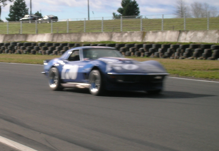

  30. Mimilan
    Joined: Jun 13, 2019
    Posts: 1,255
    Mimilan
    I don't know about that ^^^^ it might sound like a 5 cyl Audi Quattro :D
    We had a C3 Road Racer with 5" side pipes [designed on a flowbench], it sounded really nice inside the car [with a helmet on] but to spectators it sounded like a Plow Tractor, even at 100+mph
    Unless you are running open headers, a single "Big Bore" will make more power. That's why Trans-Am series cars run them.[Aussie V8 supercars have been running them since the 90's]
    They make the engine sound like it is revving a lot higher ["On Song"]
    Duel exhausts with gl***-packs on a low revving street car is as annoying as pulling up beside some rice rocket with a "Boom Box" sound system.
    We actually removed the factory duel exhaust off our 57 Chevy and ran a cross-over "Y" pipe behind the bellhousing over to a single 2-1/2 in exhaust system.
    It now has that nice burble sound that a Y block Ford makes.:D
