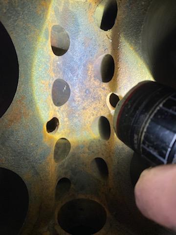

    97058.jpeg This image of the lifter valley is better looked at with your head tilted to the left. This is the major one in question that they say might be the block killer. Anybody agree or disagree? What would happen if I built it anyway? Are we in danger of blowing up? Catching on fire?

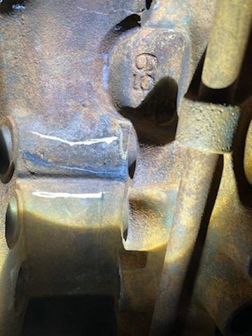

    97060.jpeg This is a 'gouge' in a lifter bore according to the shop.

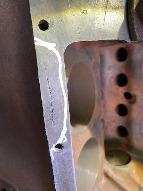

    97056.jpeg Crack along the oil pan sealing surface.

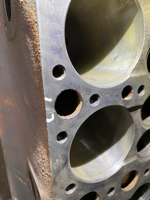

    97057.jpeg Dent in the deck. 97059.jpeg And finally another oil pan area crack.

    Any of those cracks that lead to water will need repair at the very least. But, with so many cracks I'd say that you would be wiser to find another block. There's no way you could "run that as is". It would squirt out every side of the engine.
    But, the little gouge in the lifter bore wouldn't scare me, so you are safe there.

    The first pan rail pic crack has two possible solutions... drill the ends of the crack and then "v" the crack a bit and fill with JB Weld. This is supposed to work as the crack is only on the gasket area of the rail. Another tip I heard from Auliz in Sweden is that you can add some cement down there to close it up. He says that it is so low on th eg lock that it would not affect the cooling system. I've never tried either way but I'm intrigued.

    A crack along the pan rail probably indicates the block was lying around outside full of water and froze.

    I agree with Petejoe. To me, those cracks indicate the block froze, expanded, and cracked. The lifter valley crack and the pan rail cracks all go to the water jacket. Pressure checking the block would tell you if those cracks go all the way into the water jacket (which I bet they do). Personally, I wouldn't waste the money trying to fix that block if I could find another one.

    Those pan rail cracks are the death knell of this block. I wouldn't put any more money towards this flathead block as there are just too many cracks to deal with and it will always be leaking coolant. Load it up on your truck and head down to the marina. Maybe someone down there could use a good boat anchor.

    I have a flathead I got in trade that had all the machine work done and a new bottom end in it, but it had pan rail cracks slightly bigger than yours pictured. I had nothing to lose, so I did what fortunateson said, veed them out with a dremel and packed them with epoxy. I put a few thousand miles on the motor over the last few years with no issues. I run a 4 pound radiator cap.
