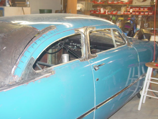

    Here is a quick update on some of my progress :) Got the window surrounds done on the Drivers side. Hope to have the p***enger side done tomorrow. :)
    Still got lots to do, but Im chugging away to be ready for Mooneyes.
    Ill take better pictures tomorrow.

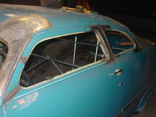

    Alright, more updates on the HAMB Chop Shoebox.
    Got the p***enger side done and a vent wing chopped down.
    whew...this is alot of work. :)

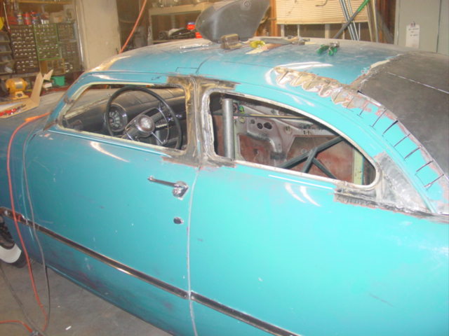

    Okay, more updates, but no pictures.
    I got about 1/2 of the rear of the roof welded in.
    Im Mig welding the lower section since its pretty straight. As for above the window, im TIG'ing it in so I can "Hammer Weld" it, to move the metal around to keep from getting low and high spots.
    I would say by next weekend, I should be doing body/prep work on the roof area.
    Ill post picts tomorrow.
