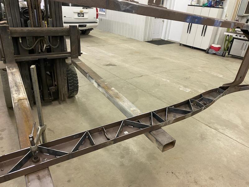

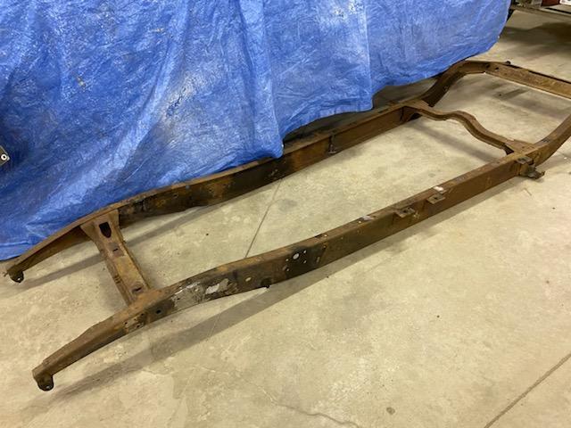

    This is the frame of my 31 Chrysler it wasn't boxed but this is how we boxed it in and as far as wood in the car there was a wood frame around the inside of the rumble seat lid there was some wood on the inside just two tack interior too it was not structural and also a piece between the Body and Frame

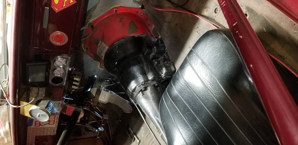

    727 clutch-flight. Modified to run a clutch instead of a torque converter. 20201006_145440.jpeg

    This has always intrigued me.
    The only other "clutchamatic" I ever saw, I think was an early 70s Olds 442, Hot Rod Magazine I think. The owner said it shifted quite violently.
    How's yours?

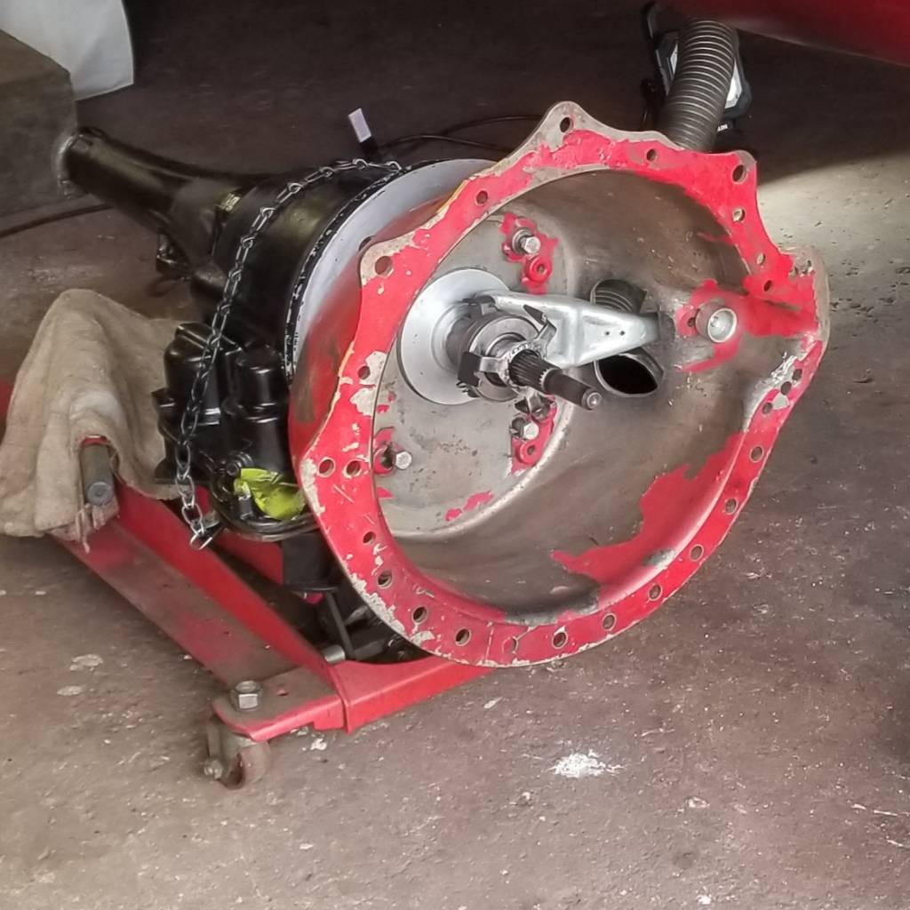

    What clutch you run in it seems to be the big difference in mine. I have a Borg and Beck pressure plate with a 10.5 clutch disc. Went with sintered iron this time. Offers a little bit of slip on clutch release. Not overly street friendly. But it gets the job done. 20200402_122231.jpeg 20200328_121826.jpeg

    Where does a guy get a input shaft these days I need one for my clutch flight as it is broken I have everything else

    My set up is a Winters. It was made here in Pa. Jim Kramer built my ****** with A&A transmission guts. Went with billet drum and 4 pin planetary's front and back. Here a pic of mine on the rebuild table. He has some stuff. I dont know the difference between the B&M and Winters kits as far as the input shaft goes. Give him a call at Kramer Automotive, tell him Troy Kennedy sent ya. Really nice people 20200201_145221.jpeg

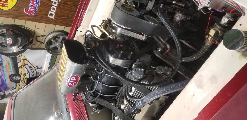

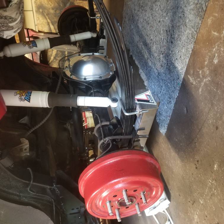

    Thanks for the compliment Slayer. Lil off topic, it has a 426 HEMI, blower, mechanical injection. Moved front wheels forward 9" and the wheel well frwd 8". Rearend moved back 2" and mini tubed. Recessed the firewall to move the big Hemi back enough to put a radiator in it. Used 4 speed shifters for the brake and clutch levers. Been a fun project. Be happy to get it out and drive it next year. 20200310_161818.jpeg 20201025_154642.jpeg 20200912_172932.jpeg

    Blown, injected 426 Hemi off topic? Not to me it ain't. Totally *****en ride

    A blown, mechanical injected Hemi backed by a Clutchflite in an altered wheelbase Dart with leaf springs, ******* bars, and drum brakes. Totally insane! I dig the hell out of that.

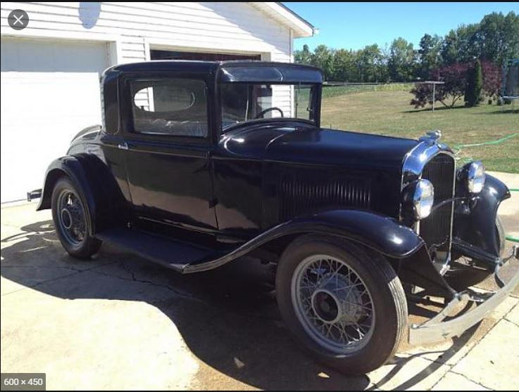

    my good buddy in High School had a 32 Plymouth coupe. once when speaking to someone else he said "my Dad and I restored it until it was junk", of course he meant it was junk and they restored it, I used to like to remind him of that at every chance I got. I always liked this body style, they are very cool looking cars.
    this ****py photo is his actual car for sale at a cl***ic car dealer after he p***ed about 10 years ago that I found online. it had a pinto motor in it at the time, the original motor grenaded years ago. I wonder whatever happened to it? had a 32 ford 3 window as well.
    in High School I always ended up in the rumble seat since our other buddy was too pretty to mess up his hair sitting outside.
    here's a better shot of a different car to show what they look like in a better picture.
