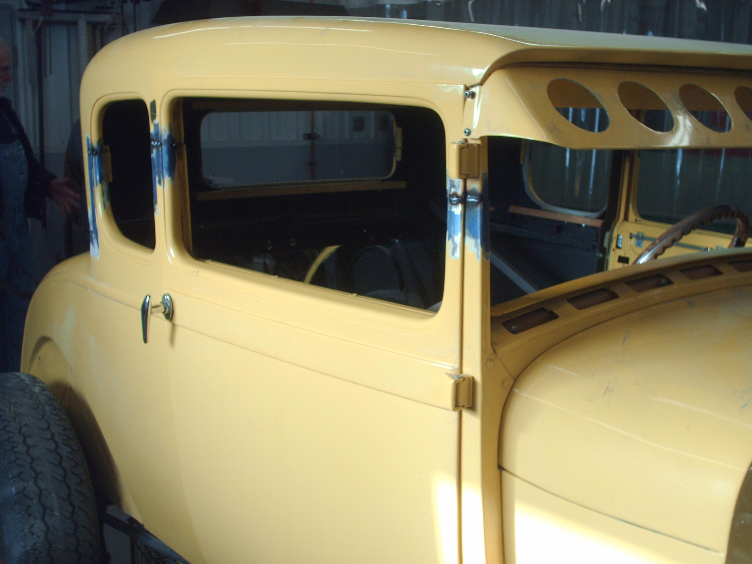

    Here's a couple of shots of my buddies truck with a 3" chop.

    use two cabs you will have less seams to deal with, if done right you should have one seam above the rear window and you wont have to put a strip in the middle of the roof. good luck

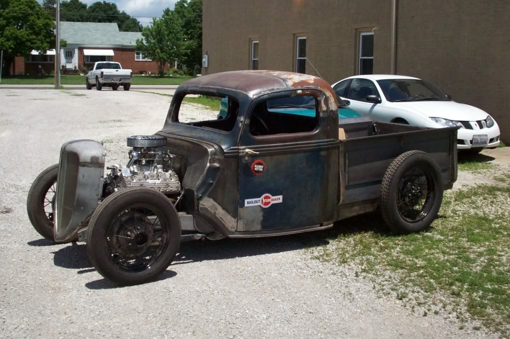

    2 roofs makes it lots easier, this one I dint have much choice as the drivers door opening had had its *** kicked at least twice. What ever did this pushed the door opening so far out of whack that the door overlapped the opening by 1"
    Since I had 2 roofs and was doing both acrown chop and a normal chop, I did it in halfs..
    I took 1 1/2" out above the driprails,
    And another 2 1/2" out of the windows
    Fronts done, now for the back
    I cut the skin loose on teh back and finished the door frame first, and added a brace to tie the door frames together, and to help brace the suicide hinges. Also made a nice place to mount the shoulder harness/seatbelt.
    Then it was just a matter of setting the new rear roof on and t******* to fit.
    Keep your gaps tight, and use lots of clamps.
    **** weld the seams, use steel filler rod! This will allow you to bump everything back into shape and not need much if any filler.
    Also when cutting the skin, try and cut AWAY from any structure on the inside. This makes it lots easier to get dolly behind it. I try to round the corners of the seams too, this helps keep the heat more even when welding.
    On a truck it ok to cut and seam just about anywhere, with the windows out you can reach the seams with both hands anyway. Car roofs are whole nutter fiasco..
    Finished (well almost finished) product, its at body shop now getting shiny paint!
