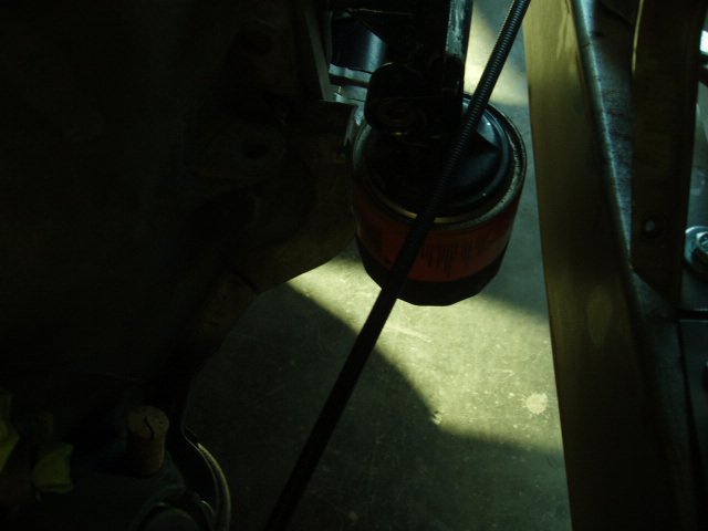

  7. jmurrayent
    Joined: Nov 11, 2008
    Posts: 61
    jmurrayent
    from Reno, NV
    Here's a pic of the Wilcap adaptor I used to bolt the TH350 to it. It worked slick, but pretty pricey at $600. FYI, I believe '62 390 is the only year with the screw on side of block oil filter whereas the '59-61 take the from of block canister. I could be wrong, but they mad the switch somewhere in there.....

  12. 60 was the 1st year for the side mount oil filter and with Pat's adaptor you will have to "notch" the trans bellhousing to clear the trans or remote the oil filter. Kind of dark but you can see the notch.
