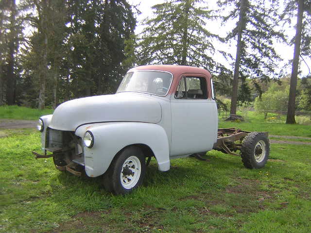

    Leonard, I already have the axle. I got it secondhand from a fellow hamb'er. Trying to find time to install it between selling a bunch of stuff to buy that engine. Plus my buddy is out of gas for his torch. *Maybe* next Wednesday we'll get it in the truck.
    Apples to apples, you're absolutely right. Rare is as rare does, lol. And rare is expensive. But...I've always heard...you've gotta spend money to make money.

    believe me it was a long road deciding to go with the AT, and I still waffle about it. my avatar has a 4 speed and I'm fundamentally a three pedal guy.
    the truck is a chopped channeled 34 ford that, when last on the road, was about 38 inches from floorboard to roof (not headliner--roof). I'm 6 feet and 275, fat feet arent the issue, fat ME is.:eek:
    I'm just not sure I can work the pedal in that space--it was an easier feet when I was 16.

    I hear you falcon. I've almost always had a manual. This will be my first auto in years. Well, I take that back. My '63 pickup had a slip'n'slide. The hydro I'll use is freshly rebuilt and the price is right (thanks JJ!!). Its just the easiest thing to do for now and I hear they're plenty stout. Makes sense since they were put behind the 390 from t he factory, lol. Hopefully the rad cad under the hood will make up for the auto hydro under the floor!!

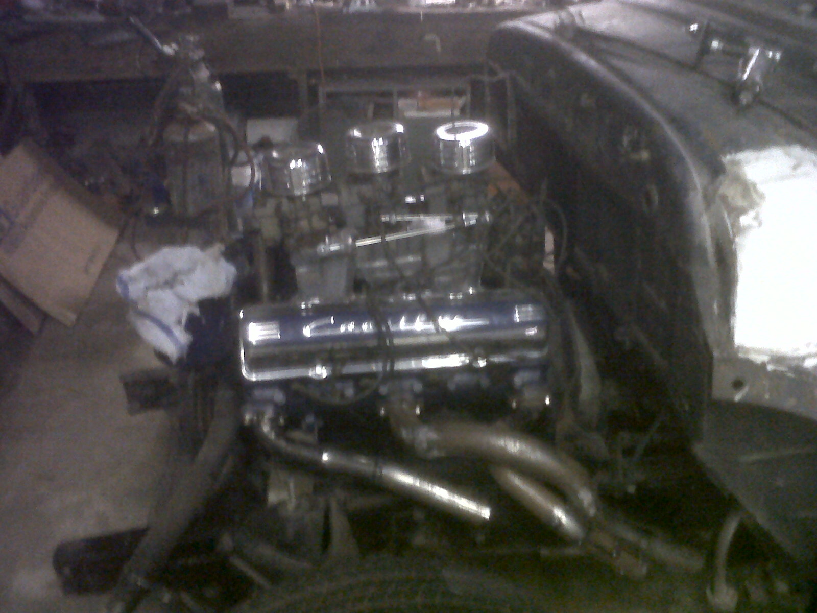

    We did all the machine work for the Ray Zeller built 331 that i believe is going in the So-Cal Speed shop roadster for a certain three piece rock band member. JE flat tops,Smith Bros. pushrods, (i was the shop foreman for four yrs. when Doug Smith was alive). changed the C.D. and wrist pin size, offset the wrist pin bushings on our Tobin-Arp pin bore machine for .000 deck for req. comp ratio and better quench. custom cam, cylinder head mods etc.
    We are working on another 331 for a 1950's vintage allard xj which Lime Works is restoring. those guys are amazing! this one's going to be kool. JE domed pistons, magurk adj rockers, 6 97's the list goes on.
    If i can help with any questions let me know.
    Chris

    Ray zeller knows how to build one mean motor. He builds the big block chevys in our racecar and they haul *** and last forever.
    Got any pics of that 331??

    This is a beautiful piece!!! I love it!!
