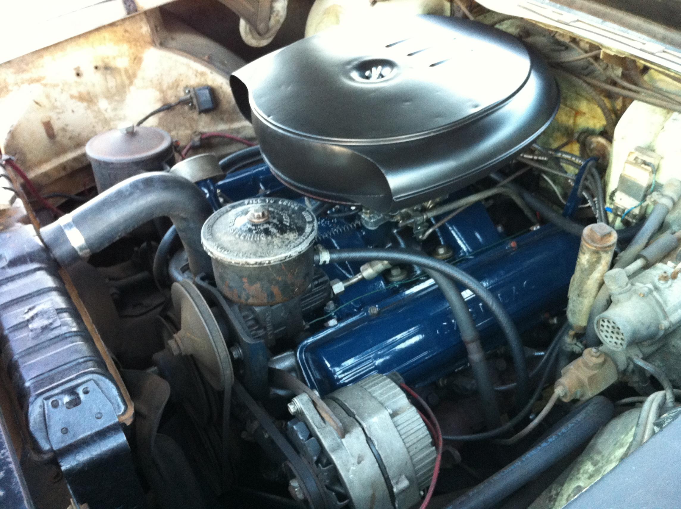

    Here are some pics of the original 365 in a 57 cad that got this last summer. The first shot is the motor the day I brought the car home, the other pics are ones I took of the motor today just because I saw this thread, great thread too!
