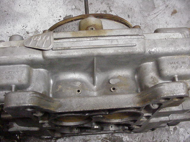

  1. Have a couple of 1964/65 MoPar AFB carb's that do not have the weighted air valve on the secondary side... I mean they never had one from the day they were manufactured. The secondary boosters are attached at the sides rather than at the back. Every other AFB I worked on had the weighted secondary air valve and the bosters attached at the back.
    Is this setup common?
    Are there other years / applications that are that way also?

  4. They are AFB's. I know the difference between AFB and AVS carbs... AVS have a spring-loaded air valve over the secondary side. Also, AVS carbs weren't around yet in 1964/65.
    When one looks down the air inlet opening of the subject carbs, they can see the secondary boosters and below that the secondary throttle plates. No air valve whatsoever - counterweighted nor spring-loaded.

    I also have 3644S and 3871S carbs. When looking down the air inlet, you can see what I was talking about. The second picure shows another wierd feature... ~1/16" dia holes in the carb below the booster venturis but above the throttle plates. These holes go out to unfiltered air...:rolleyes: One hole for each venturi and they are on every one of these carbs - so they aren't someone's "improvement"... Any idea what are those holes for?

  14. Yeah, but does anyone know what these holes are for?

    The small holes are "vapor vent holes" that supposedly helped with hot engine starts. I've seen these on mid 60s AFBs; I don't know if they worked or not... party at flamedabone's house? Later Frank

  17. Thanks for the replies. I recently discovered that same chart is also in the Carter Carburetors book that I have. Unfortunately, there is no discussion in that book about those mystery holes. The vapor holes sounds likely, but it seems also like a place to suck in dirt.

    Chrysler used AFB carbs on many of their SINGLE QUAD applications sans auxiliary air valve. I don't remember if ALL of the Chrysler dual quad applications used the air valve, but most (possibly all) of them did.
    The holes below the booster have the same function as the "looped" throttle body gaskets used by Rochester, to improve drivability in very hot city driving. Here is a link to an article with original Rochester documentation that I posted several years ago:
    http://www.thecarburetorshop.com/Ventedgaskets.htm
    I would not suggest using the carbs without the auxiliary air valves in a multiple carb application.
