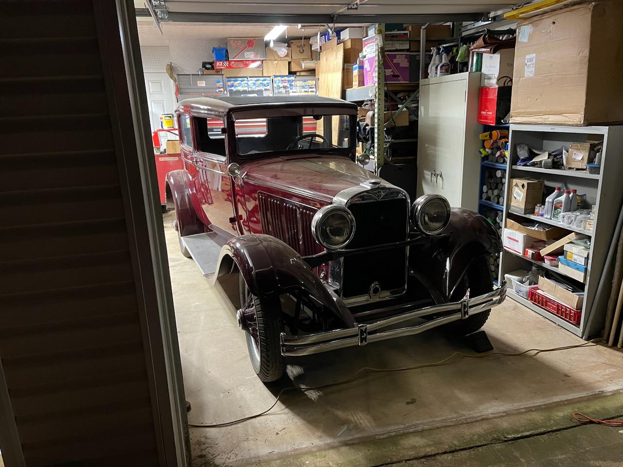

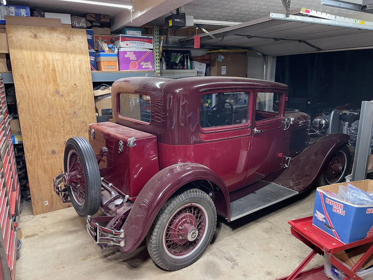

  1. Well, it's only taken another 6 years, but Dad's '28 Victory Six is in my garage and ready to be gone through!!!
    Dad and my oldest sister will be visiting in May for our middle son's graduation and daughter's 8th grade commencement, so I'm trying to get the car running and driving.
    Dad NEVER got the opportunity to enjoy the car after the exterior was restored 30 YEARS AGO (long, ugly story including the interior being lost for most of that time). I won't be able to get the interior done, but some blankets wrapped around the seats will work just fine.

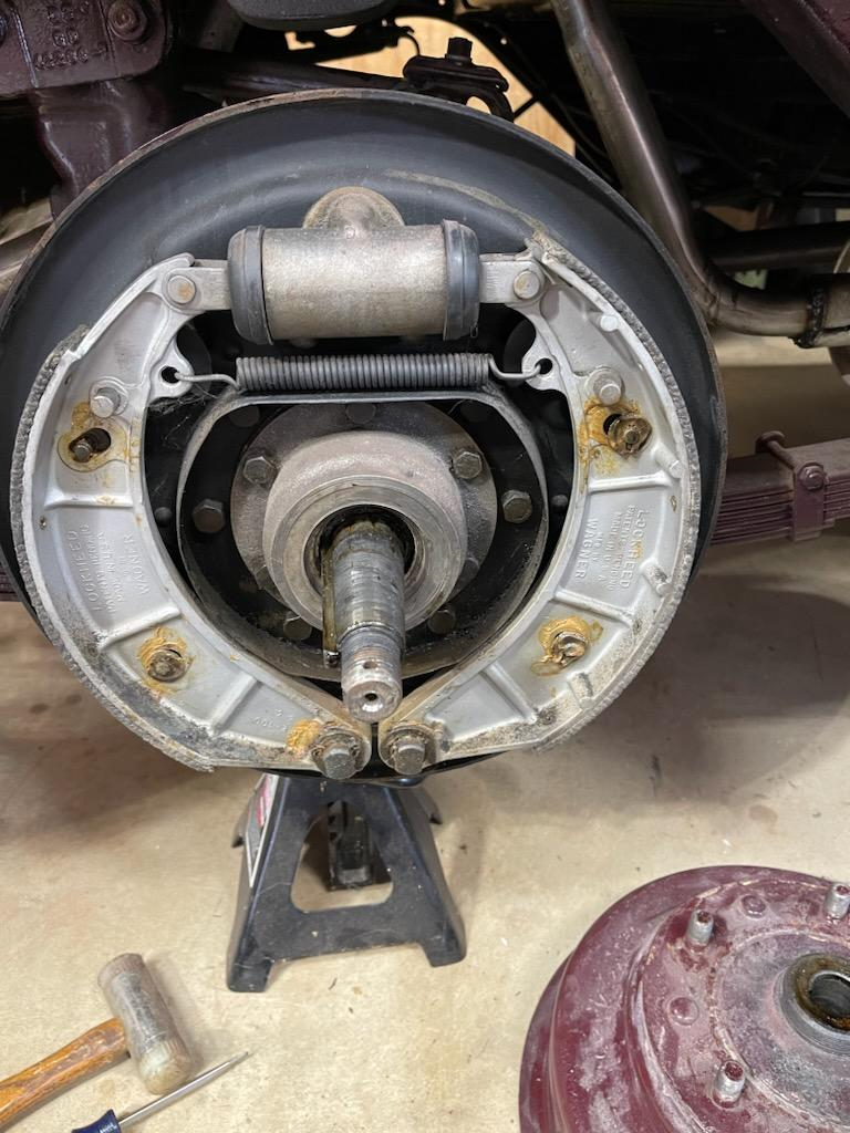

    Pulled the drums and checked the master cylinder- just about empty and one of the front pad springs was broken... will see if NAPA will have a replacement (the brake cylinders match early Divco, so there may be hope)!

  4. It's pretty dusty- will get better pics when it's clean :D

  20. Alright, time for an update-
    The wheels are off to work on the brakes and the carburetor is cleaned and ready for rebuild, but I could use some help in a couple of areas- if anyone has ideas, links, contacts, please let me know:
    1) I'm having trouble finding horseshoe clips and springs for the brakes... those spring ends are NOT clocked like modern ones, they are in line with each other- these are EARLY Wagner Lockheed hydraulic brakes (part of Victory Six experiment)

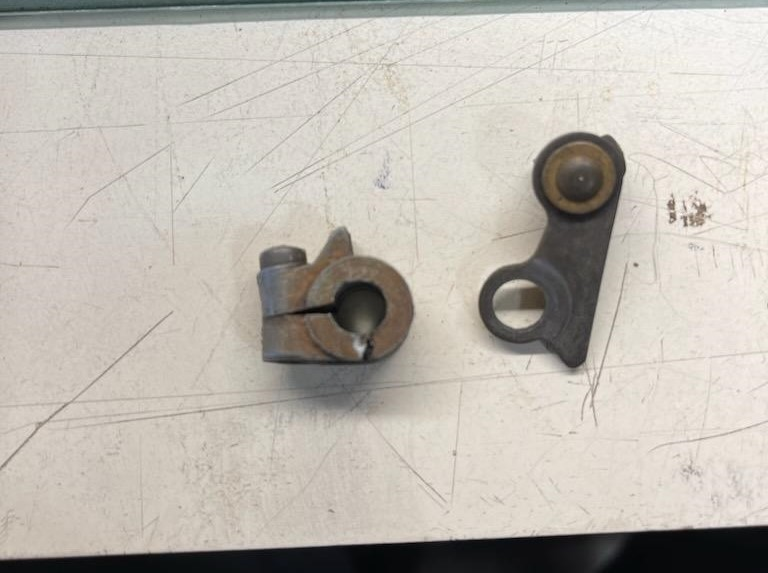

    2) Part of the Carter BB1D linkage is broken... trying to find a replacement:

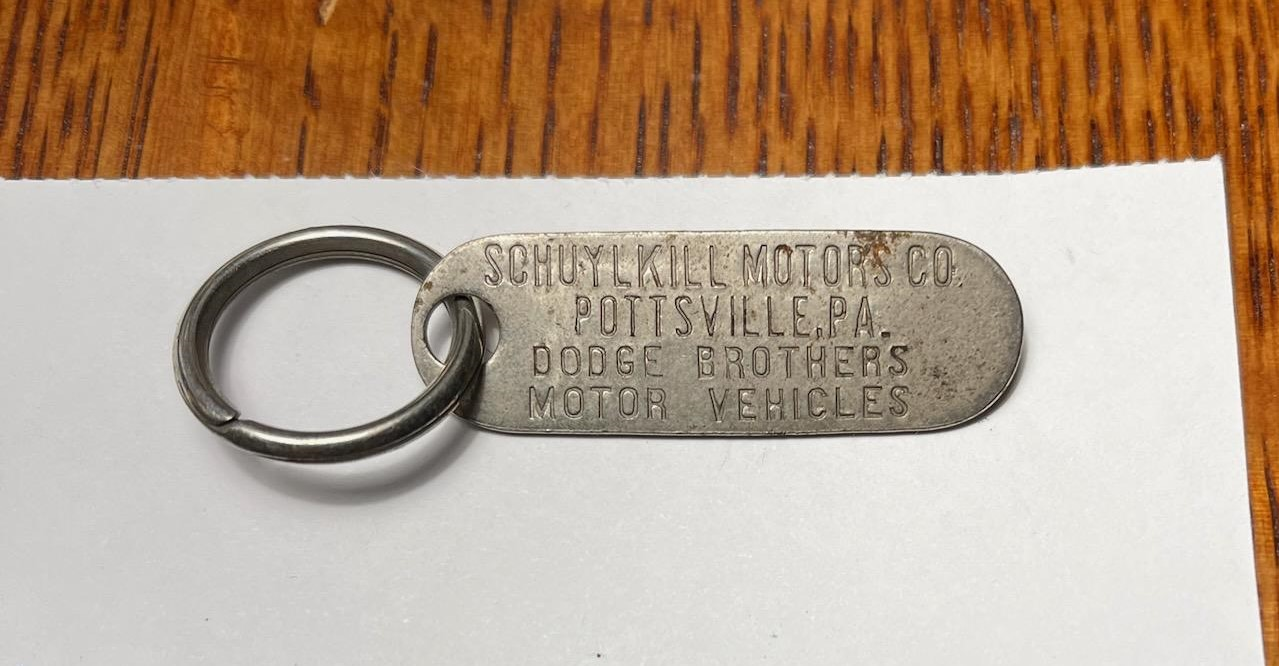

    On a happier note, a good buddy of mine was at the Charlotte swap meet and found this for me- I grew up about an hour away from Pottstville and drove the Schuylkill (pronounced "school-kill") expressway every day (and rowed on the river for a year :D), so this brings back LOTS of great memories!!!

    And I've been saying "Sky-Kill" for all of these years. Thanks for the pronunciation, Mac, and good luck with this, I've been watching from the start.

  28. Latest update:
    - Carb is rebuilt and waiting on the throttle shaft cable pull from Ohio
    - all brake clips and springs ($49 plus shipping for four freaking springs :confused::eek:) ordered and on their way
    Now, I just need to find the time to:
    - hone the brake cylinders and blow out/bleed the lines
