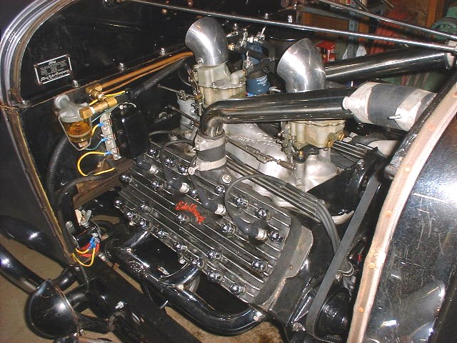

    I've got the Max 1 in the tired old standard bore/stroke 8BA in my 29 AV8. The engine was not rebuilt; I relapped the valves and have 100-120 psi compression across all the cylinders. 8:1 Edelbrock heads redomed by Ol Ron, a set of hollow adjustables with Red's Lincoln valve springs & inside the frame headers running through a pair of Smittys, crab distributor, standard Mellings oil pump, aluminum timing gear, gravity fed from the stock Model A tank with Edelbrock Super intake and a pair of 94's. Running a 2.8:1 1st/ 1.6:1 2nd ratio 39 3-speed and the stock Model A 3.78:1 banjo with 750's in the back.
    You can't really hear the lope when it's running through the out the back Smittys but it sounds great when the lakepipes are uncorked. The engine has plenty of low rpm torque and pulls strong at 70 mph on the interstate. I've had my share of over-cammed engines. If I did it all again, I'd do it all again :)
