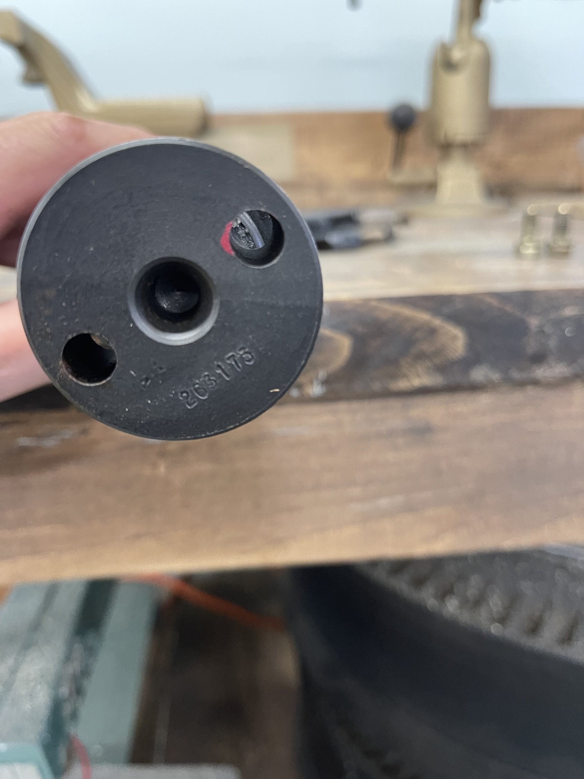

  1. I picked up a newly rebuilt 348, from an estate. I want to put a little hotter cam in it, so I took this out guess it is stock replacement? maybe IMG_0939.jpeg IMG_0941.jpeg IMG_0939.jpeg IMG_0944.jpeg IMG_0939.jpeg IMG_0941.jpeg IMG_0944.jpeg a longshot but there are some smart folks here.
    Thanks, Tim
    Cam number 263173

    With a part number like that I would guess it a stock replacement cam.

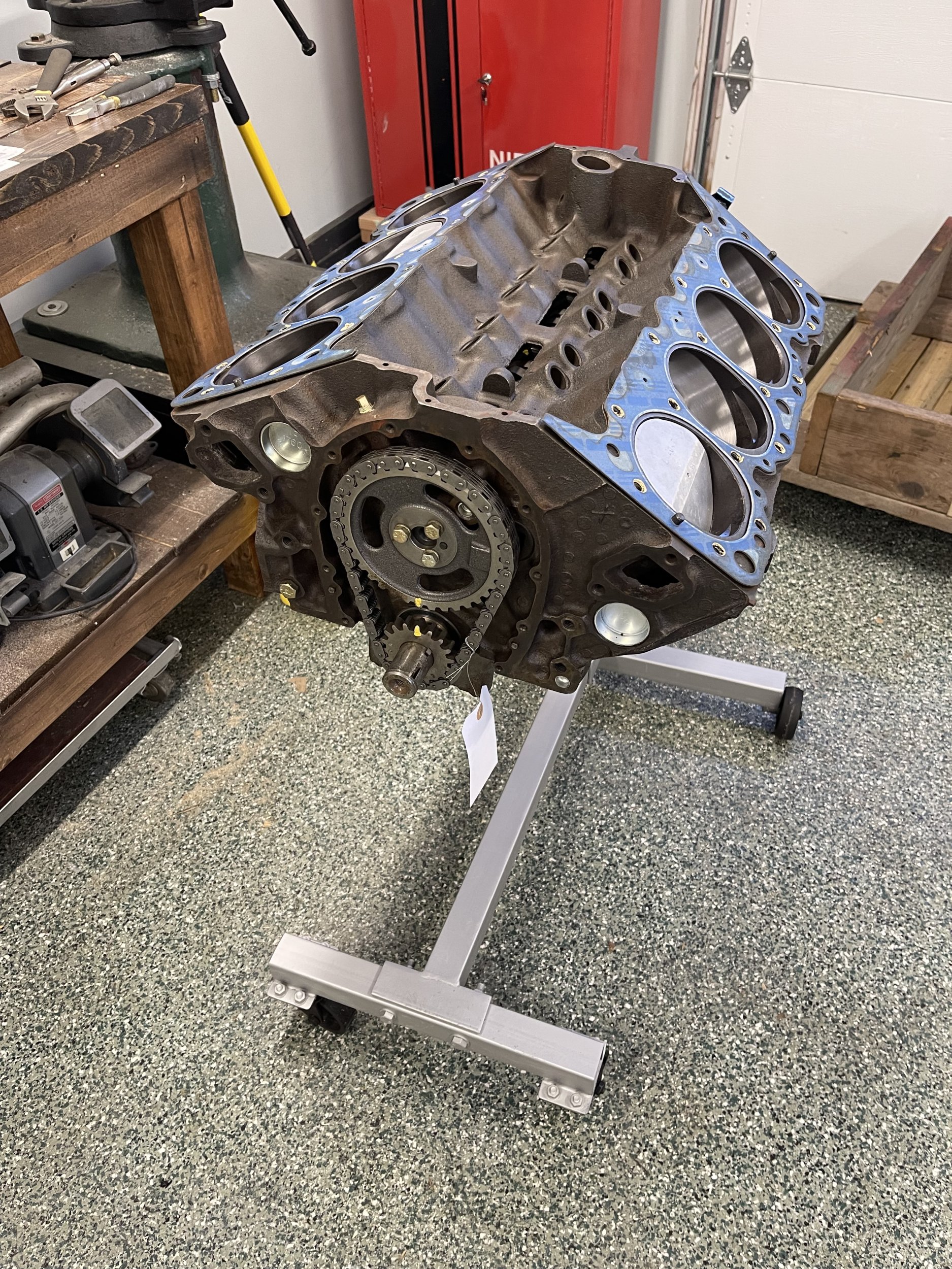

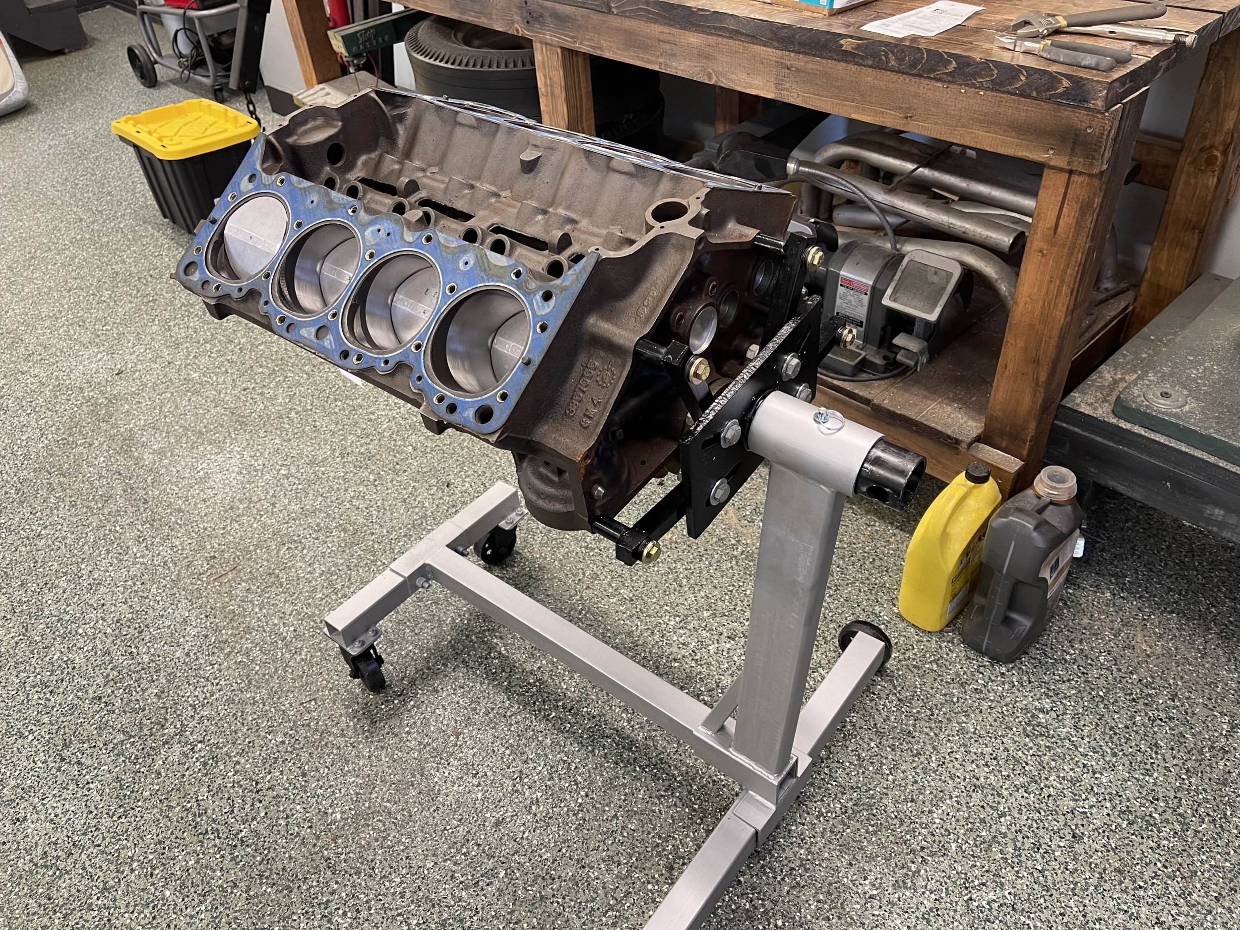

    I think that's a 409 truck block and not a 348. Based on the X on the front of the block, the big relief cut at the near the deck, the casting number on the back (I could be reading wrong) and then the drilled and tapped holes in the p***enger side of the block near the timing chain cover bolt holes.
    But rule of thumb with the un notched pistons for valve reliefs is 220 degrees at .050 and a 110 LSA is the biggest you can go without clearance issues. That at least for the lower hp 348's, should be similar on a 409

    You dont have valve relied in the pistins so you know the intake/exhaust duration on a 348/409 is limited .555 or less.

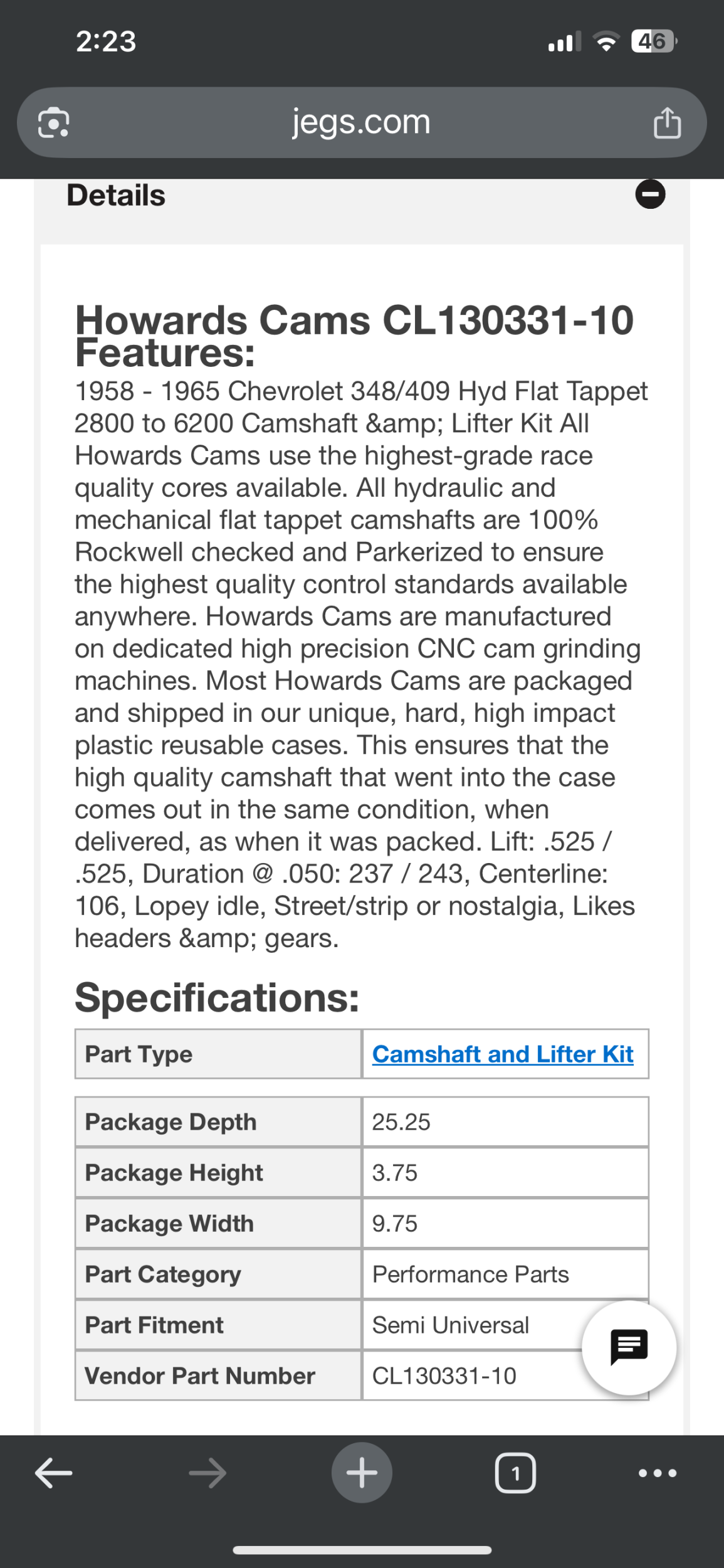

  9. yes, want to go with better than stock but not too radical

    It looks like a 655 block, which is one of the better 348s. Showcars can probably fix you up with a mild hydraulic like their 908 or 911 to keep it mild, make sure you get some quality lifters.

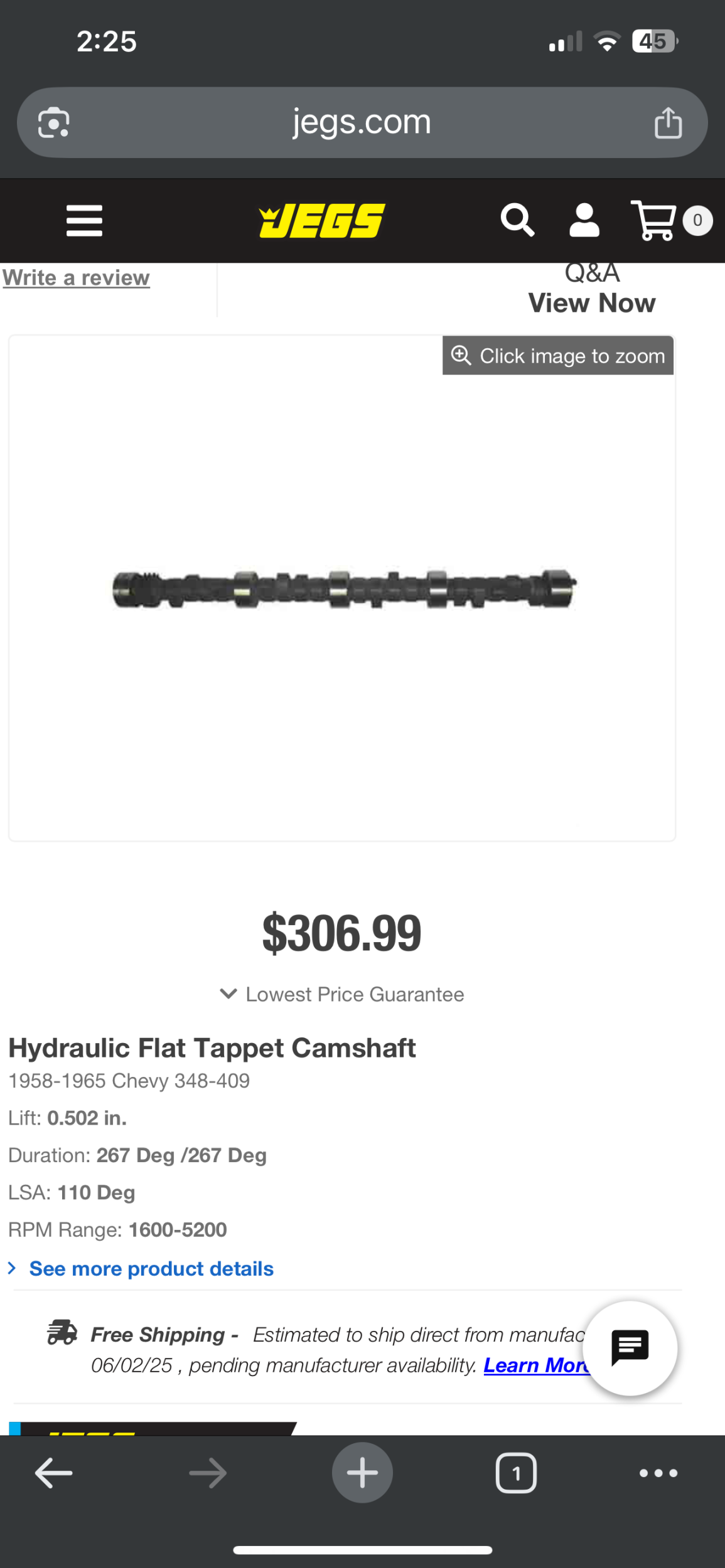

  11. I hear Melling makes a 409 / 340 hp replacement that is in hyd and will lilely not have any clearance issues. It is a 655 block.

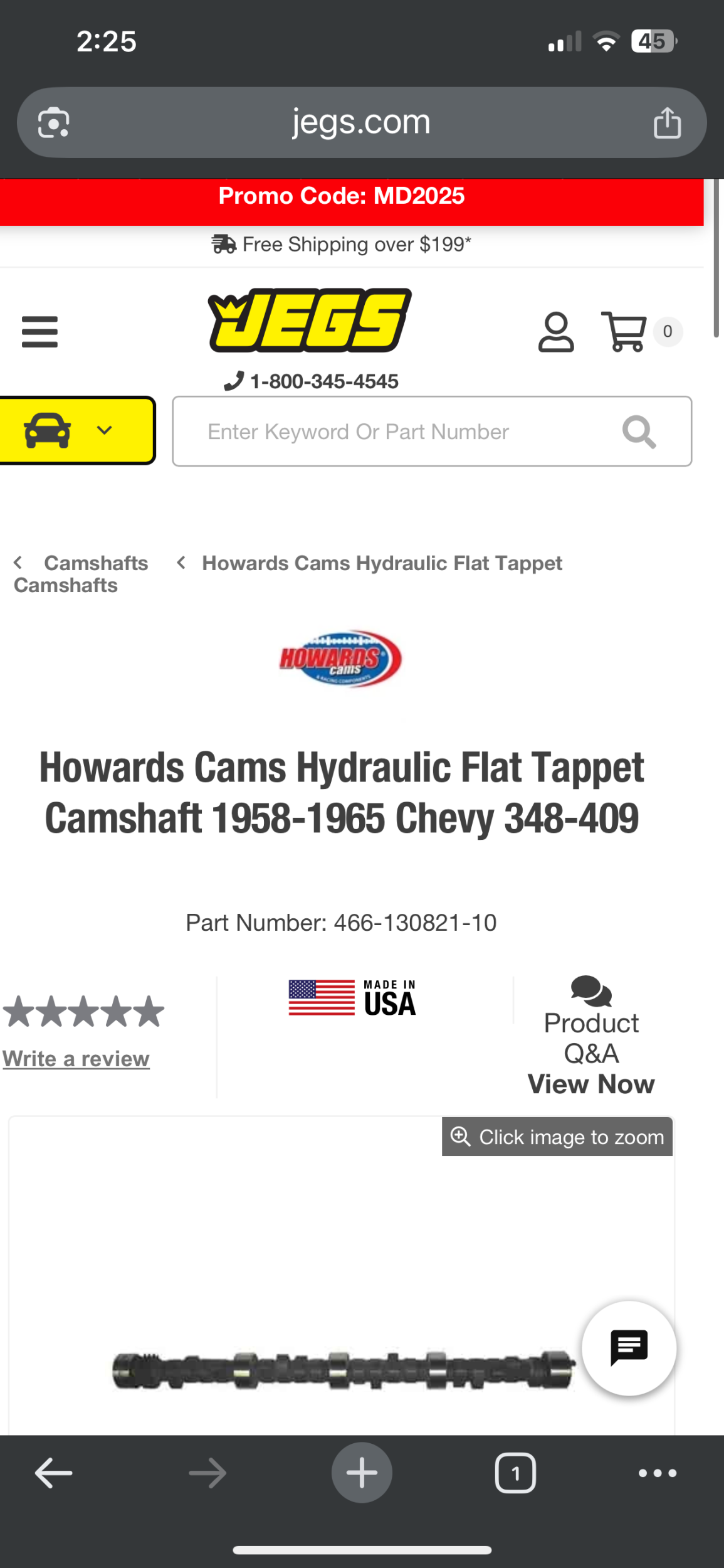

  13. what do you think of the ones I posted above? thanks!

    Looks like a 409 truck block.

    348 truck block. A 409 would be a 656.
    I'd back off the Melling, you would fall asleep with the it. The SC/Iskys are a little pricey. You might also call Camcraft and see what he can whip up for you. You could play it a little safe with the Howards by running BBC 1.7:1 rockers JIC.
