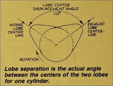

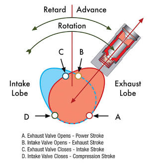

  18. Sharpone
    Joined: Jul 25, 2022
    Posts: 3,397
    Sharpone
    Some diagrams that show what LSA is
    Dan
  19. chicken
    Joined: Aug 15, 2004
    Posts: 690
    chicken
    from Kansas
    Lobe sep angle is expressed in camshaft degrees rather than crankshaft degrees. If you take a cam by itself and draw a line through the centers of both lobes for any cylinder, the angle of those two lines will be the lobe separation angle.
    Sharpone likes this.
