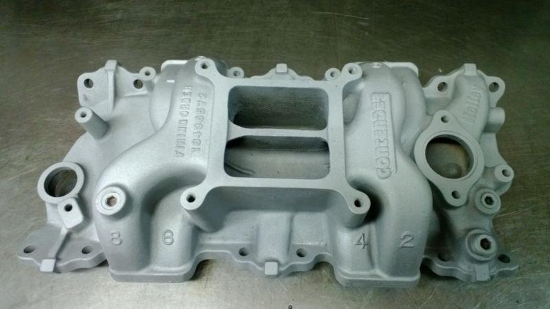

  15. DDDenny
    Posts: 22,609
    That is the GM factory Winters "snowflake" casting intake for the 66/67 L79's.
    Bought it new in the box in the late 80's for $200, they are now going for over $1500.
  16. Deuces
    Joined: Nov 3, 2009
    Posts: 26,856
    Deuces
  17. Deuces
    Joined: Nov 3, 2009
    Posts: 26,856
    Deuces
    I wish Winters would recast the Z/28 intake.... I know Holley has a good copy.... That was also cast by Winters... I forgot the name of that intake...???....:oops:
