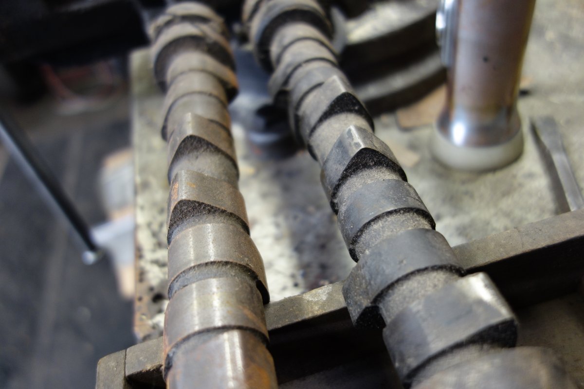

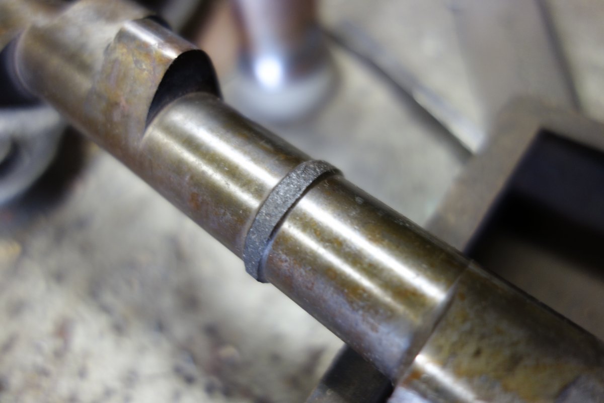

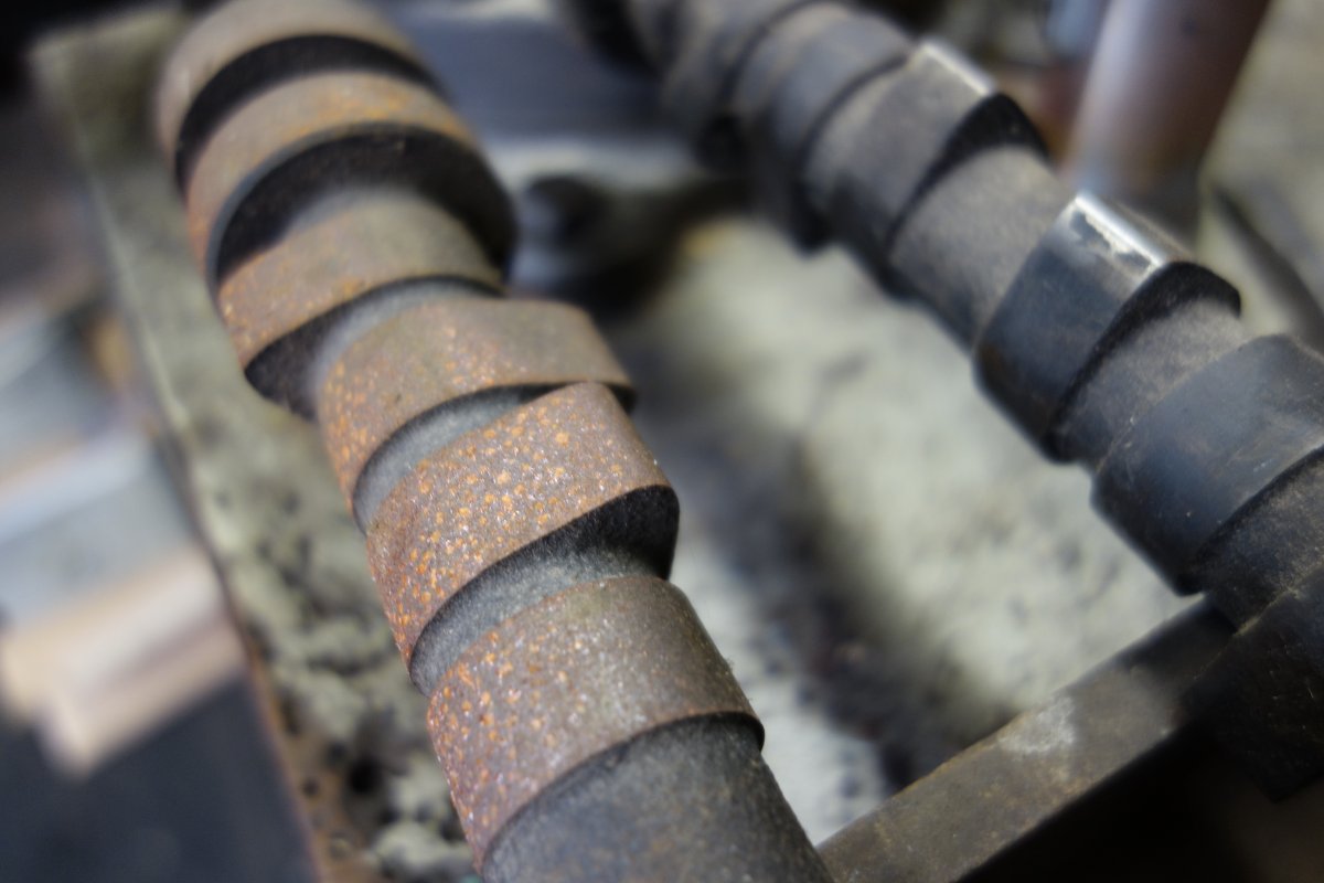

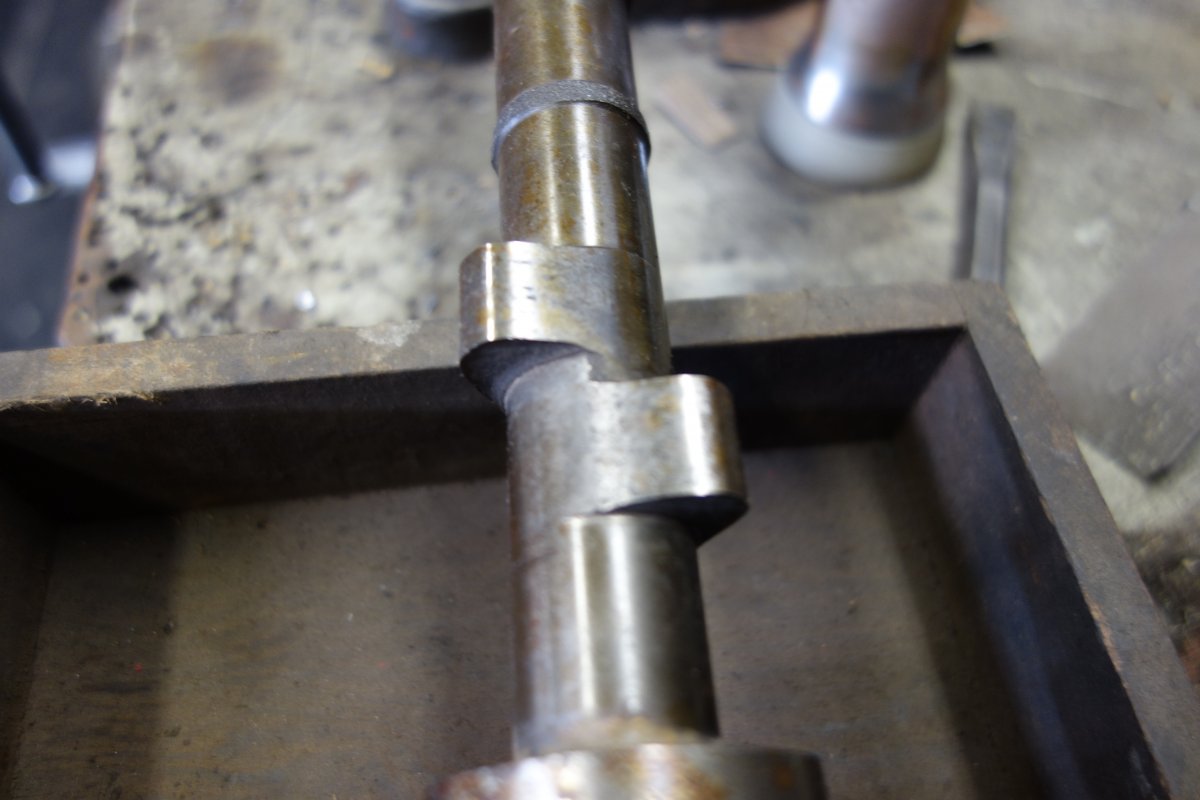

    I was going to reply to this earlier but I didn't make it to the shop until today to get a few pictures of these flathead cams. Someone needed to put some pictures up, so I figured, what the heck. The one cam you can easily see, is a re-grind and, from what Dad told me, it came out of an old hopped up flathead that was in a hotrod he rebuilt for a friend. It also had a 3x2 setup and a mag. The story goes that it was a really strong runner back in the day but the guy didn't want to spend the money to go through it. He wanted a modern engine and trans in it instead. He ended up just giving the engine to Dad.
    The stock cams both have rather pointy lobes. They are for comparison.
    I'm guessing that the regrind didn't get any spray welding from the looks of it. Someone ground the holy **** out of it. Lots more duration! _DSC5322.JPG _DSC5323.JPG _DSC5324.JPG _DSC5325.JPG _DSC5326.JPG _DSC5327.JPG

    Is it just me ? Mind you I have no idea which end I'm looking at on these cam's. Does the cam on the left (rusty one) have a milder ramp (left side of lobe) as compared to the other side. [​IMG]

    RE: those flat head cams: I really couldn't tell which was the regrind from the pics mainly because they didn't drop the heel/baseline/base circle to the min diameter of the casting.

    Are you sure you saw the last four pictures I posted. The first two pictures were used stock cams for reference. the last four were of the regrind.

    zombiecar: I looked at those pics and thought they were side by side comparisons. Unless same cam and side by side, it's hard to ***ess what was ground off.

  20. Stock cams in pic top - reground cam in lower pic.
    They took all they could and then some
    zombiecat likes this.

    I never looked for it when I took the pictures. The next time I go over to the shop I will check that and let you know what I find.
    It could just be wear. Both of these are stock cams as far as I could tell. There are a couple more that looked very similar to these. I just grabbed a couple for pictures
