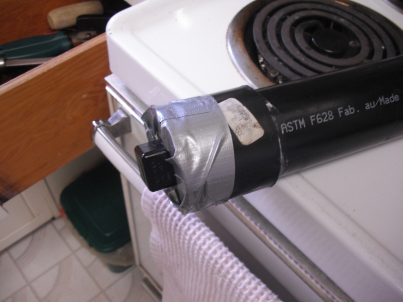

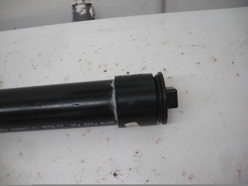

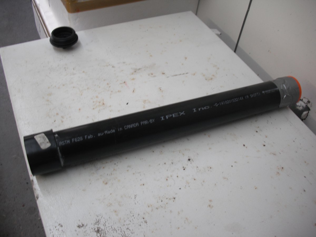

    shipping a cam in a cardboard box will result in a bent cam as well. The cam grinder can straighten it, but on a finished cam, straightening will always impart some base circle runout, which will affect idle quality, a**** other things. Pics on how I ship mine.

    Some companies have FINALLY started shipping them in those ABS boxes. Most every cam I have ever bought prior to that was tweaked. I usually take them into Shadbolts, and he straightens them for me, but they are never as good as if they didn't get bent in the first place.
