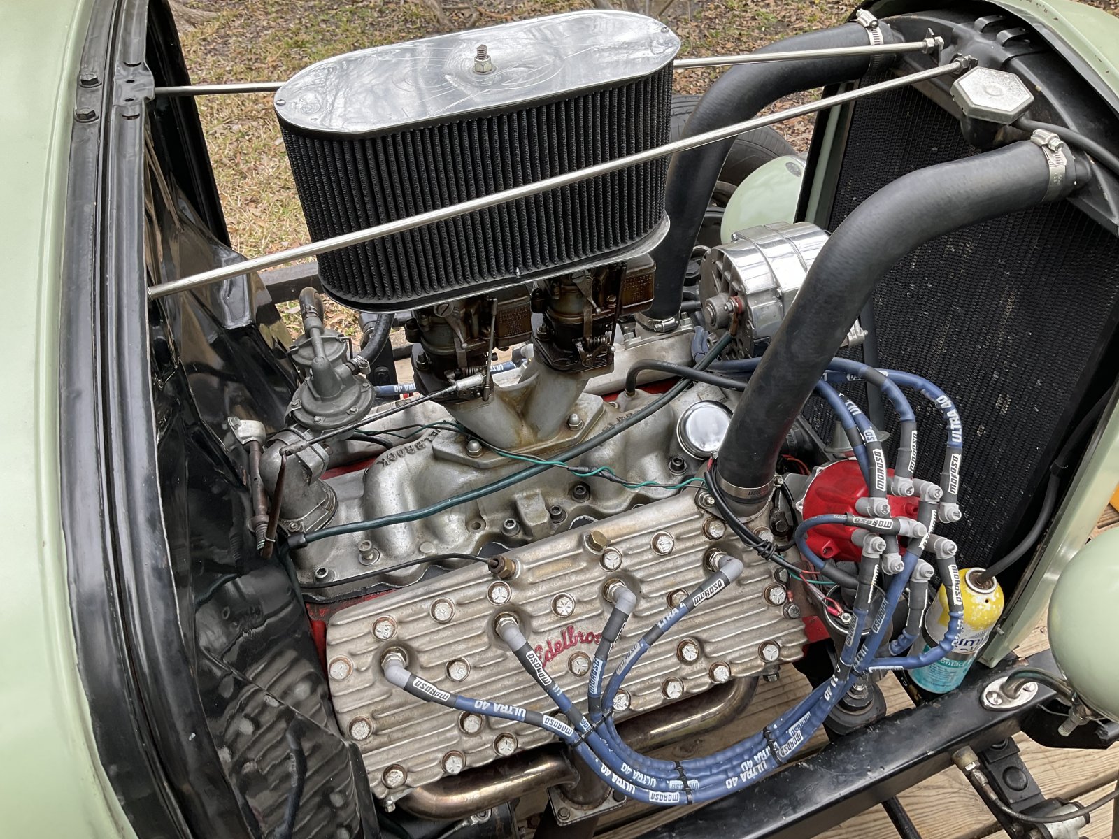

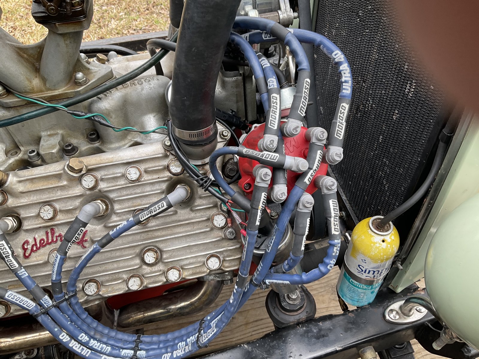

  2. Flatheadjohn47
    Joined: Aug 18, 2012
    Posts: 1,416
    Flatheadjohn47
    from Lewes, DE
