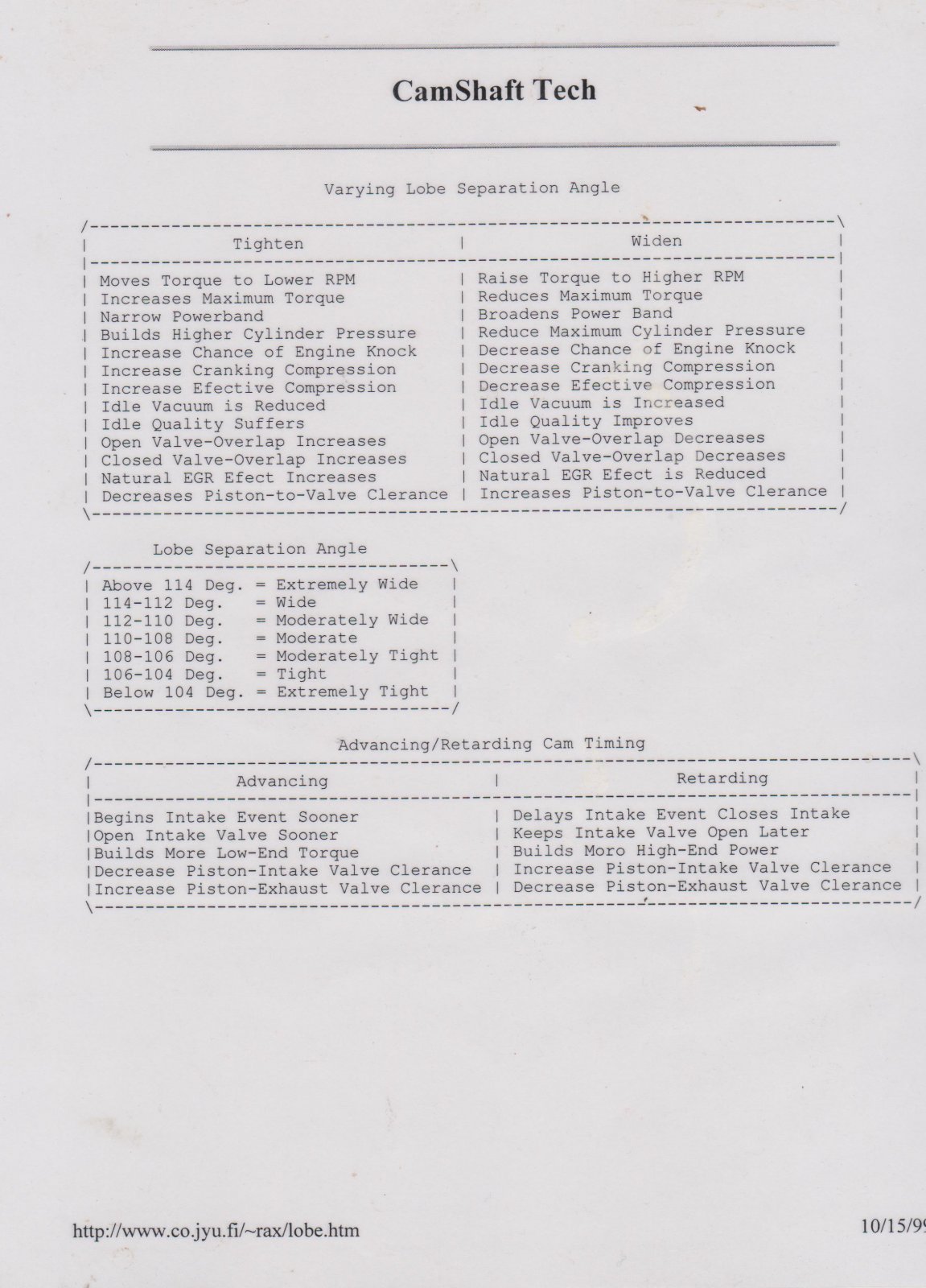

    I think one thing not brought out here is that the exhaust gases are exiting under some pressure as the piston rises on the exhaust stroke. Thats why exhaust valves can be smaller than intake valves. Its a balancing act as to when the intake can be opened without exhaust gas pushing against the incoming air that only has atmospheric pressure pushing it.
    With flat tappet cams, you can increase the duration somewhat, but adding lots of lift is much more difficult because of the rubbing nature of the lifter against the lobe. Think about pushing something up a steeper ramp and how much harder it is. The friction at the point of contact increases and may ruin the cam/lifter.
    With a roller lifter you can also increase duration, BUT you can add lots more lift TOO. The nice thing about the roller is that you can JUST add LIFT and keep the same duration or only change it slightly.
    The idea of opening the valve longer (duration) is to provide more time for ingesting air. The valve is open longer.
    If you can open the valve more quickly and even more open, you accomplish the same thing. Combine the two things and you get the best of both worlds.
    Here is a general chart of what happens when you change things on a cam.

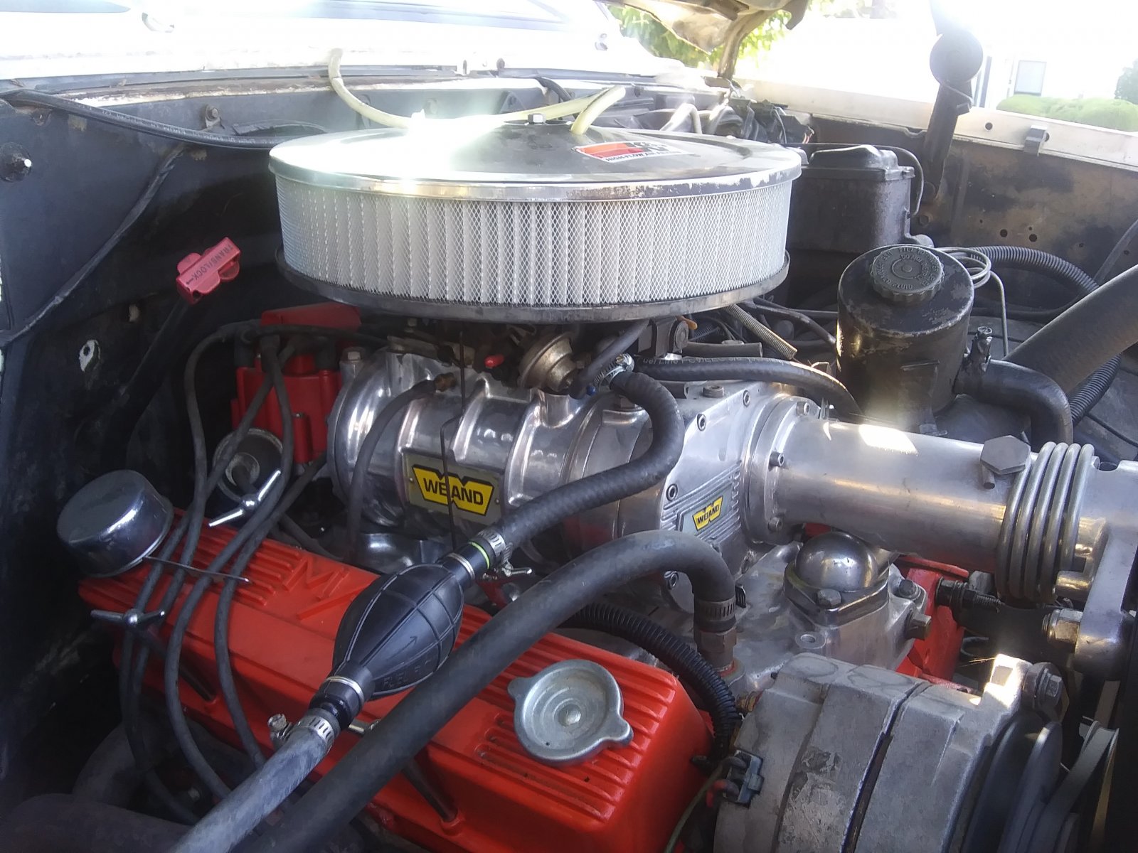

    Back in 1982, when advancing or retarding cam timing , changing dynamic compression, was done using offset dowels (I understand they have hex adjusts and what not nowadays), I made this with my little Post Tool lathe. Bolts to the cam and gear, and allows adjustment through the top of the timing cover, even with the short water pump. It worked great, but at that time all my testing was done at the strip, and the usual variables in track temp, wind etc., and my own incompetency, made improvement testing hit and miss.
    The local machine shop/circle track engine builder was super excited about it at the time, but with no manufacturing experience and more interested in my own exploits, I never made any more than the one. Was looking for it some time ago and realized it's still on the car 30 years later! As I recall I left it fully advanced, seemed best for my combo. Bottom photo take today.
    1Nimrod, ekimneirbo, Truck64 and 4 others like this.

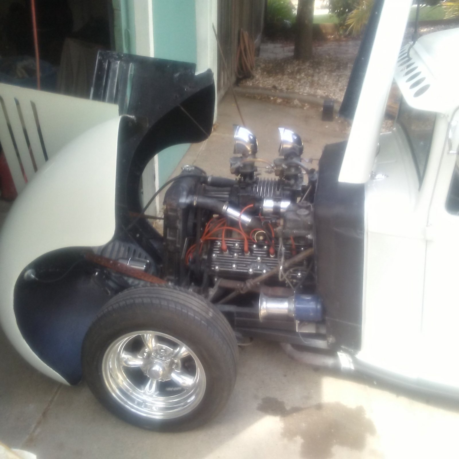

    Camshaft Duration
    Definition & Description
    Duration is how long the valve is off its seat. It is listed in degrees of crankshaft rotation. When someone refers to a "big cam," they mean it has longer duration, not higher Lift.
    Manufacturers often list 2 different duration values:
    • Advertised Duration is the degrees of crankshaft rotation that the lifter is raised more than a predetermined amount. This predetermined amount varies between manufacturers.
    • Duration at 0.050" is the degrees of crankshaft rotation between when the lifter is raised 0.050" and when it is 0.050" from its resting position. This is standard a**** all manufacturers. You should use this value to compare camshafts.
    How is it measured?
    Most Cam Cards will list duration. However, if you want to find the duration for the camshaft in your engine, you can calculate it.
    1. Using a Dial Indicator and Degree Wheel, find the opening and closing points of the valves at 0.050 in. of lift.
      1. If the intake valve opens AFTER TDC, use a negative value.
      2. If the exhaust valve closes BEFORE TDC, use a negative value.
    2. Add the numbers together.
    3. Add 180° to find duration.
    For example:
    • Intake: Opens at 7° BTDC, closes at 39° ABDC.
    • Exhaust: Opens at 51° BBDC, closes at 3° ATDC
    Intake Duration = 7° + 39° + 180° = 226°
    Exhaust Duration = 51° + 3° + 180° = 234°
    How does it affect performance?
    At high rpm, longer intake duration fills the cylinder. It also allows more exhaust to escape. This creates more power. (It is why a camshaft's RPM Range is based on its duration.)
    However, at low rpm, the open valves reduce the pumping pressure of the piston. This results in lower cylinder pressure and less low-end power.
    Long duration camshafts also create more Valve Overlap. At high rpm, this helps promote the Scavenging Effect. But at low rpm, it also contributes to Exhaust Reversion.

    Probly didn't want anyone messing with their R&D on their stock engines. I've seen ads for newer cars with variable valve timing, on the fly. Changing mine with offset ****ons several times, and only the strip the following week to test, I made my little gizmo where I could change it right in the staging lanes. On an engine dyno I suppose you can change it with ****ons quickly enough to easily retest. Or use the gizmos Cloyes and whomever sell. I haven't raced other than bracket in many years, life's priorities change.. If anyone wants to talk about Cadillacs 4-6-8 valve system, I adapted that to a 327 years ago too. Figured if it was good enough for Caadillac.. :eek:
